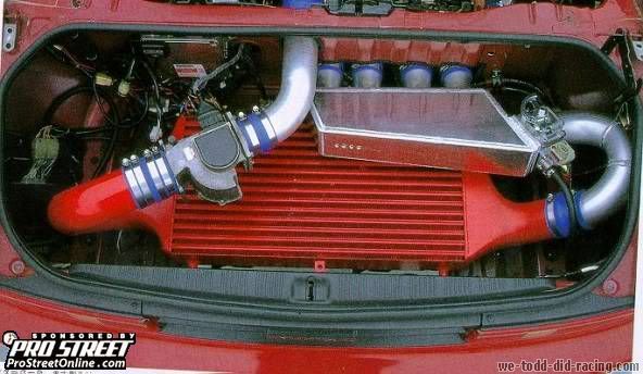

    Quote Originally Posted by Trance4c
    No.. very cool! I will put mine up, but I'm unhappy with it being routed next to the hot side. I have some lab work to do...
    But this is awesome, I wonder what your lag time though is like.. what is the diameter of the intake pipe off the IC? post ic that is, into the throttle body. Looks a lot bigger than the U bend off of the compressor. I've seen your times though.. looking nice.. fimiliar IC brackets too hahahahaa... interested in the flow dymanic here.. I wonder what would happen if you put your AFM right in front of the TB...
    You cant put the AFM next to the throttle body. It wouldnt read right. The positive pressure would fuck up its readings...

    Quote Originally Posted by Luni
    Positive pressure?
    Stop talking like you know what your talking about MR2 boy :lolhittin
    Its been done.. and runs. I have pics and the 1/4 mile slip of the setup like that.. that proof enough?
    Positive pressure?
    I want to see this.
    It will work, but it wont work right.
    The flapper would still work but the data would be false. The problem is the flapper measures air flow as in liters or cubic feet. But the fuel mixture must be metered based on mass, as in pounds or grams.
    So when it measures a cu ft of air, it assumes that CF is at atmospheric pressure, and weighs .075 lbs. If you move it downstream into the post-turbo area, at 1 bar, a CF now weighs .150 lbs.
    At 1 bar, the engine is using twice as much air mass, but the AFM is still reading the same flow rate as if you were not boosting.
    If the engine is using 36 lbs/min (250 CFM @ 1 bar) , but the ECU only send enough fuel for 18 lbs/min (250 CFM @ 0 boost), your in big trouble.
    The AFM is calibrated to read volume flow rates at atmospheric, and the ECU converts that to a mass flow rate based on the standard mass at atmoshperic pressure
    The AFM measures "cubic feet per minute"
    The ECU needs to know "pounds per minute"
    The AFM can't tell the difference between a cubic foot at atmospheric (.075 pounds) and a cubic foot at 1 bar boost (.15 lbs.) But a cubic foot of air a 1 bar weighs twice as much as a cubic foot at atmospheric.
    If the AFM says "we're flowing 250 CFM", then the ECU will send fuel for only 250 X .075, or ~ 18 pounds of air per minute. But if that 250 CFM is at one bar boost, then its really 36 pounds of air per minute.
    Pretty big problem if you ask me.
    This has been tried and discussed by the MR2 community and it didnt work right. The AFM reads atmospheric pressure and a gen2 isnt a speed density system. It could cause you to run dangerously lean. And when you run dangerously lean, your ECU advances ignition timing and without any correction your engine goes boom. I know what Im talking about. Ive prolly read more about it than you have. I dont really care that youve seen it "work". The engine will definately run. Id be more interested in seeing a dynograph showing the a/f ratios across the band and this actually working without the use of blackboxes for corrections. If you can show me something to refute my claim Ill give you your internet victory. But if not, youre wrong and the physics are against you upfront.

    And hes using no corrections or black boxes? This theoretically should not work. Again theoretically I say because its speculation cause it just isnt done, but the logic is still all there.
    Id like to contact him and talk to him about it.
    Do you know who he is over there? Could you get him to drop me a line at admin@celicatech.com or come post in here. Im genuinely interested in this.
    Sorry I came across as a dick or knowitall but based on the theory of the AFM it just shouldnt work. It isnt a speed density system, his a/f numbers should be all fucked up and he should be running lean.
    haha.. shut up luni.. I'm a dick to.. thats how I ment it to come across and so did you so shut up foo haha
    As for the rest.. I read it like I do most of the board these days... I don't, sorry. All I know is, it works.. it runs and apparently there is 'proof'. People are always squaking about dyno runs and seeing sheets etc etc.. well there is some 'concrete' evidence. Don't like it.. look else where or ignore it. As for 'theoretics', thats just a fancy word for bench racing on a messageboard, rice 101. foo. I don't agree with half the crap I've seen or hear or many people take as 'common knowledge'. Half of its crap, everyone has their own perspective.. make power how you wish and go for whatever number you like, its just all in the same box.
    This is not the ONLY person running with an AFM in this setup configuration that I am aware of either. Good luck. over and out.
    Some f00 with an MR2 apparently has done it too. However I was under the impression it didnt work correctly according to the thread. Heres his setup
    Dunno.
    Honestly the only thing you would really gain by doing it if it actually worked though would be able to blow off and not have to recirculate. Thats the only thing I could think of that would be a benefit to doing such a mod.
    Dunno.
    haha.. dude... actually, this setup would REQUIRE you to vent to atmosphere. haha
    as far as i know the AFM will read find based of how it works (from what i know)...the AFM is based on air FLOW....if x amount of air crosses the flapper door then x amount of fuel needs to go...if the amf is before the turbo then it will "suck" x amount of air then push it....so if its after it will be pushed through the afm....
    This would almost work better due to the temp sensor now being after the turbo...but if its before the intercooler then it can work agasint you as the ecu takes your intake air temps as a way to adjust its fuel maps (not by much but its there).

    Malcom does NOT have any black boxes. He has said to me that he has since decided that his initial logic in using it was flawed. None the less, it seems to work well for him, and he is keeping it. He also has 100% stock fuel. His car is a damn anomoly.
    None the less, my opinion is that it doesn't matter. The afm just flaps open and calls it a day anyways. Its a damn on / off switch, pretty much. The only thing that I'd see being out in a real way is the intake temp correction. It would be way hotter, thus giving you 'worst case scenario' maps. Other than that though, it would work.

    advantages of a blow through setup (maf near TB) is that the maf measures air entering the TB. Boost leaks before the TB will not cause the car to run rich. and the ignition timing will be more accurate/more conservative because airflow and intake charge temps are measured more accurately.
    i think it's about time you stopped messing around with the damn AFM and the people that make the MAFT (maf translator) ... that way you can get an LS1/LS6/LSX MAF and a MAFT and it will bolt up to the 3sgte.
    The MAFT even has idle, mid , high adjustments and an external adjustment (nitrous, 2nd stage of boost ...etc) al in one pacakge ...
    http://www.lmperformance.com/2551/1.html
    vr4 and DSM guys use this alot...and it works great if you have the correct version of the software

    For this to work the ECU would have to actuate air/fuel ratios based on throttle position and RPM (and temperature), not just AFM and RPM - Either that or the ECU runs REALLLY lean on-boost.
    Everything luni has said is 100% correct - that is, as air density increases as pressure increases. The AIRFLOW measured by the ecu however, as it has no way of adjusting for pressure (or even detecting the presence of it) MUST detect FAR LESS air than is actually entering the system.
    It's not about "ive seen it done before's", the fact is that if this has been done before the ECU, as ChrisD has noted, MUST use throttle position as a primary actuator for fuel maps, or else the maps WOULD be (no room for discussion here, it is a plain and simple fact) waaay too lean.
    This however contradicts the facts that you can modify the engines based on the air-flow meter reading, because if these post-turbo AFM's do work, then this shows that the throttle position sensor is in fact used for fuel calculation and modifications of the airflow meter signal does nothing.
    Either way however, these cars under NO circumstances would run as 100% stock under a spooling turbo throttle, unless the ECU runs a single AFR from 0+ psi. With no way to measure the actual air entering the system, you could be producing 2psi@4000rpm or 25psi@4000rpm, the ECU wouldnt have a clue either way (assuming the AFM readings are totally disregarded due to their inaccuracy at pressure and the ECU is fueling based on T/P)
    So what is it? Does the ECU fuel based on throttle position primarily over the AFM signal? If so, why cant we just use resistors and discard the AFM all together? Does it only use it under open-loop? Is there something else i dont know about?
    Theoretically this shouldnt work, full stop. In practice there is something in place with the 3s-gte that is allowing it to work. I want to find out what it is.
    Elliott
    it's probably something like this:
    3sgte ecu never measures boost. It always uses airflow (before the turbo to calculate fuel).
    tps isn't really a big factor in fueling, except for detecting wot, switching in the fuel pump at full flow etc (probably)
    temp is a big deal though...
    the shitty 3sgte AFM goes to 100% flapper opening at any significant amount of airflow which dumps in a ton of fuel (typical for most 3sgtes)
    however with this setup there is 1 major difference...temperature... the ecu sees a hot temperature and now takes out alot of the fuel that it dumped in possibly making the car run better than it had before (where the flapper was 100% open at any significant boost because of the shitty afm, however it was also in a cold and thus EVEN richer fuel map)...
    i think the temp sensor is what probably saves this setup from being complete trash...
    either way...if you take trash and you move it somewhere else, it doesn't necessarily become less trashy... you take a shitty AFM and put it wherever you want... i don't think it's worth the hassle honestly.

    You would think it would also retard timing though with hotter temps, no?
    Wouldn't it ADD fuel at higher intake temperatures?
