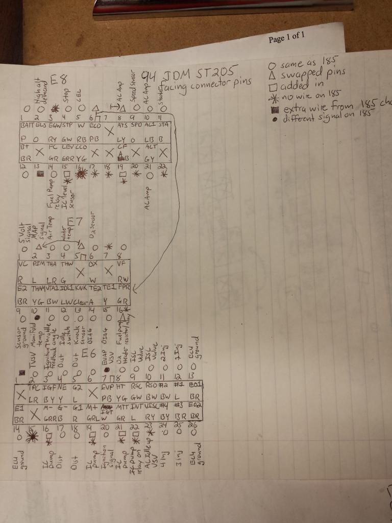

Ok, I don't have time tonite to explain stuff, but I'm sure someone can figure these out. I'll TRY to come back and explain.
First is my wiring pinouts for the harness. In case you want to ditch the Berk jumper. I have no clue why it's rotated, that's not the way it is in the album.
It's for a 94 JDM 205 into a US 93 [same as your 92].
And this is how to bypass code 54. I wired a relay in too, not sure if it's required, haven't had time to mess with it.
I also don't know how close to 1k you need to resistors to be. I doubt it has to be super accurate.
Thanks Jeremy. After you mentioned repining the plug I pulled up the pin outs for both ECU's and I see what you mean. I think I'm going to go that route now as I'll have to repin the Berk harness since it's for the MR2 ECU. It will be just as easy to repin my plugs.
Thanks a lot for posting the fix for the code 54. I wasn't even sure where to start with that. I appreciate you taking the time to post these pictures up.

Also, here's a diagram I found that decodes most of the 205 pins. Thought this might be of help to someone doing something similar.

Yeah Mike, you just need to ground the LEV pin, I completely forgot to mention that. Sorry.
Same thing for the RC, FYI.
I just used the stud the ECU bolts to. Nice and easy.
