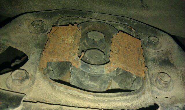

    For some strange reason I decided to look at all my mounts and bushings yesterday(since I never had before) and this is what I found
    Looks like someone didnt feel like replacing this when they needed too.
    Would this cause any unseen damages?

    The welded mount you have shouldn't cause any damage to your car and may have actually provided better traction to the ground during takeoffs.
    Gt4 racing is on a exchange basis and I didn't think they would want this nasty welded up thing.
    Ill try to PM Klue and see how much he charges... Thanks for the reply
    I've got the solid aluminum one on mine. You get a little noise due to no insulation between the diff and the rest of the car but it works great and you don't have to worry about the rubber going bad again. I'd highly recommend it.

    You'll also get new bushings, my mount looked okay but my bushings were pretty squishy.
    1992 GT-S // 1991 GTFour RC // 2007 Jeep Grand Cherokee CRD
    The bushings on my car are pretty much on the way out, pieces have already began to fall off and they are cracked and squishy....So new bushings is in the plan.
    I'm sure the aluminum mount cant be much worse then the whole thing welded in place. It transfers alot of noise too.

    Lastly, the window-weld may look ugly, but it will do it's job for a long, long time. I would say just save your cash and replace the other things that are in need.

    He still sells them on at.net, I ordered the rear diff kit and never had any problems with him. If nothing else though you could probably fill your main subframe bushings the same way the people fill their motor mounts, that combined with the welded diff mount would probably give you nearly the same thing.
    Yeah I was debating that. Make a solid plate and weld it to one side then fill up the other side with pu or something.
