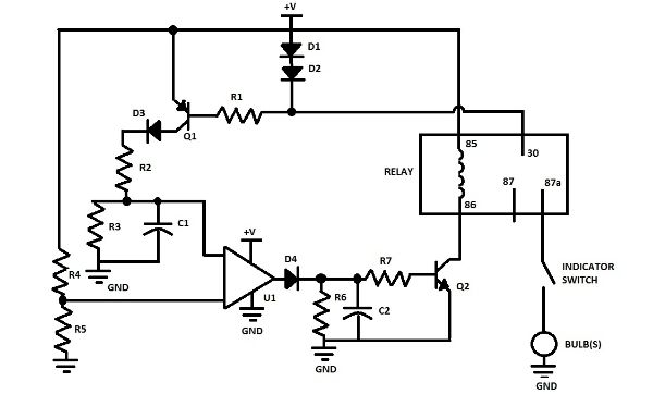

    It was in trying to figure out this solution that I came up with my solution to the flasher unit. Here is my final circuit diagram:
    Here is the circuit broken down:
    +V is the hot in run from the fuse. It is usually twelve to fourteen volts. GND is chassis ground.
    The relay is a standard Bosch style five pin automotive relay. The coil contacts are 85 and 86. When one of these are connected to ground and the other to a voltage source this activates the relay. Pin 30 is the common connection. Pin 87 is the normally open connection. When the relay is not active it is not connected to anything internally. When the relay is active Pin 30 and Pin 87 are connected. Pin 87a is the normally closed pin. When the relay is not active this is connected to Pin 30. When the relay is active this isn’t connected to anything internally. In this circuit pin 30 is connected to +V through D1 and D2, pin 87a is connected to the turn signal indicator switch, Pin 87 is left open, pin 85 is connected to +V and pin 86 is connected to the collector of Q2.
    The two diodes D1 and D2 are just there to prevent the base of Q1 from being connected to +V all the time.
    Q1 is a PNP transistor switch. The emitter (the part with the arrow) is connected to +V. The base is connected to R1 and the collector is connected to R2. When the base “sees” ground it turns on the transistor switch and +V gets through to R2. When there is no ground at the base the transistor switch is open and R2 is disconnected from +V.
    R2, R3, and C1 make up an RC charging/discharging circuit. When Q1 is on, C1 charges through R2. When Q1 is off and the voltage on C1 is greater than zero, it discharges through R3. Internet search RC Charging circuit if you want to know about this. D3 is just to insure that C1 doesn’t discharge through Q1.
    R4 and R5 make a voltage divider circuit. The voltage between the two can be calculated as:
    Vout=(+V*R5)/(R4+R5)
    In this case Vout is the reference voltage for the next bit.
    U1 is an op amp configured as a voltage comparator. The input voltage goes to the “+” pin. The reference voltage goes to the “-“ pin. There are two more inputs and they are Vcc+ and Vcc-. The way this works is that it compares the input voltage to the reference voltage and outputs ~Vcc+ (if the input voltage is greater than the reference) or ~Vcc- (if the input voltage is lower than the reference voltage). The output is generally about one volt less than Vcc+ and one volt more than Vcc-. In this case Vcc+ is +V and Vcc- is ground.
    The diode D4 is in place only to ensure that the second RC circuit does not discharged into the output of the op amp.
    C2 and R6 make an RC discharge circuit. This time there is no resistor to charge through so the capacitor charges very quickly.
    R7 and Q2 form an NPN switch. The base of Q2 is connected to R7, the collector is connected to pin 86 of the relay, and the emitter is connected to ground. Unlike the PNP switch, this one goes active when the base “sees” +V. So when the base sees +V, the transistor is switch on connecting the collector to ground through the emitter and activates the relay.
    Put it all together and this is what it does:
    When the car is on +V is at twelve to fourteen volts. When the indicator switch is put in either the left or right position the base of Q1 “sees” ground through the load (bulbs) and turns on. This charges C1 through R2. Once the voltage on the positive pin of C1 is greater than the reference voltage on the comparator, the comparator’s output swings to +V. This charges C2 very quickly and turns on Q2. This turns on the relay and removes +V from the indicator switch turning off the lights. With the base of Q1 no longer connected to ground (through the load) it turns off and C1 discharges through R3. At the same time C2 discharges through R6. Once the voltage at the positive pin of C2 is low enough it turns off Q2 which in turn turns off the relay. This reconnects pins 30 and 87a on the relay, and if the indicator switch is still on it starts all over again.

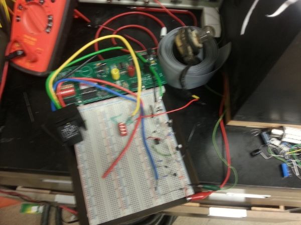

    Here is a picture of the proof of concept on a bread board:
