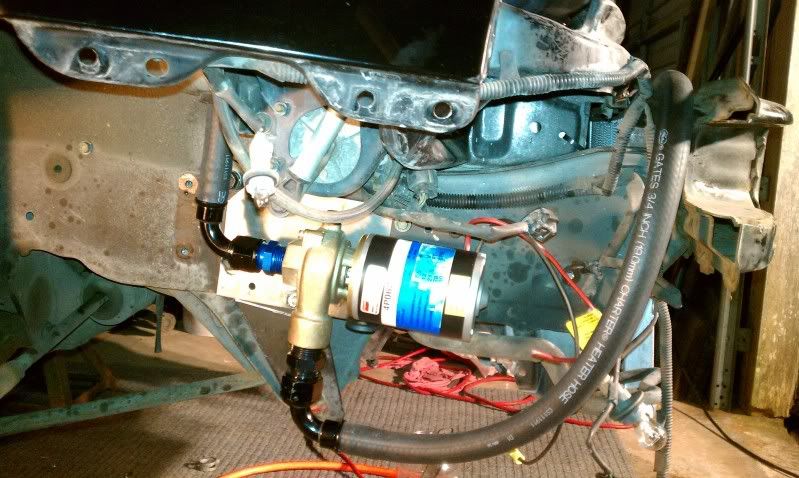

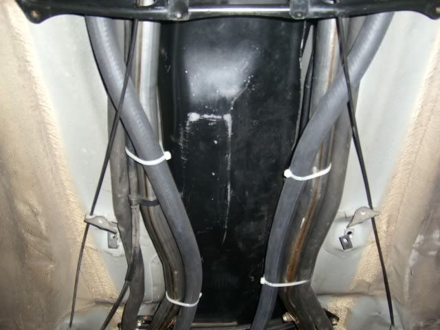

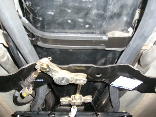

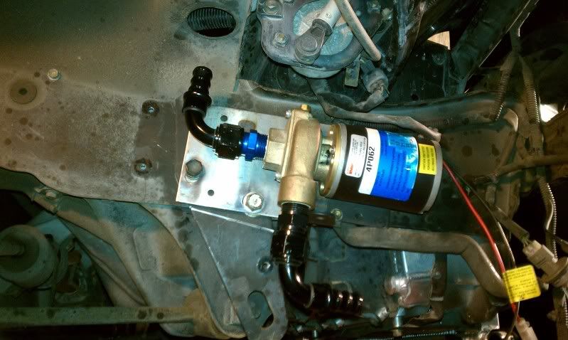

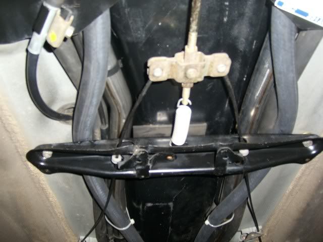

    A2W install continued....
    Mounted the pump where the washer fluid reservoir used to be. Gives me a perfect path to both the reservoir in the frunk and the heat exchanger.
    Running two 3/4" hoses to the back without crimping them is a challenge.

    Yeah, I've been looking at injectors lately (since my oldshool fatbody precisions have been acting up). The new small body injectors are crazy good; a lot more efficient/better spray patterns. Good stuff.
    BTW, how are you shielding the hoses coming from the heat exchanger? In that pic they appear to be in danger of being annihilated by the turbo/downpipe

    They are actually on the cold side of the turbo and I am running a top mount manifold also, so it should be ok. I did already think about getting some of that fire sleeve to go on those hoses anyway.

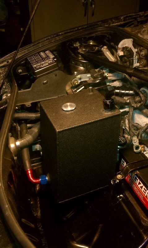

    Relocated the fuse box from the engine bay to inside the left quarter panel in the trunk.
