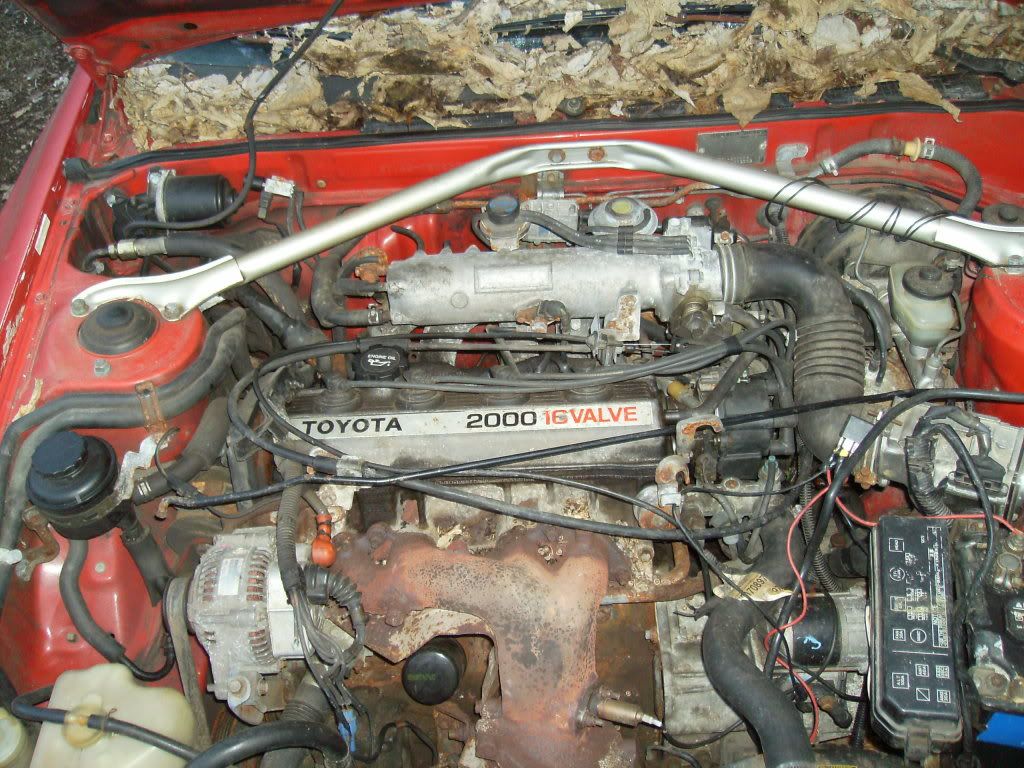

    Here is the 88 Vert, I know she looks a little forlorn sitting there like that, but she hasn't been sitting there long, and the interior is nice.
    The old 3SFE isn't that nice though. The wiring is decrepit, and everthing is rusty, I'll be glad to her out of there.

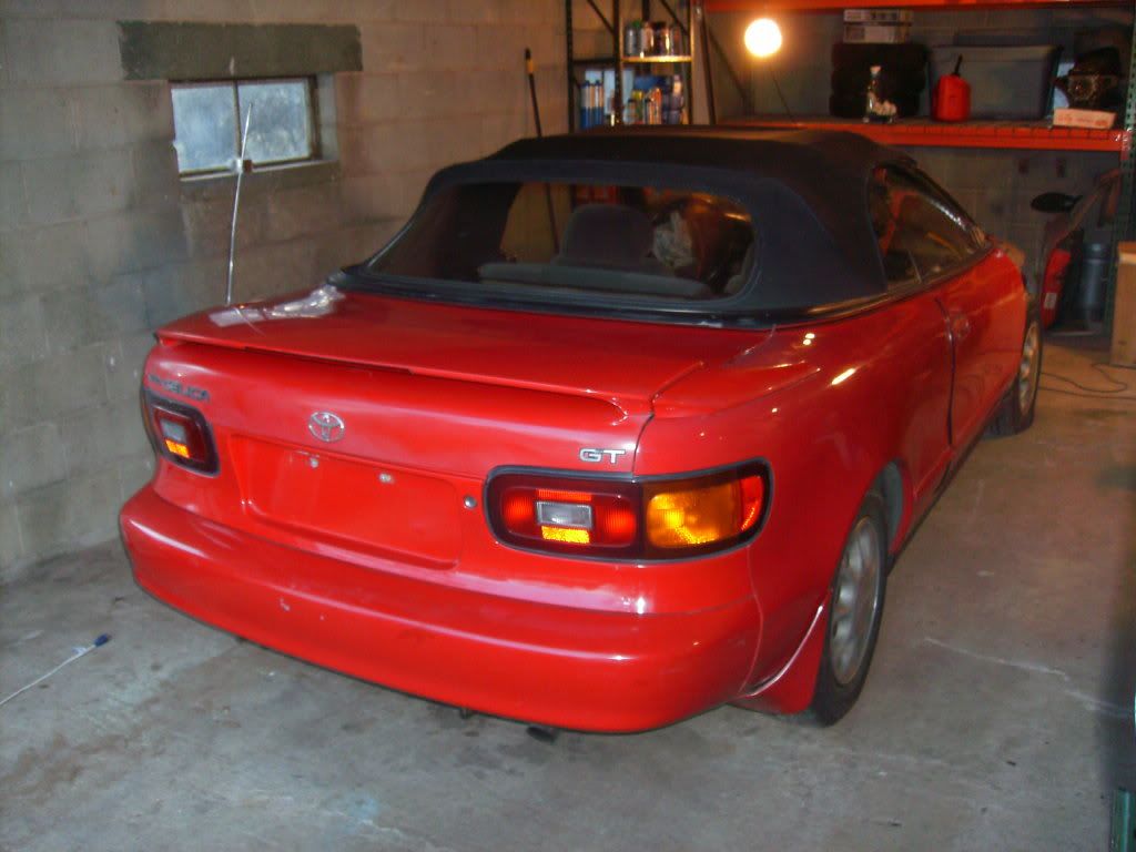

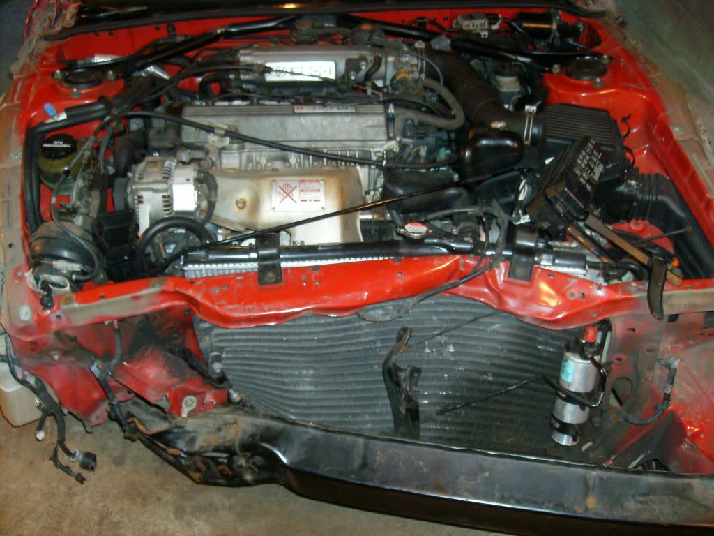

    Here is the donor.
    And the nice-clean 5S and Trans, waiting to come out.
    Sort of a shame, the top is nice, interior clean and the paint is shiny. But yeah, she's a goner.

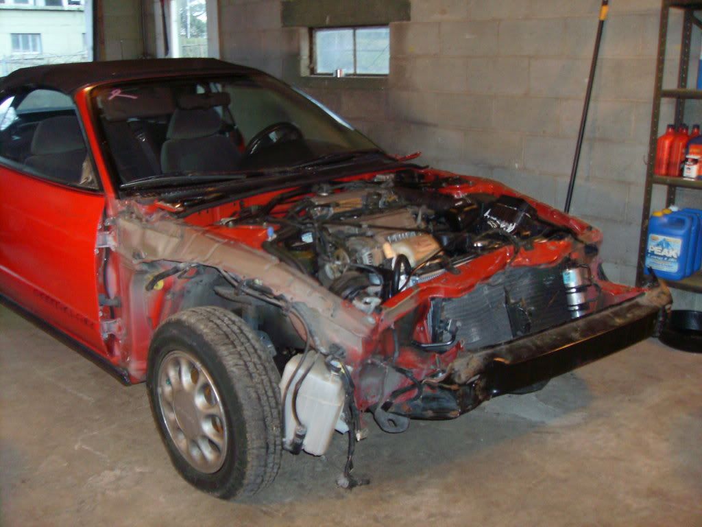

    I got the donor 5th gen lifted up on jacks and stands to where I feel comfortable, and I charged up a spare battery.
    Just for giggles, I hooked up the battery, cranked the key, and after a major front end collision, and a year sitting in a garage, she started right up on like the 3rd crank. Kinda a shame.
    On the plus side, the convertible top still works just fine, so I'll be able to try to retrofit the pump onto the 4th gen. The impeller is worn out on the 4th gen, so it will be nice to have a power top again.

    I tested the compression tonight.
    Engine was cold of course, I can't run it with the front end smashed like it is.
    It's also been sitting for a while.
    On the first run I got from left to right: 90-140-110-160 (Psi).
    That seemed a bit alarming so I re-ran the test immediatly.
    The second run I got 150-155-145-160.
    I wish I could warm her up and give it another shot, but i'm sure I would lose a coolant line or have one of the belts catch on somthing.
