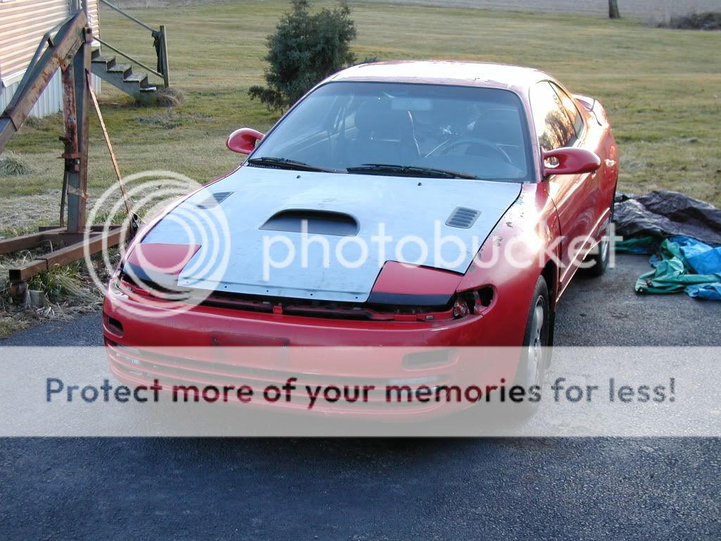

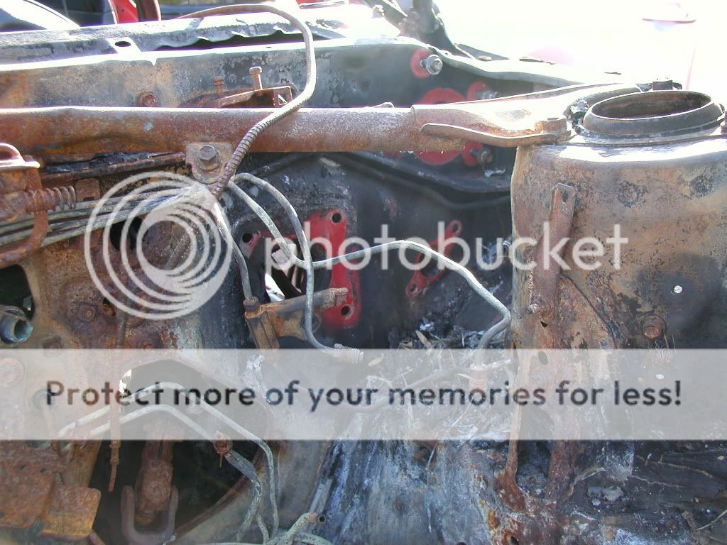

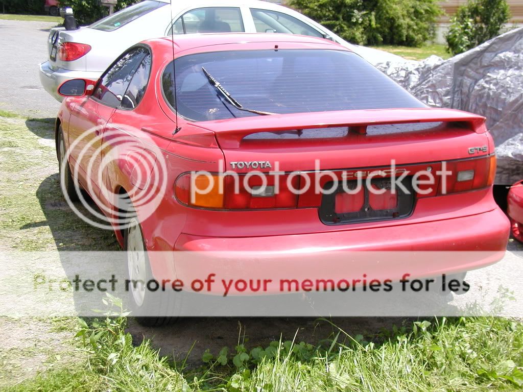

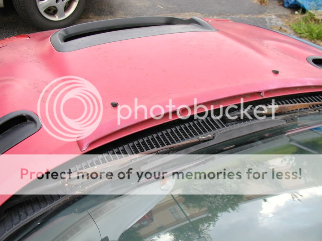

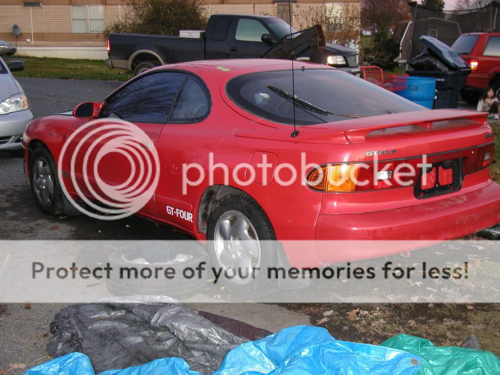

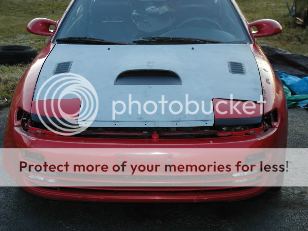

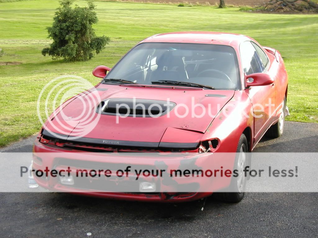

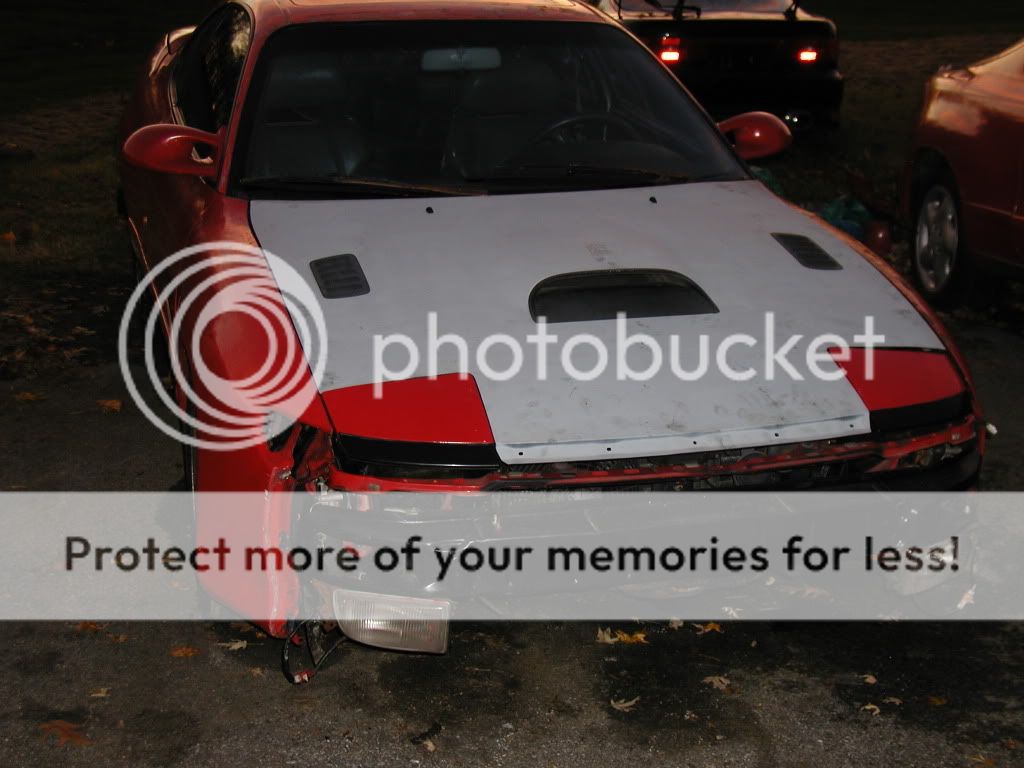

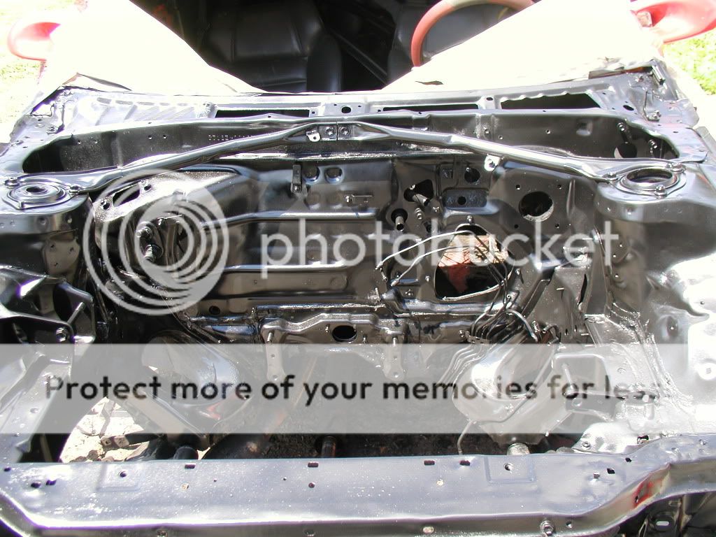

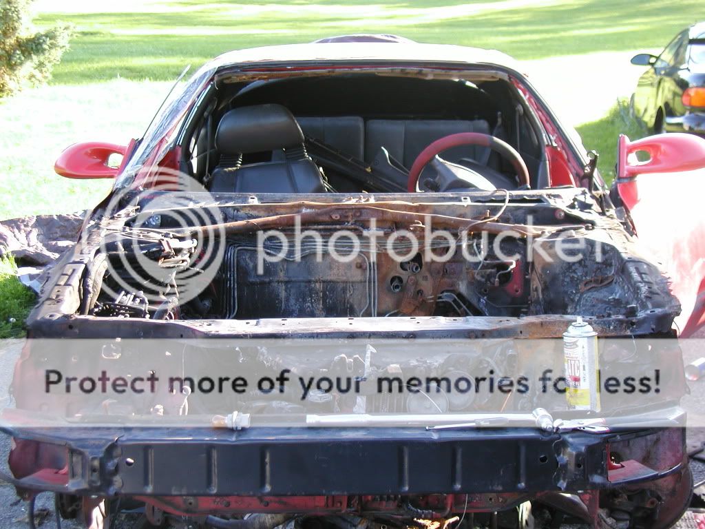

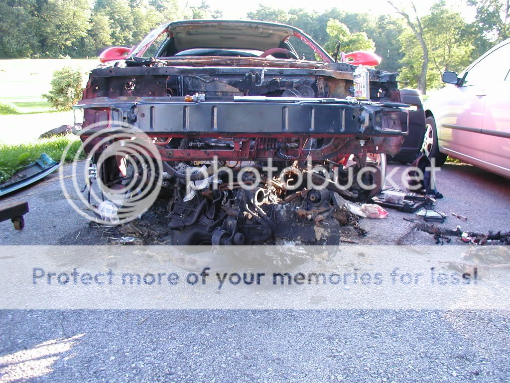

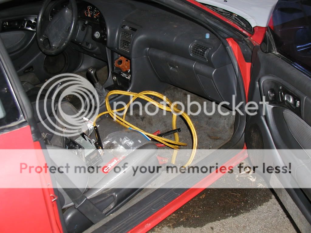

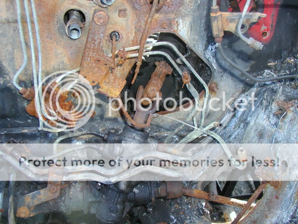

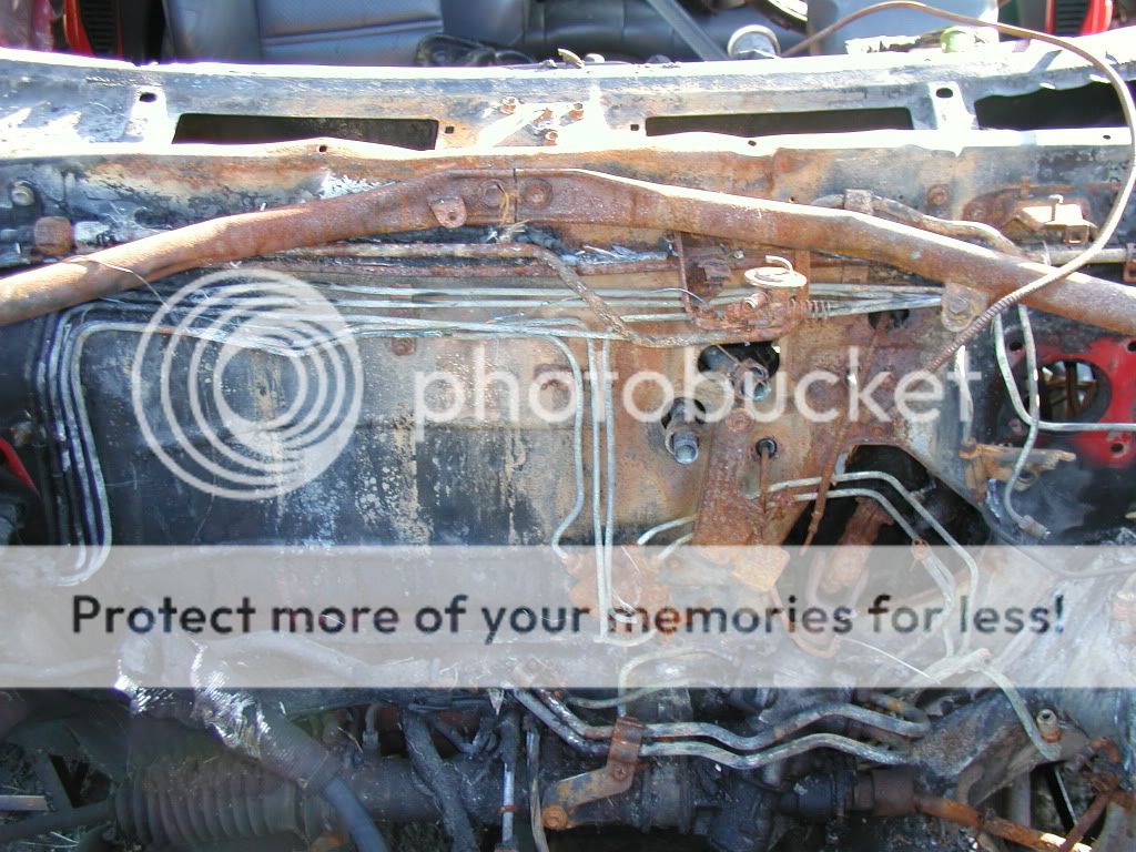

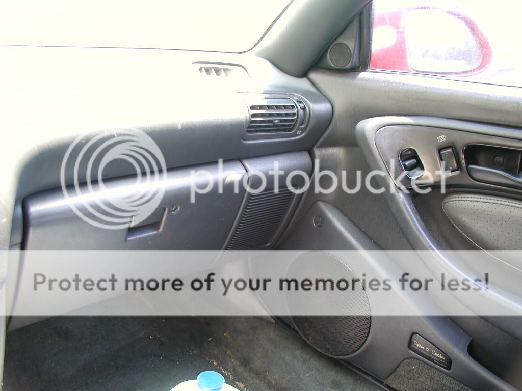

    So here is day 1 (5-23-09) of project phoenix. This car belonged to a couple of members before I purchased it. It has 109k on the clock, and now that we have the positive out of the way lets talk about it in detail shall we. The car was the victim of a very unfortunate engine fire . Before that it was a great example of a clean trac with all the extras. CS/RC Hood and Bumper very clean interior and low miles. Right now as the car sits it need everything under the hood replaced, and I do mean everything . The wiring is completely fried all of it except for the interior wiring it survived the accident. So far I have removed the dash, and I will be replacing it with a fairly new one in the morning . I have a ton of parts, but very little experience working on alltracs . It will be a huge job, but I just couldn't let this former beautiful trac just die and fade away. Some might say why not, why not just buy a fairly decent trac to start with? Well the answer is pretty simple, I enjoy a challenge and this will be my biggest project challenge by far.
    Thank you for viewing my project thread. I will update as project phoenix progresses. Please be advised!!!! The following photos are for mature audiences and may contain scenes of Alltrac violence

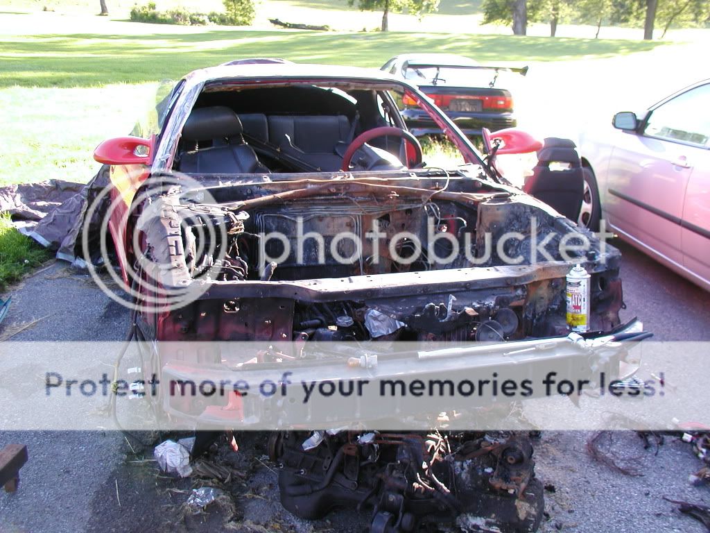

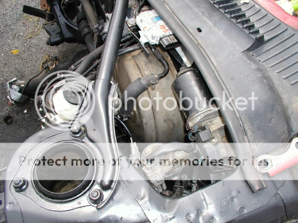

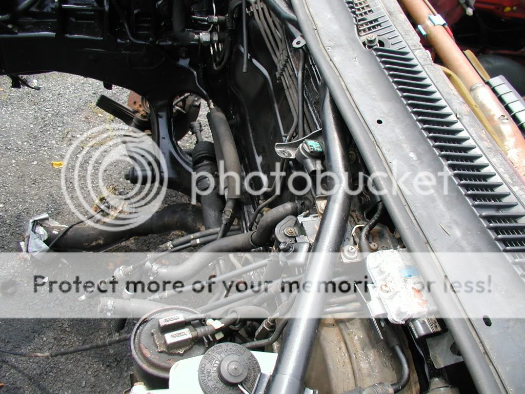

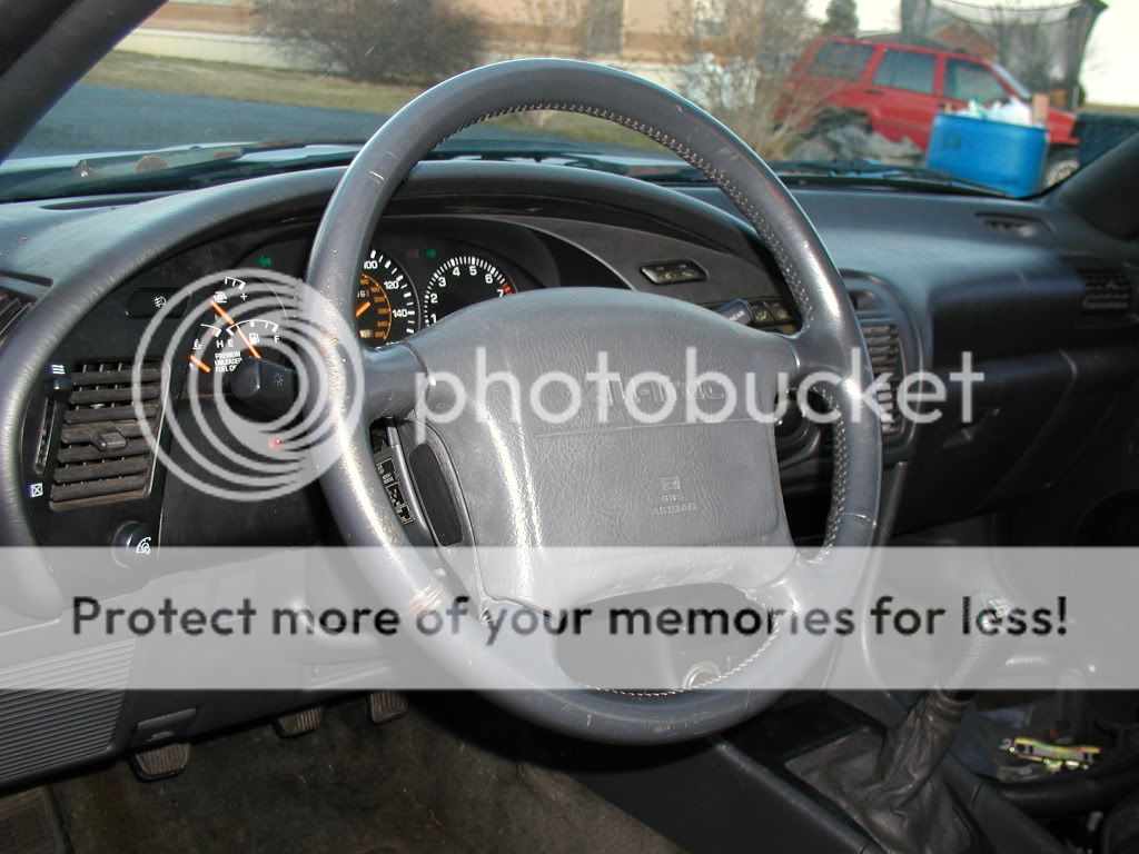

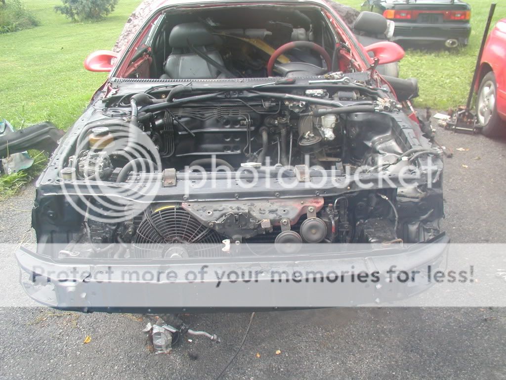

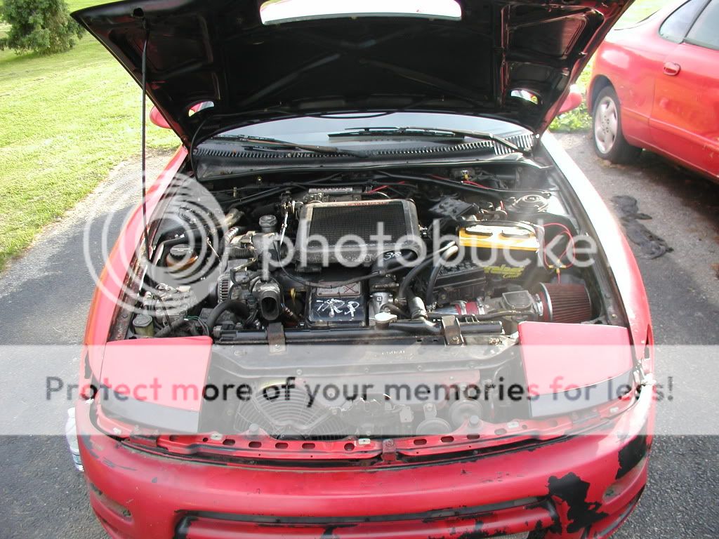

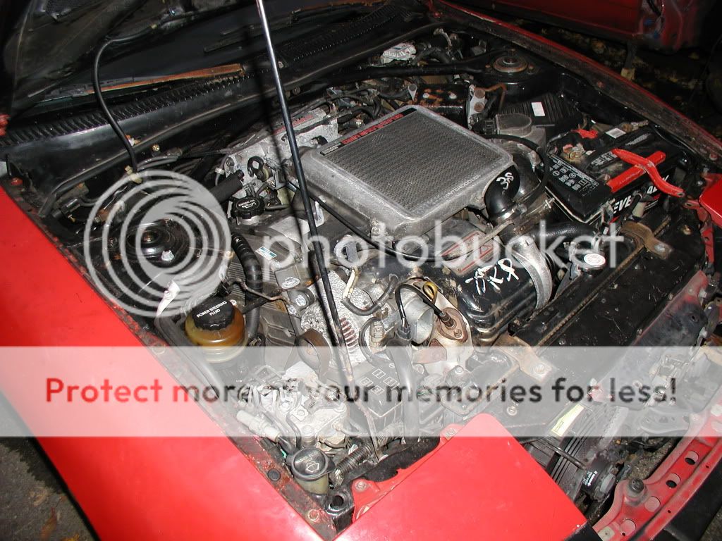

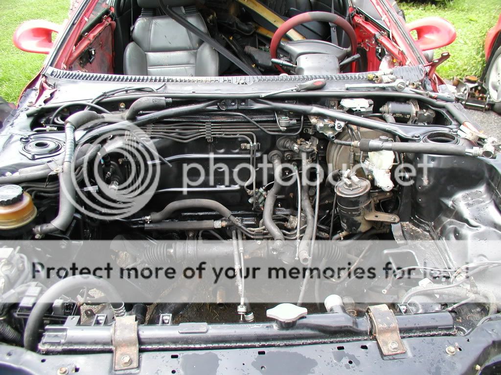

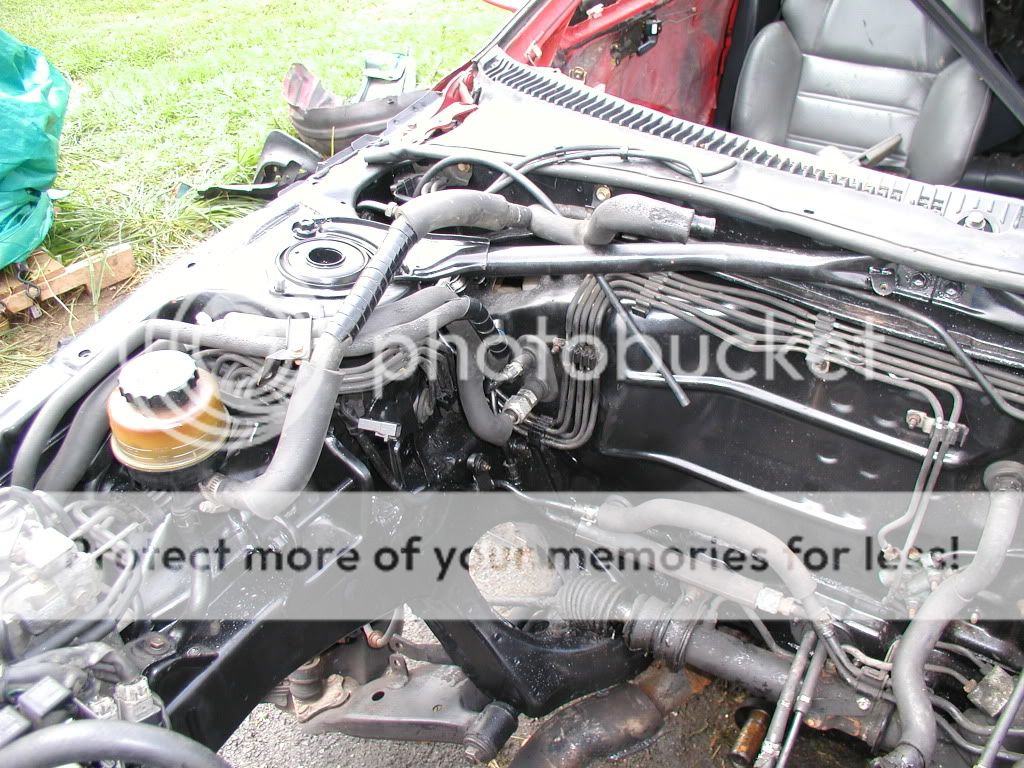

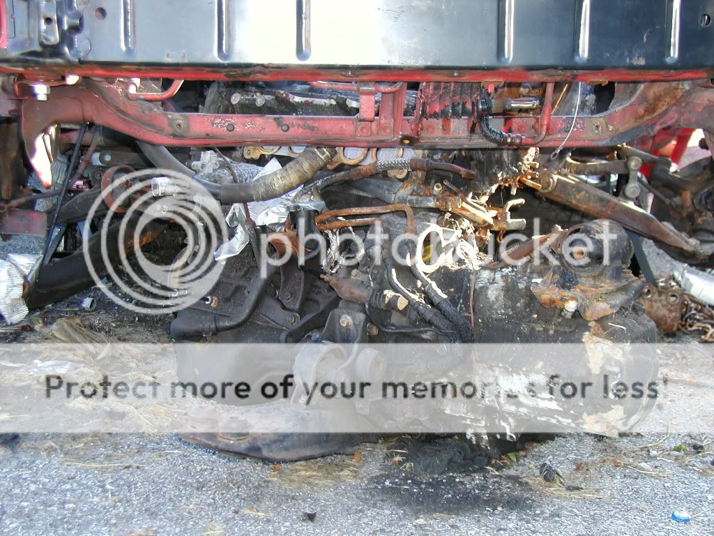

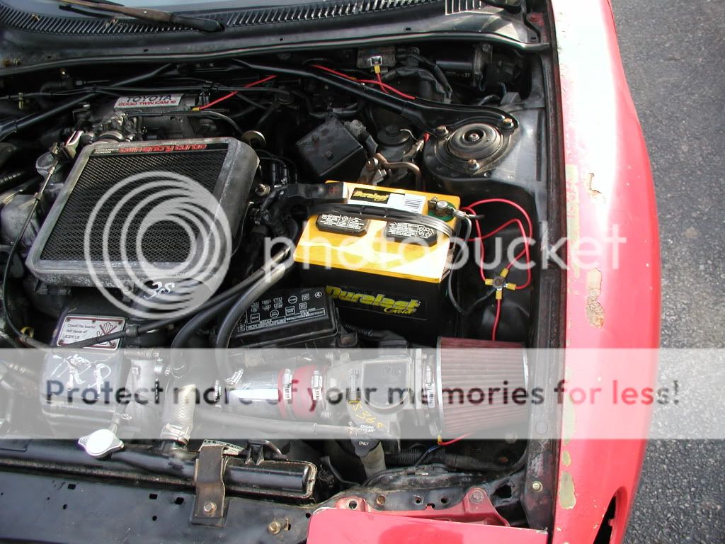

    Well its day 2 (5-24-09), and I decided to take some engine pics. This is a JDM engine not sure exactly what year . If anyone can tell from ecu pics please let me know. In the next few days I will try to gut out the engine compartment, probably will take me a little longer , but I'll get it done. I do have lots of other parts I will be posting soon. I have also decided to sandblast the entire front end, and have it repainted before I get it up and running, just seems to make more sense that way.

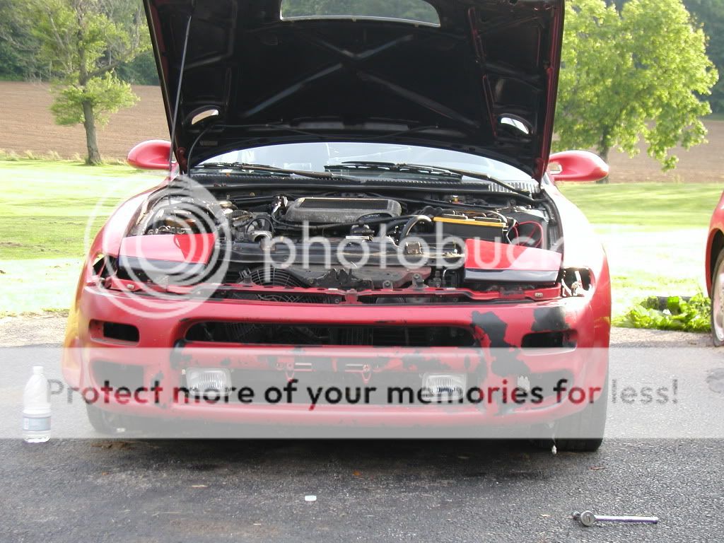

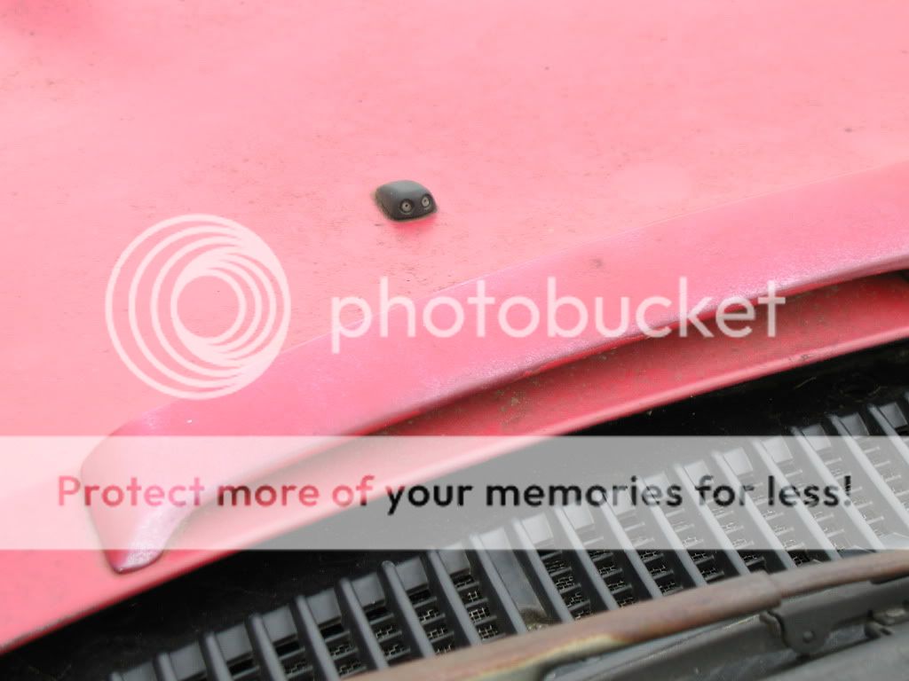

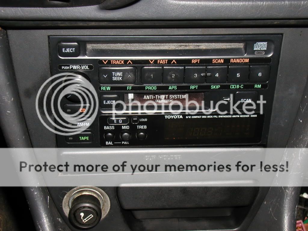

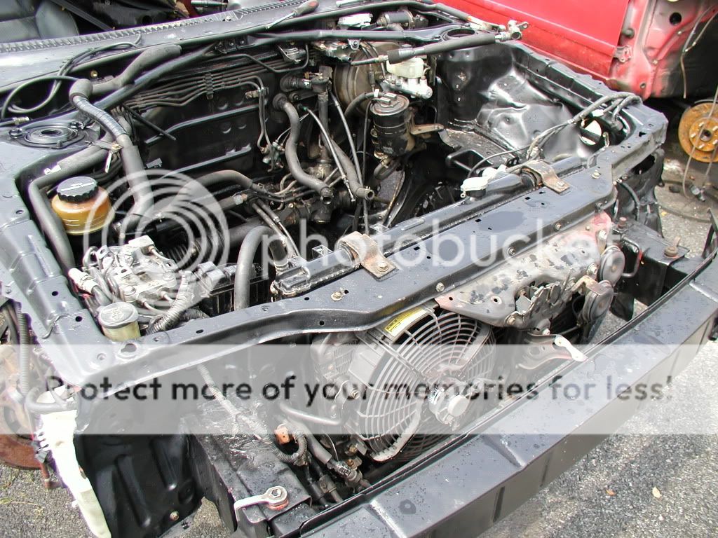

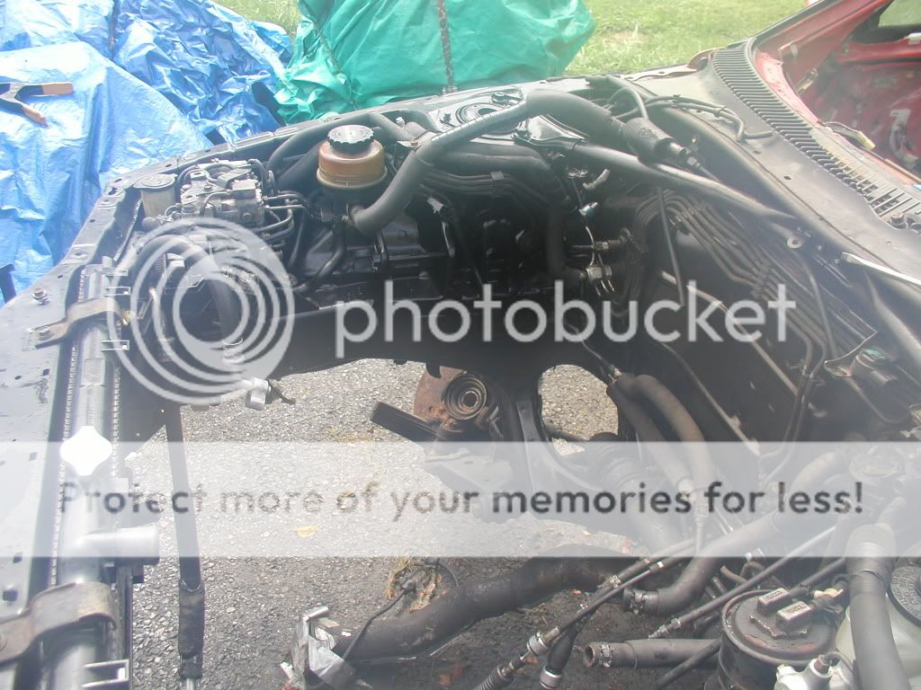

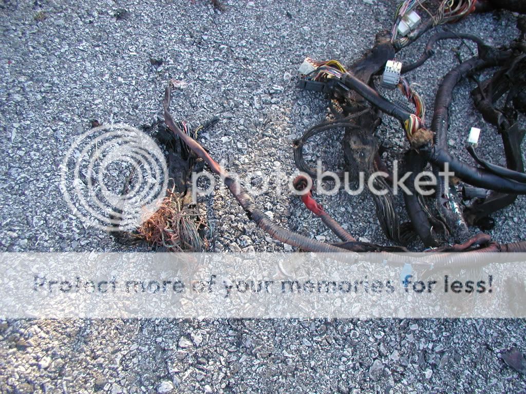

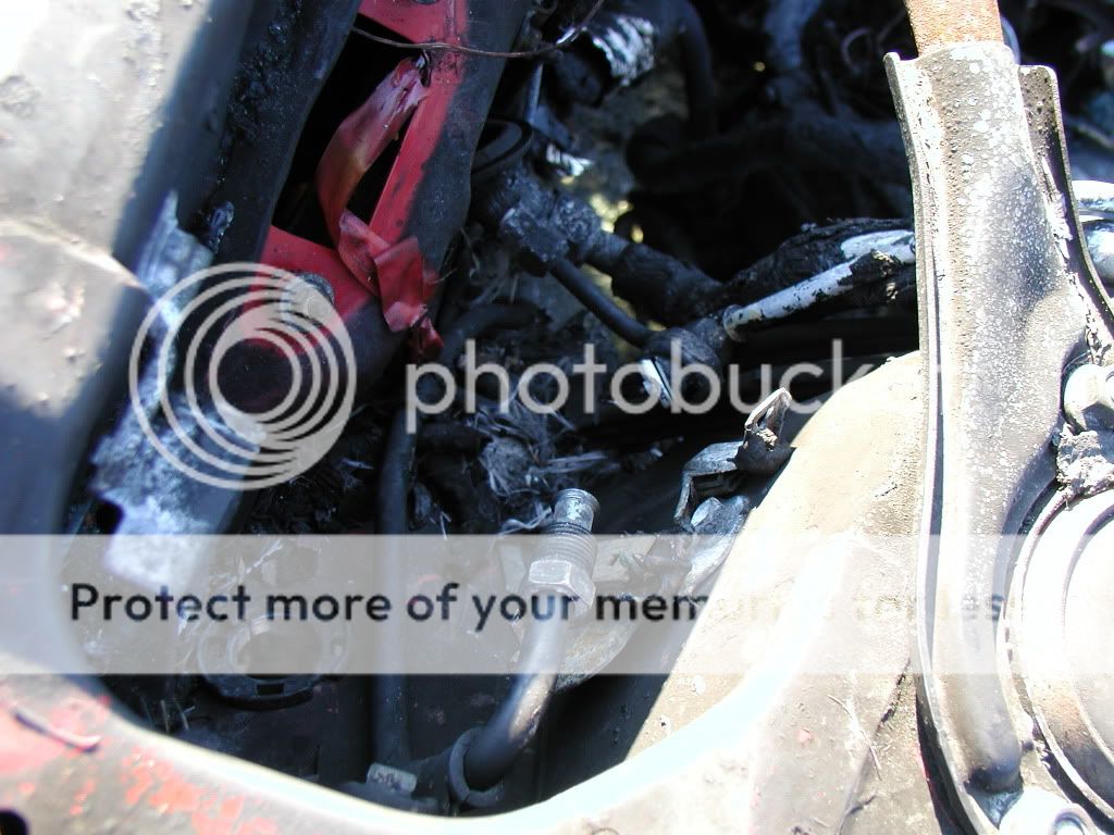

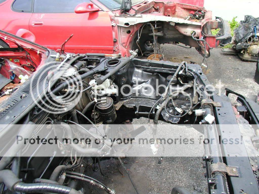

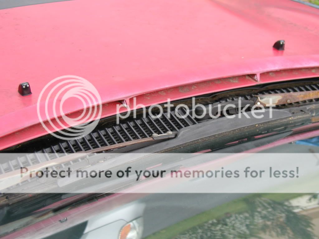

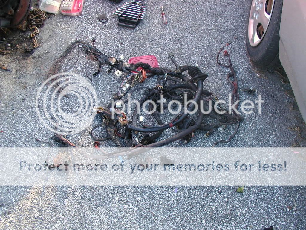

    Well it's day 3 (6-7-09) and I have removed a few more parts. I just wanted to add a few pics as I go along. Pics 4-6 are a HKS super sequential bov . Some parts are easy to recognize others are not. I'm planning on removing the engine next, I just need to buy an engine hoist.
    So its day 4 (6-21-09) and I've done a few things, since the rain let up for a day. It's been raining almost every weekend it seems , but today was nice so I put in some quality time on Project Phoenix. I started by dropping the engine, which is easier said than done. Even on my engine where I had no wiring to worry about, it still took me the better part of day 4 to get it out. First I had trouble with the passenger side engine mount. You have to have the smallest hands in the world to get the mount off . So after I realized that my sausage fingers just were not going to get in there to disconnect the mount from the engine, because of the small working area coupled with the fact that the entire top timing belt cover melted right over the bolt locations, I decided to try to drop the engine with the mount still in place. It was a little more difficult than it had to be, but my hand is grown-up size and that space is rather small . Now the shifter cables started their crap ,those clips and pins are straight from hell . I have the busted knuckles to prove it , but a small pair of pliers and a claw hammer got the job done. So the engine is out, but still under the car, I really have no place to store it, until I get a small pallet from work and another tarp I'll just leave it. Oh on a side note, I have just realized that someone has removed both the front and rear brake calipers idk why, but I will be needing them, so I'll post on parts wanted with a laundry list of other things . The rust in the engine bay is not as bad as I thought it would be, only surface rust, no pitting, but it still will need some sanding, and primer and paint to get it in decent shape. I was thinking of painting the engine bay flat black too just seeing what you guys think of that idea. So enough chatting here are some pics. Thanks for following my project guys

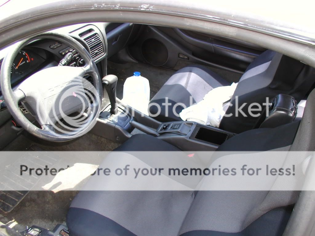

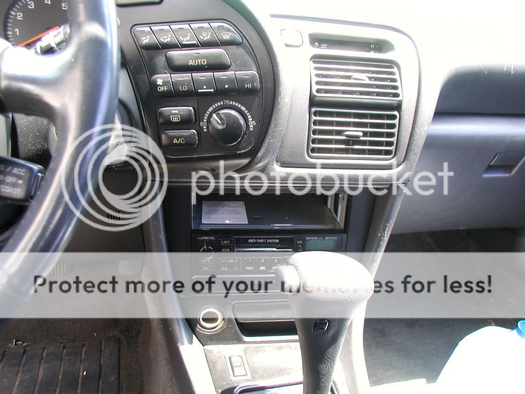

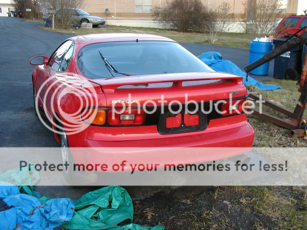

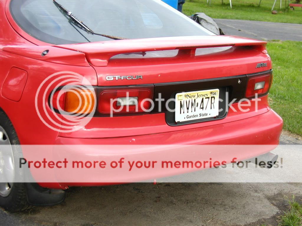

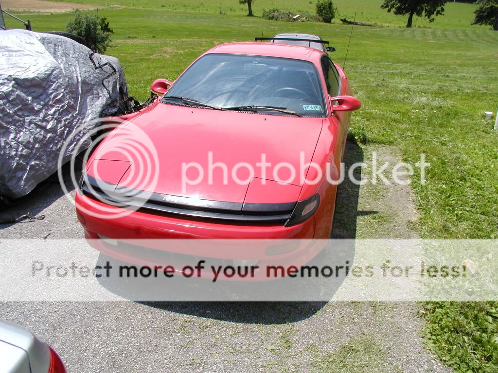

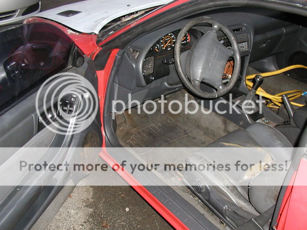

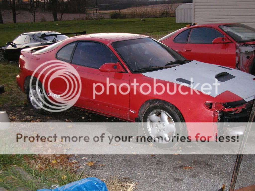

    Hey guys, I picked up my parts car today (6-28-09). It's a 90 GT-S automatic. The car has a terrible rod knock and the transmission is shot . I got a really good price on it so I can't complain too much, but I did have quite a tough time getting it back to my place. Started yesterday when I decided to go and pickup the car. My friend agreed to help by taking me there, and following behind on the way back, just in case something went wrong . It started out fine, I topped off the oil, checked the coolant level, also checked the transmission fluid level all looked up to par and ready to go. So I fired it up started a little rough with a little puff of blue smoke from the tailpipe . I though nothing of it . So we started on our way. The car shifted a little rough and while it was shifting the rod knock got loud for just a second then it went away. Ten miles later I here a pretty loud thud come from under the hood I had no idea what it was, my first guess was I ran over something, or maybe the front strut was just that bad and I hit a pothole . So we make our way to a nice covered bridge, everything is still going smoothly, until we stop at a traffic light facing a pretty steep hill . Now I'm a little concerned about that little thud I heard 2 miles back . The light turns green, and I start my way up the hill with my friend following close behind, and then all hell broke loose . The rod knock get so loud it sounded like the rod is facing the wrong way and was trying to burst through the oil pan . To make things worse it starts overheating and smoking pretty bad, but I got my buddy behind me and a long line of cars behind him, and there is no place to pull off , and to make matters worse it cuts off because it's running way too hot . Now I'm just coasting along, fighting to steer this thing down a pretty twisty stretch of road, and I finally get to an area where there is enough space to get this loud, smoking, P.O.S. off the road. After letting it cool down for around 10 minutes I checked the coolant, it looked OK, so we decided just to let it cool off for a little while longer, and try to drive it a little closer to home before it ran hot and cutoff again . So after doing this 3 more times me and my buddy decided it was getting way too late, and we would never get it back to my place at the rate we were going . Luckily 1 car passing by, now there was close to around 75-100 cars that drove past us including a state trooper , and nobody stopped, or even asked if we needed help, but luckily 1 guy stopped, and told us where we could park the car off the main road overnight, or until we could get a tow. So we took his advice and stashed the car down this little road, and this morning my local towing company delivered the car to my house . So here are some pics of my parts car. Oh before I forget, If the previous owner of the car told me that it overheated, I would have never attempted to drive it back to my place , but sadly I was not informed and had to find out the hard way

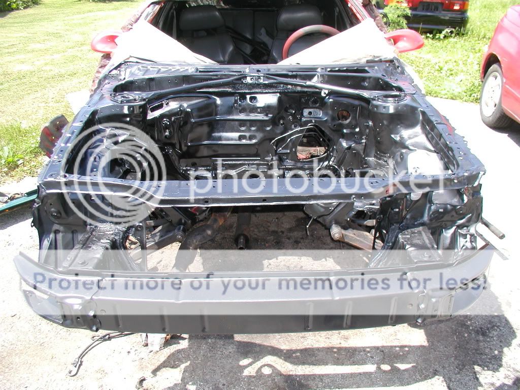

    Alright its day 5 (7-19-09), and I haven't posted any updates in a while, but I have been busy. I made my second trip out to Pittsburgh for parts. This time I picked up the throttle cable, the cruise control cable + control unit, the clutch master cylinder, the shift knob, rear view mirror, and the front and rear brake calipers with all the mounting brackets and hardware. I practically spent the day in the salvage yard getting all this , and of course it starts to rain. So it pouring and I'm almost done, I started to loosen the last bolt holding on the driver side rear brake caliper on. Did I mention this was the last bolt I had to take off, then I would be on my home . When it happens the breaker bar slips off ever so slightly, and strips the bolt head . By now I'm soaked, and the entire yard is turning into one giant muddy pit . So I'm a little upset, but I just had to suck it up to get the last bolt off. I had to get down on one knee and strip the head enough to wedge on a 13mm socket, and by wedge I mean apply with a very large hammer , the bolt is 14mm as you all know . So now my 13mm socket is trash, but the bolt finally gives up and comes off . By then the rain had stopped, and the sun made a cameo appearance for the 5 1/2hr ride home .

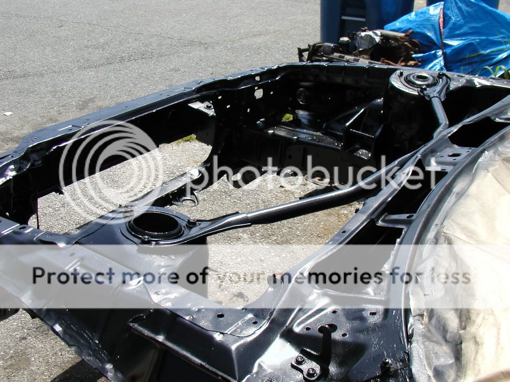

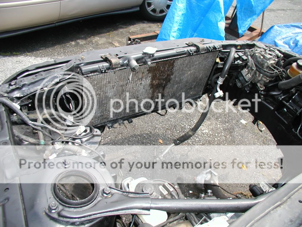

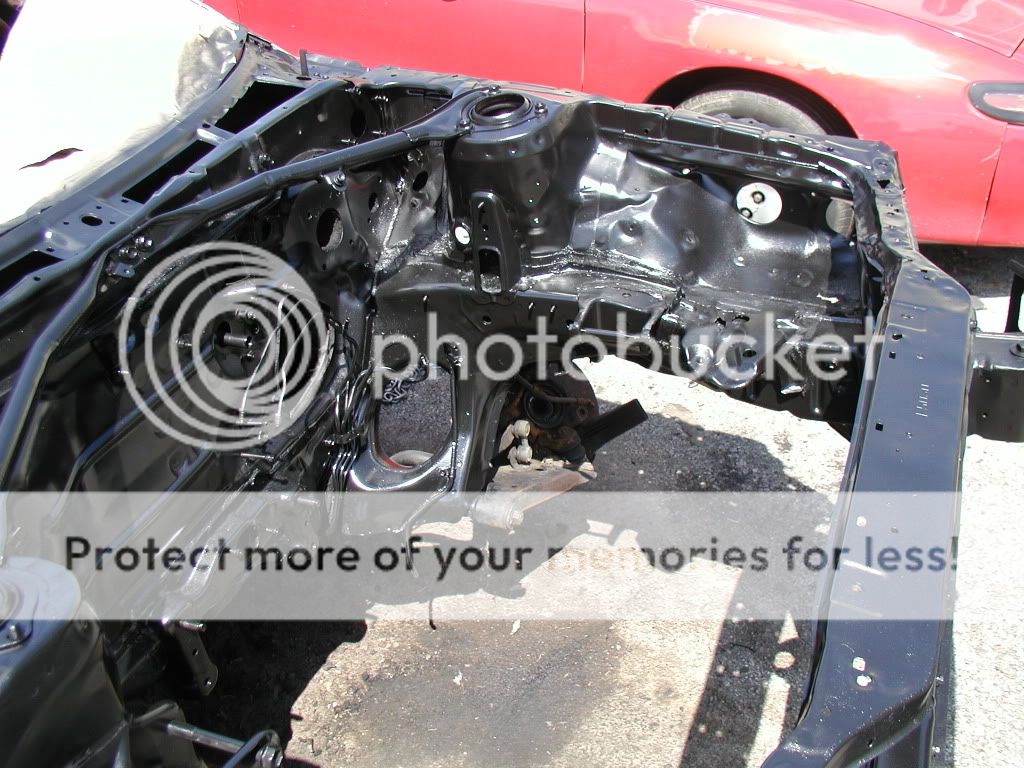

    I also removed everything from the engine bay finally , and sanded and scraped all the rust off, then painted it with the semi gloss black finish from Eastwood. The kit I used ran me $99 and came with 2 cans of Eastwood Rust Converter, 2 cans of Eastwood Rust Encapsulator, and 2 cans of Eastwood Extreme Chassis Black satin finish. It's a pretty straight forward kit, and was quite easy to use . Here are some pictures of the painted engine bay . Please feel free to do a before and after. Thanks for following my project guys.
    Alright so it's day 6 (8-9-09) and I've been pretty busy reassembling the engine bay, or maybe its better to just say assembling, because there wasn't anything there originally that's there now . So I have most of the engine bay done, I have also swapped the jdm 92-93 harness with the 90-91 usdm harness and made some alterations to a few of the plugs to make them match-up.

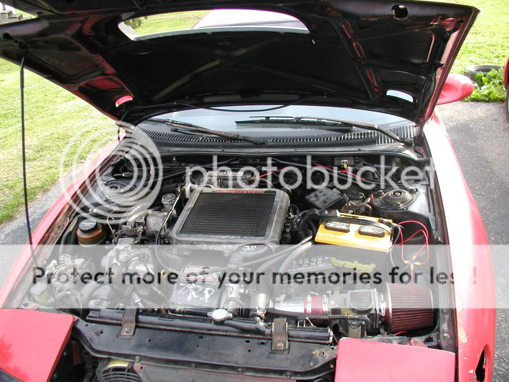

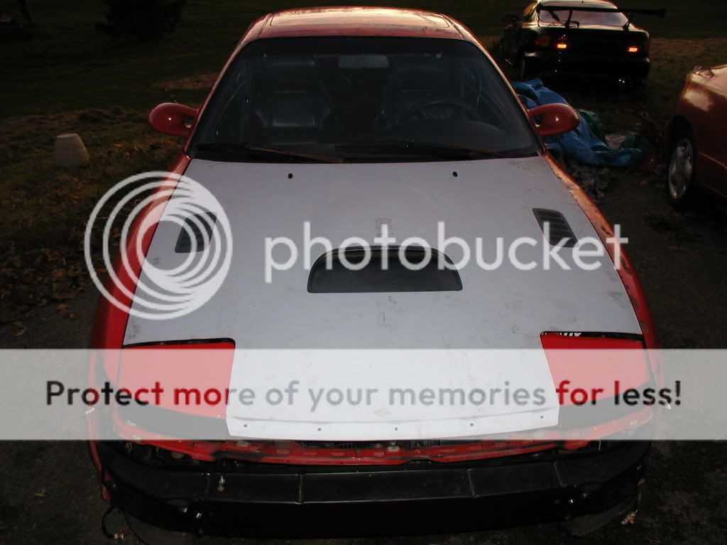

    (11-9-09) So it's been forever since my last post, and I do apologize. Been pretty busy adjusting to a new job, and keeping up with all that I have on my plate has been a little hectic.
    So it is official Project Phoenix is alive and kicking . I got Phoenix running a month or so ago, and now I'm just saving up for parts I need to make it road worthy . Right now it’s running really rich, to the point where carbon builds up on the spark plugs after idling for about 20 mins, and just completely kills any spark . I have been having a really tough time figuring out exactly where the problem is. I was hoping for some forum help on this one. I will be swapping the AFM, and if that doesn’t work I will start with the fuel system at the injectors first then work my way down the line until I can find what is causing it to run so rich.
    If it helps here’s my set-up. I have a JDM 92-93 Engine, 90-91 Engine Harness, and a 90-91 JDM ECU. With fresh spark plugs it fires up 1st time and runs pretty good (bellowing out black smoke, killing all plant life within a 20ft radius) , but pretty good other than that. Then it will slowly start to wind down, and you can tell right away that it’s fading. It starts sputtering out on a downward spiral to nothingness until it stops. After this happened the 1st time I took out the spark plugs and all of them were completely covered in a thick layer of carbon residue . I was thinking of grabbing my tools and a couple sets of new plugs and taking it out onto the highway to see if I can blow it out a little, after I get a front windshield installed this week of course.
    Well that’s all I have for right now, if you guys have any helpful hints or suggestion please feel free to drop me a PM or to just post comments here. I need all the help I can get . I will see if I can get some new pics posted as well after I get the windshield installed .

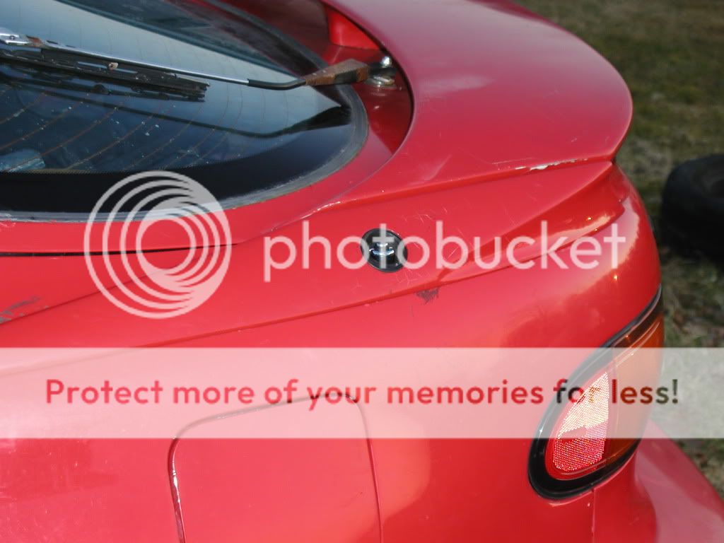

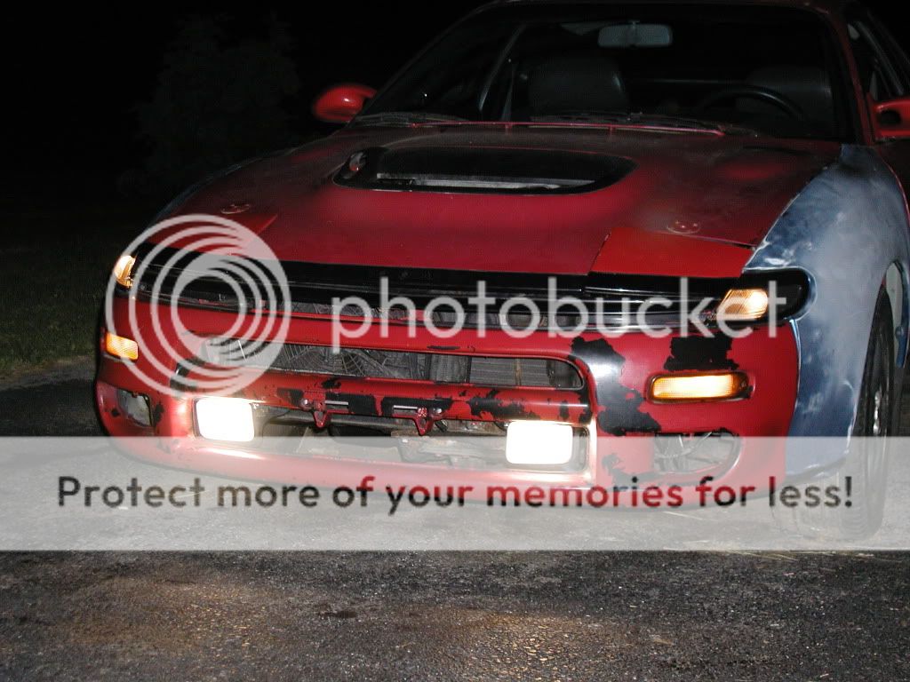

    (11-15-09) Hey guys, so I finally have a new windshield, and I just wanted to update the status so far. The car is 85% assembled and I have most of the other parts, but I am waiting until I purchase an Alltrac front bumper to put the remaining parts on. I should be able to get one in a couple weeks, if I can get the funds together , I hate being poor . I have been doing this entire project on a very strict budget. It is truly a labor of love and a pain in the @$$ sometimes, but as a true enthusiast I wouldn't have it any other way . So I took a few pictures of my progress to date, and remember guys this is done on a very strict budget. P.S. I'm not one of the guys who’s got more money than brains, kind of the exact opposite . There is still plenty to be done, and I want to change the fenders as well, the paint is not that great and I have a spare set from my parts car. I have not taken the maiden voyage yet, I'm a little hesitant because it’s running so rich. I don't want to get 2 miles from my house and have the thing die on me, and have to change spark plugs to get back on my way . So enough chat here’s some pics.

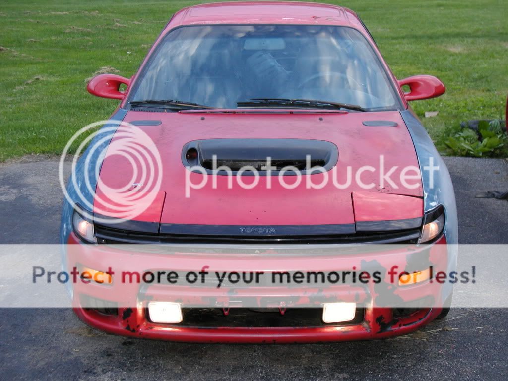

    (1-25-10) Hey guys, I know it's been forever since I have posted an update, nearly 2 1/2 months . Sorry, I have been pretty busy with a new job, and Project Phoenix has been put on the back burner for a while . I have been low on funds, but I have still been piecing things together, like the antennae is now operational, and I also have found the source of the heavy smoke pouring from my exhaust. It turns out that my turbo has bad seals, and it's spewing oil into the intake manifold, and the car is just belching smoke out of the tailpipe. It is ironically idling much better than it has been, until the plugs get saturated in oil then it idles rough. I have another ct-26 coming in from Canada since I cannot afford to send mine off for a rebuild right now. I have also upgraded to 92-93 tail lights, and swapped all the seatbelts what a pain. I pretty much would not recommend doing this unless it is absolutely necessary. The only reason I did it was because the seatbelts that were originally in the car were severely sun-bleached, and were almost white . It's not terribly hard but everything has to be removed from you're interior except your front seats and your carpet. Every interior panel and the rear seats have to be removed to gain access to the seatbelt mounting points .In hindsight I should have just purchased some gray interior vinyl spray paint and just masked off the belt itself and saved myself the headache . I have a much newer 92 Alltrac steering wheel installed now, and the car does have an Alltrac front bumper installed, and I have also swapped out the rear bumper as well. While changing out the rear bumper I noticed that the car has had some repair work done to the drivers side rear quarter panel, and not very professional work . The bondo is around 1 1/4" thick, and the body panel itself is severely mangled . To make matters even worse I had a friend come down to check the car out for me so that he could give me an estimate on a complete re-spray. While he was inspecting the car he noticed that the front radiator support was bent and that the car showed other accident damage . On the other hand he told me all the damage could most likely be fixed with parts from my GT-S parts car and that he could fix everything and re-spray the car any color for about $2800 which I think is a pretty good price considering the current state of the car. Now I just need to decide on a color . I'll get some new pictures posted sometime this week. It's coming along slowly, but I'm just going to keep plugging away at it as funds become available. Thanks to Brandontoyota for the Tail Lights, and FWD-3SGTE for the front fenders which I will use on my 90 GT, and thanks to Cozmic512 for the front bumper, fog lights, and the steering wheel . P.S. if anyone is swapping out a 90-91 steering wheel for a 92 the cruise control and airbag/horn braces are different, and the holes don't match up. Nothing a dremel and a little modification can't fix .
    Thanks for following Project Phoenix guys

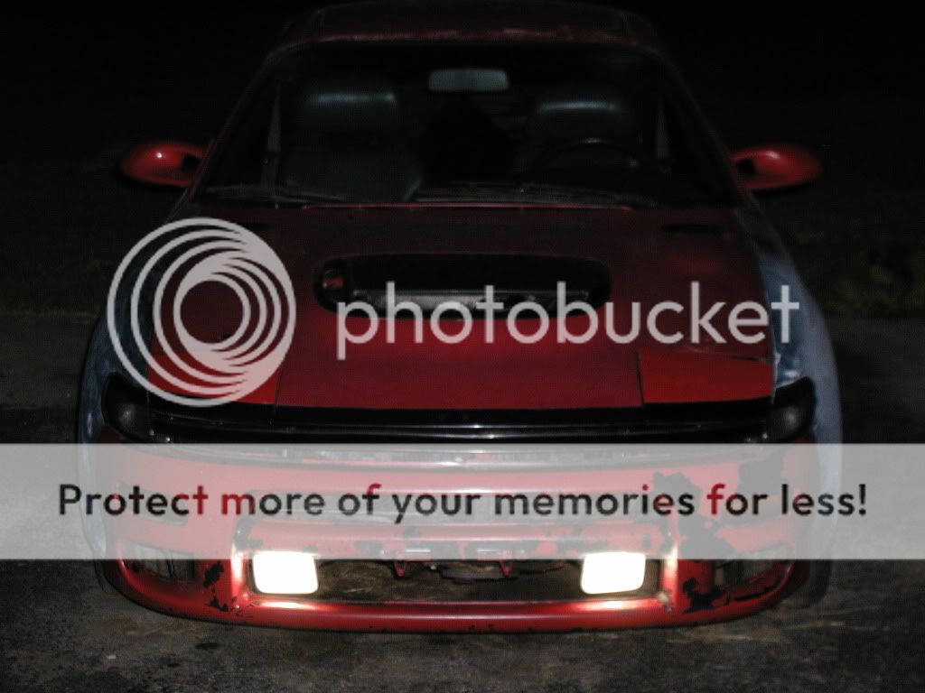

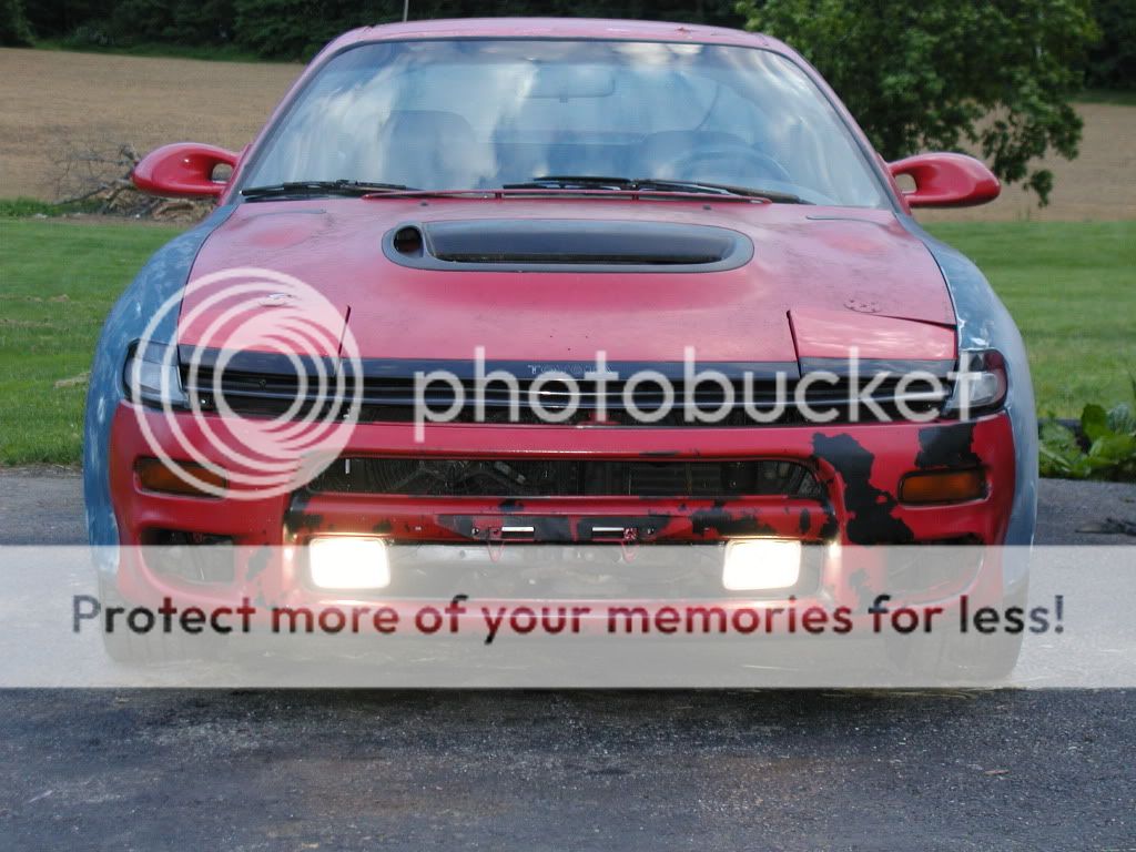

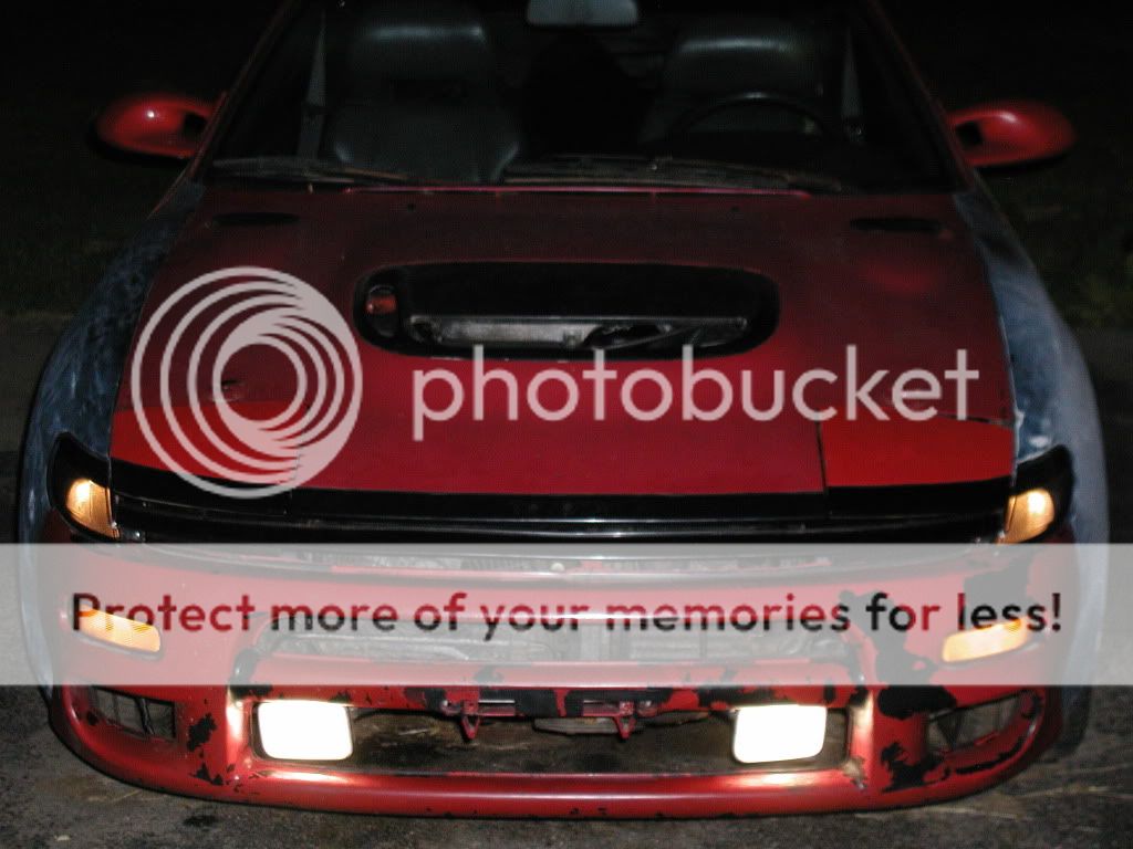

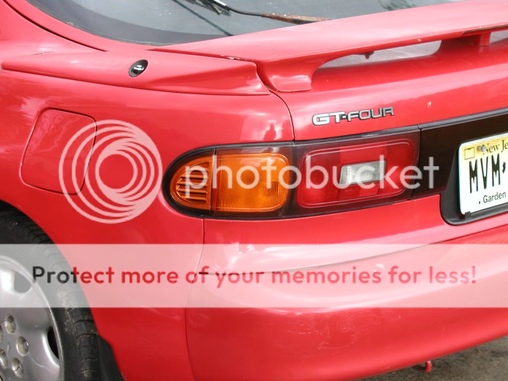

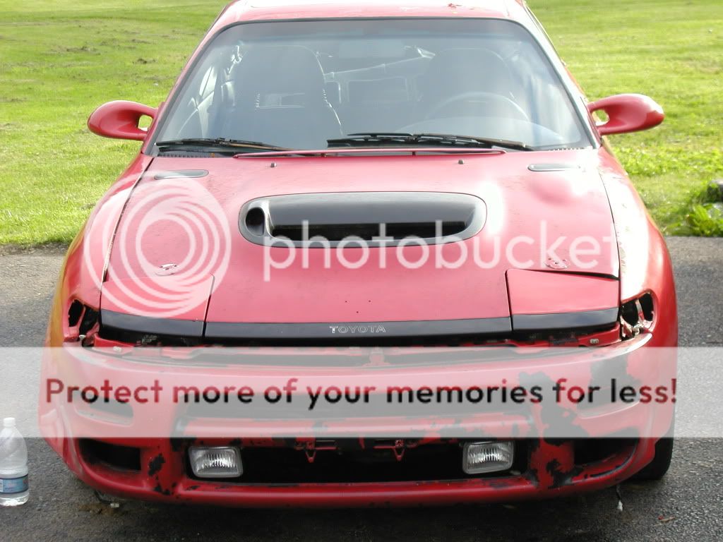

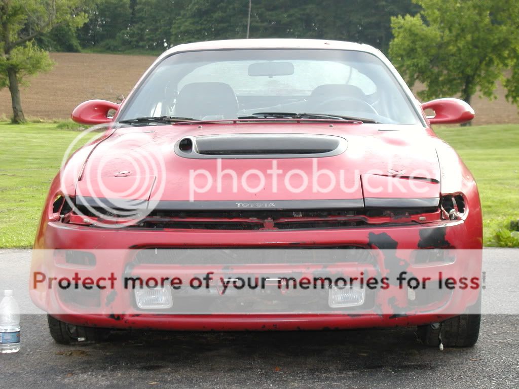

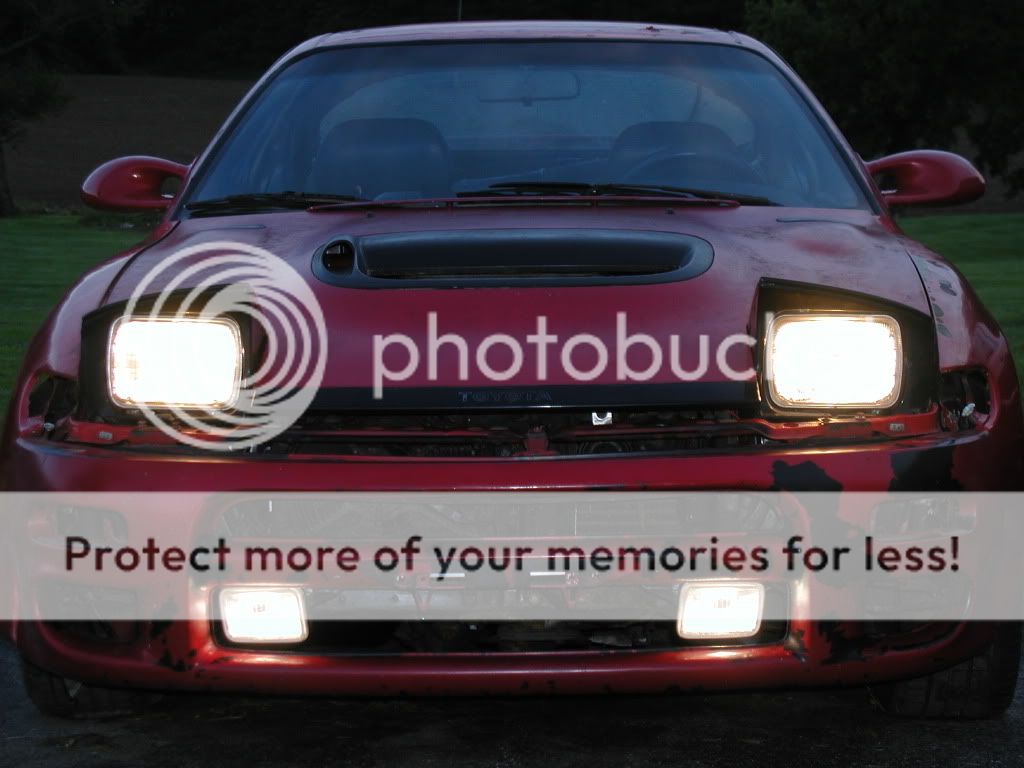

    (1-27-10) Hey guys I finally had a little time to take some up to date pics of Project Phoenix. The picture of the drivers rear quarter panel is not bad panel fitment, it's almost 2" of Bondo . I guess someone was practicing to become the worst auto body repairman in history . I most likely will have the rear quarter cut from my GT-S and welded on. It is in much better condition and the Alltrac has major rust on the rear wheel arches also, so both sides will need some minor surgery. I also took pictures of the upper and lower radiator support to show the damage there. It is bent just enough to have to be replaced, and is the major reason why nothing in the front of the car lines up properly. Notice the minty 92 steering wheel compliments of cozmic512, he threw it in at no charge when I drove up Thanksgiving weekend to pick up the front bumper and fog lights . I have all the trim pieces I'm just a little scared to put them on with all the mechanical work that still needs to be done like swapping out the turbo, and a full tune-up soon after that. I also have a nice set of JDM clear corners I will be installing as well , I picked them up for $60 shipped from Japan.
    Thanks for following Project Phoenix guys......Feel free to suggest the new color Red is not an option

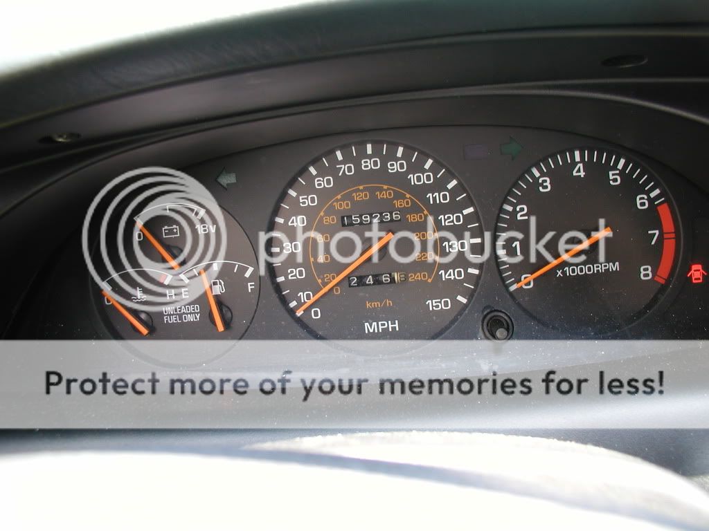

    (2-21-10) Hey guys, time for an update. I have swapped out the turbo, and completed a full tune-up, and the car runs much better, and no longer belches smoke, but I don't think the turbo was the problem in the first place. I'm not sure why, but I'm getting oil from the breather tube in the head, and that's where the oil problem is not the turbo like I originally thought. So I'm back to square one, with a real big decision to make. I'm not sure whether to just buy the parts from Toyota to do a legitimate rebuild, or to just buy a used JDM 3SGTE and go from there. On one hand, purchasing all new Toyota parts while being the more expensive way to go, I'll end up with a 0 mile motor. On the other hand JDM 3SGTE motors are very common, and I could even grab a MR2 long block and swap over all the alltrac specific parts for a fraction of the cost of OEM parts and a rebuild at a shop. Not really sure which route I will take at this point, funds will play the major roll in the end .
    I also attempted to drive the car for the first time with pretty much the results I expected. I took all my tools, and a replacement set of spark plugs with me because I knew the engine would blow oil into the intake and foul up the plugs, but before that happened I did drive it 500ft. a new record. The old record was 3ft. so I'm going in the right direction . After the 500ft. maiden voyage the car just slowly sputtered out so I let it cool down, and just swapped the plugs and reversed it back 500ft. before it died again. I'm not really sure how to fix the current engine problems. It's no longer belching smoke, but when I took out the plugs they were all covered in heavy black soot, and plug 2 & 4 had oil on them 1 & 3 were just black. So as I said earlier I have a decision to make; rebuild or replace. Let me know what you guys think.

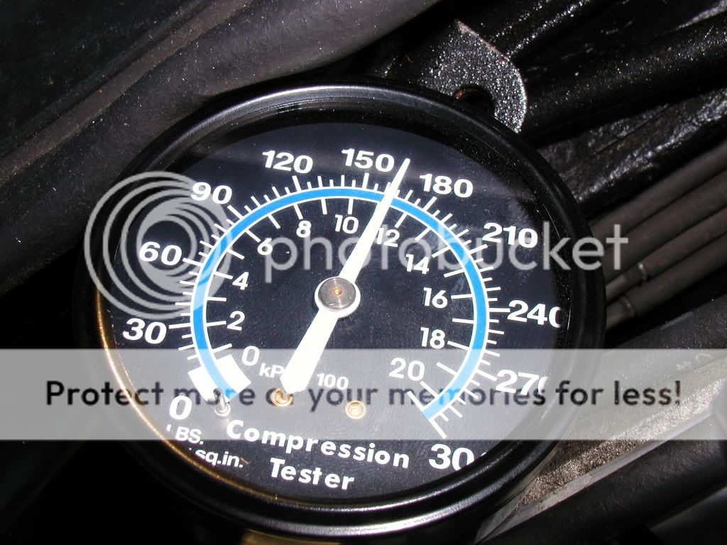

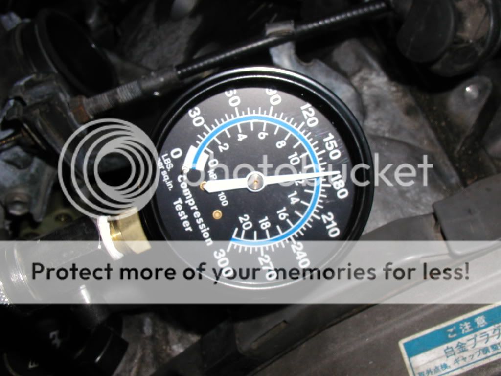

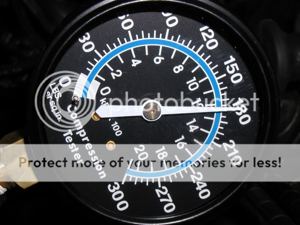

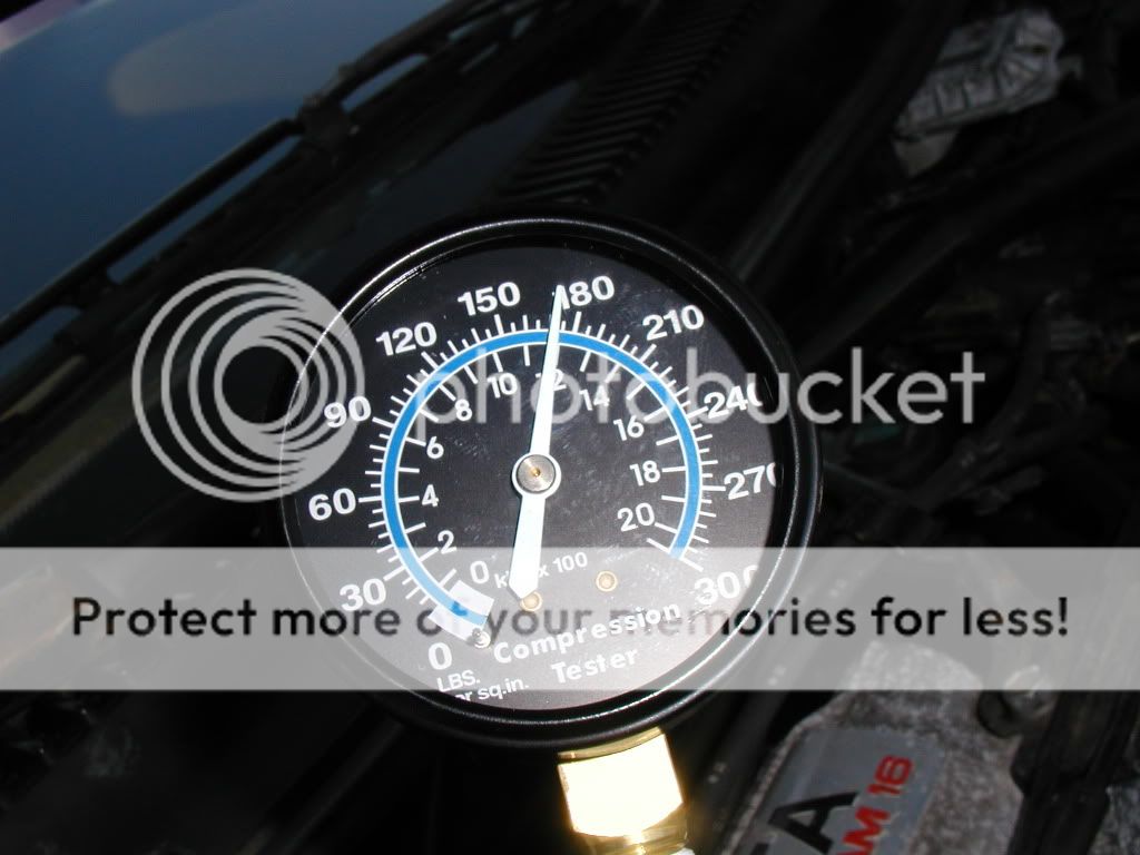

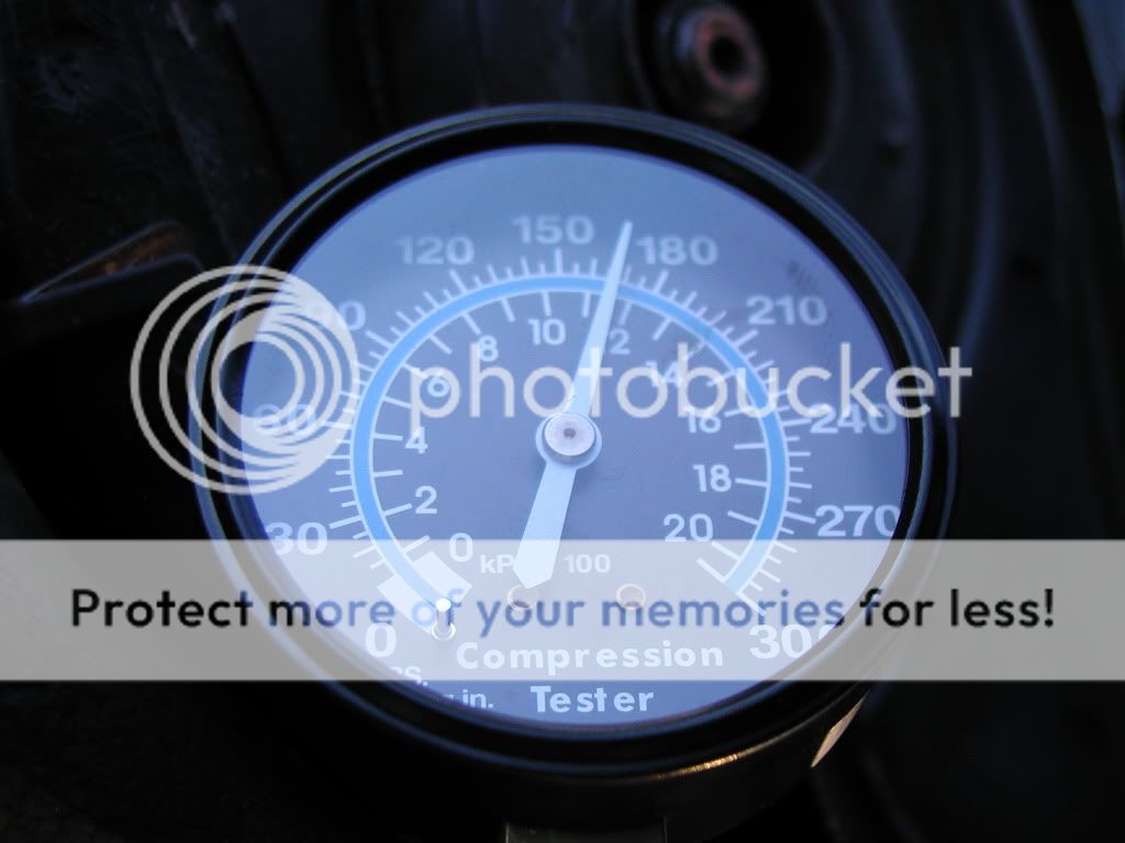

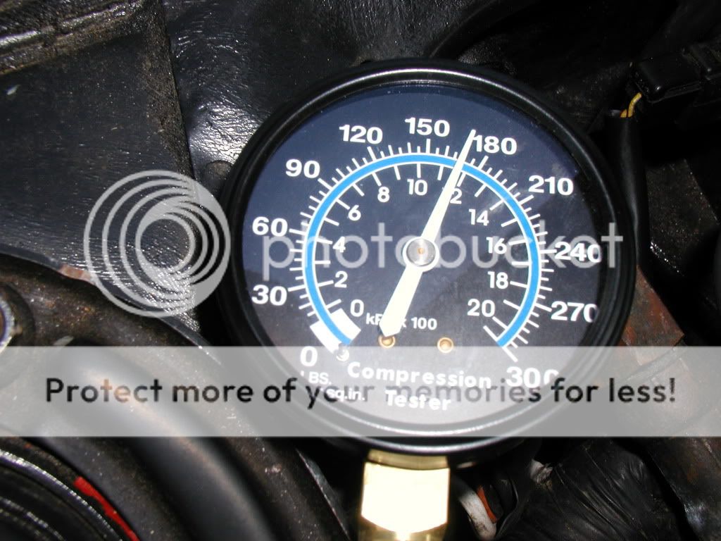

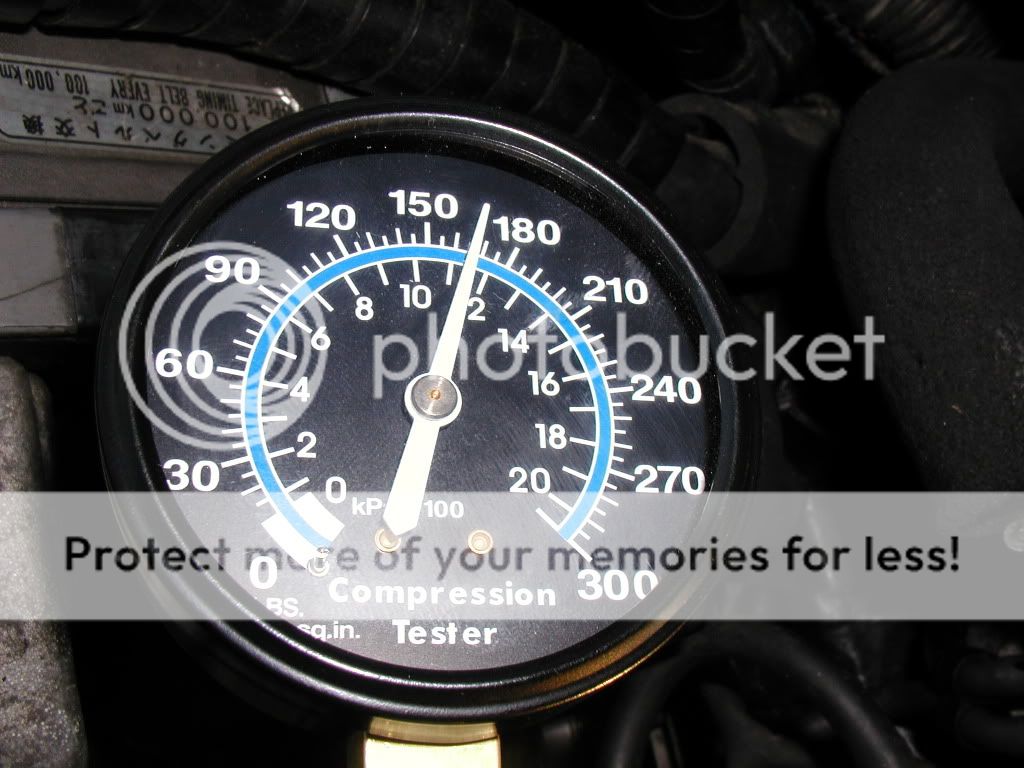

    (3-1-10) Hello again guys, so today I did a compression test and the compression is between 170-180 across all four cylinders. When I pulled the plugs they were all covered in heavy carbon as I expected they would be, and all had what looked like oil on them. I'm not so sure it's oil I think it's dirty fuel, and here’s why. Not satisfied with the compression #'s because they are all within spec. I cleaned up the spark plugs and placed them back into the cylinder they were removed from, and I started the engine. It fired right up first time and while it was running I removed the breather hose from the head and held my finger over the whole going into the intake. At first nothing was happening, then what looked like oil started to come from the breather hose very little at first then more, and every time the engine fired in one of the cylinders the fluid pulsed from the breather pipe. I think it's fuel because I held my hand in it while it was spraying out to see exactly what I was dealing with, and after a few seconds it started to evaporate. So I assume it's not oil but dirty fuel. Why it's dirty, I'm not too sure, but due to the fact that this is a car that had extensive fire damage, my guess is maybe there was some soot left in the fuel lines or even rubber that melted and is now clogging the line completely . Let me know what you guys think, I could use all the help I can get, please feel free to post solutions here or drop me a PM with possible fixes. I also took the time to take a look down into each cylinder before the test just to see if there was oil present inside the cylinders, and I didn't see any. I was also told to not release the cylinder pressure right away to get a more accurate reading, so these #'s are about 1 minute after I initially cranked the motor to start the compression test. Thanks for following Project Phoenix guys. Here are the compression test results:
    Cylinder one
    Cylinder two
    Cylinder three
    Cylinder four

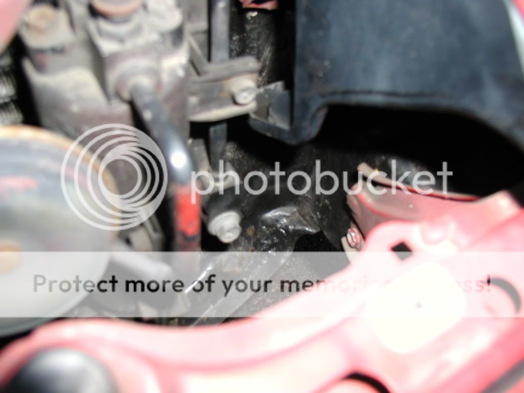

    (5-19-10) Hey guys, so this weekend I decided to run ground wires to all the major engine bay locations: coil, igniter, engine block, and resistor packs. WOW what a difference, the car has come to life and is running very good. It's like night and day, the car actually has sharp throttle response and idles nicely too . I wasn't expecting such a huge difference, and a few guys have been saying this the whole time , but I never in my wildest dreams thought grounds could effect the performance that drastically. I would like to apologize for not listening earlier my noobness got the best of me again . The car is still smoking, but only blue/grey smoke no black smoke under heavy throttle. I was so tempted to take it around the block, but decided not to until I fixed the headlight which turned out to be a badly oxidized female plug, and the horn which was wouldn't you know it bad grounds . I guess in hind sight painting the entire engine bay black looks cool, but I believe all the grounding points were painted over and now are causing all kinds of issues. I also received another fuse box from darthripley OMG I wasn't expecting such a nice fuse block for $15 shipped it even had all the fuses and relays . Thanks darthripley very nice indeed. Earlier this week I took the time to retrofit the MKIII Supra foglights to the CS/RC crash bar, and it wasn't really hard, but I think I'm going to have some issues fitting a front mount , but it does look cool. I also fitted a straight intake and relocated the battery back like 10 inches, it's going in the trunk when I get funds for a relocation kit. So here are some pictures guys, be honest let me know what you think.

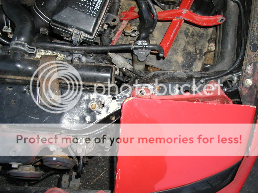

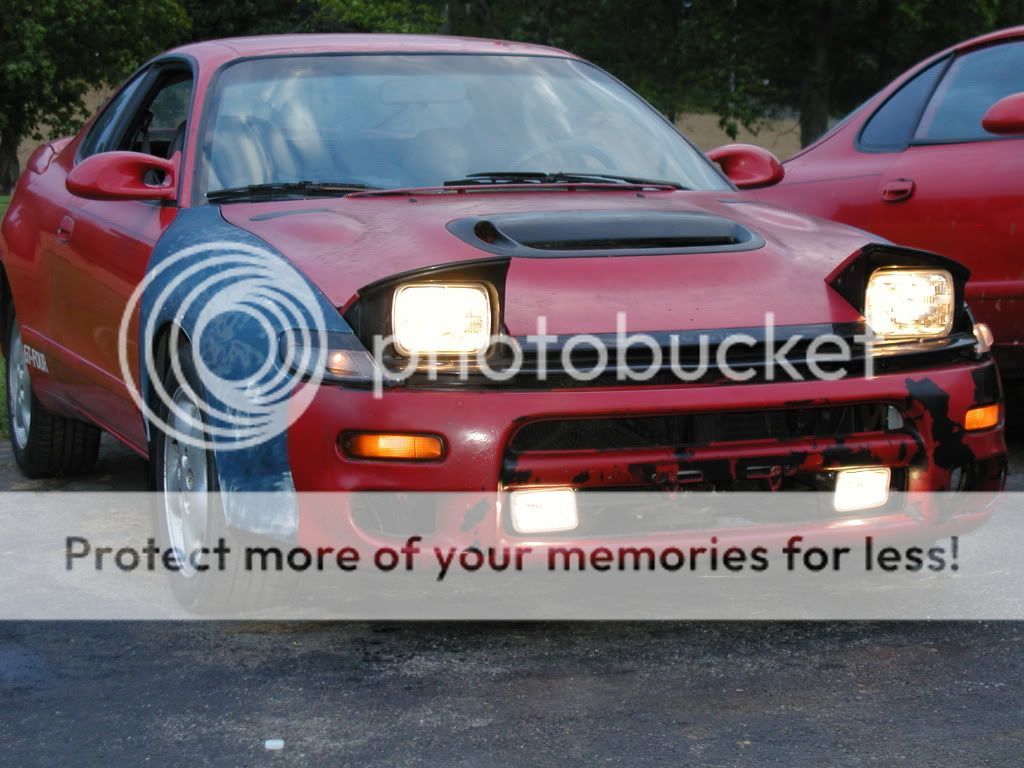

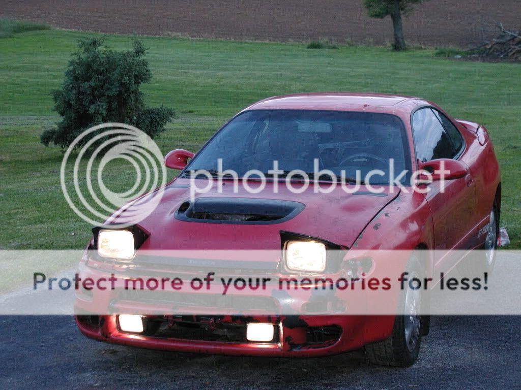

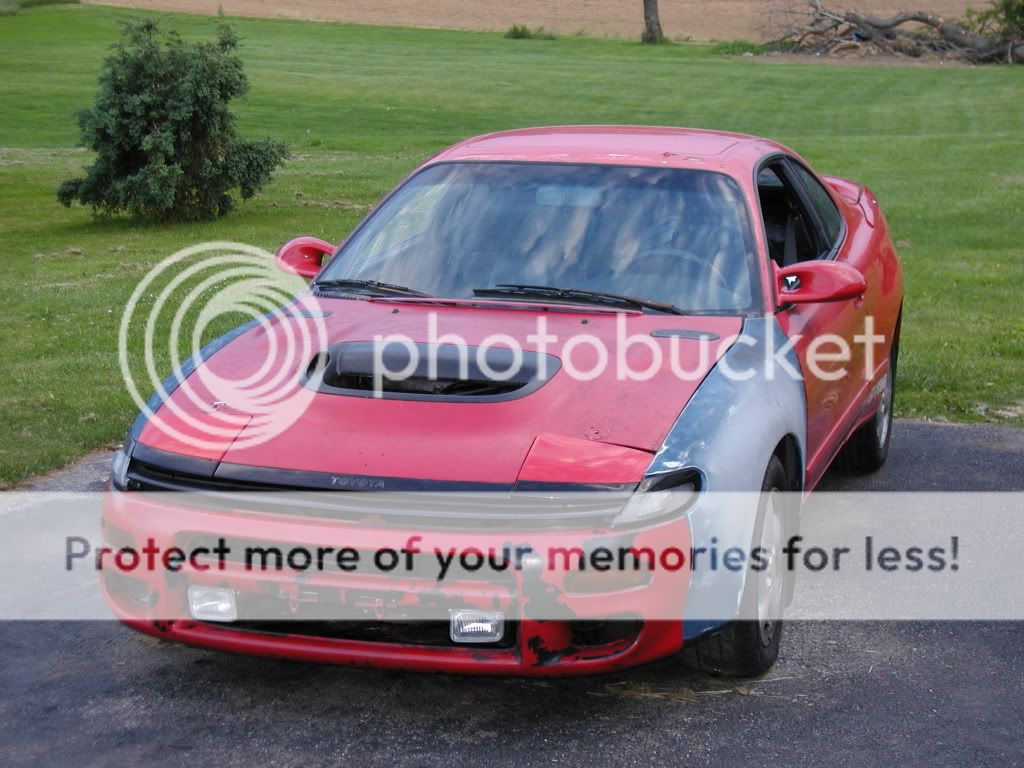

    (5-23-10) I took the time to swap out the fenders, and it made a big difference . The original fenders were OK, but I had a spare set so I decided to use these instead . Being completely broke this week I decided to do some inexpensive mods, so I noticed that there was a link on how to turn off your air bag light so I decided to give it a shot. The Radio Shack parts required were about $6 so I decided it was within the budget . I constructed the tool and followed the instructions and now my air bag light is no longer on . Keeping with the poor mans mod theme I also decided to do the fog light mod and it was extremely easy literally took 2 minutes to complete . I like the idea of having the fogs on whenever you want not just when the headlights are on. I looks pretty cool with just the fogs on and nothing else . So my spending for this weekend was $6 at Radio Shack and $1.29 at Lowes for a 6 pack of wire tap splices. So 2 mods for $7.29 now that’s a budget build . I also changed the oil this weekend, and what I found is a little disturbing . I drained the oil and it was diluted heavily with fuel. When I measured it out it was almost 1 ½ gallons that came from my oil pan . It was nearly 60% fuel. I know the fuel pump was wired up wrong, but I'm not sure if that would have caused this problem . I filled the car with Royal Purple 10w30, which I purchased last week for $50 , but it did come with a K&N oil filter that has a 1" nut on the top to screw it on and off with nice . So no that was not part of budget build weekend . I will see after I run it for a while I will check the oil level to see if it is rising. If it is I may have some serious problems on my hands. I will also be doing another compression test to see if my numbers are the same. Any ideas guys, I'm really confused as to what could cause so much fuel to get into the oil like that . I took a few pictures to show my progress guys. Thanks for following Project Phoenix

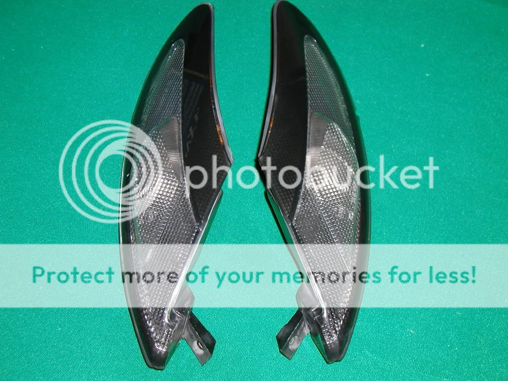

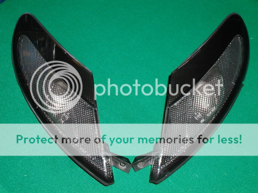

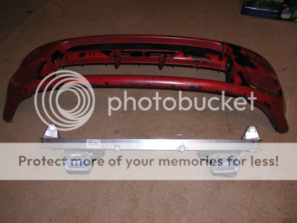

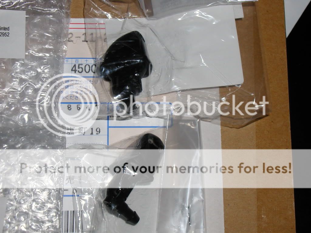

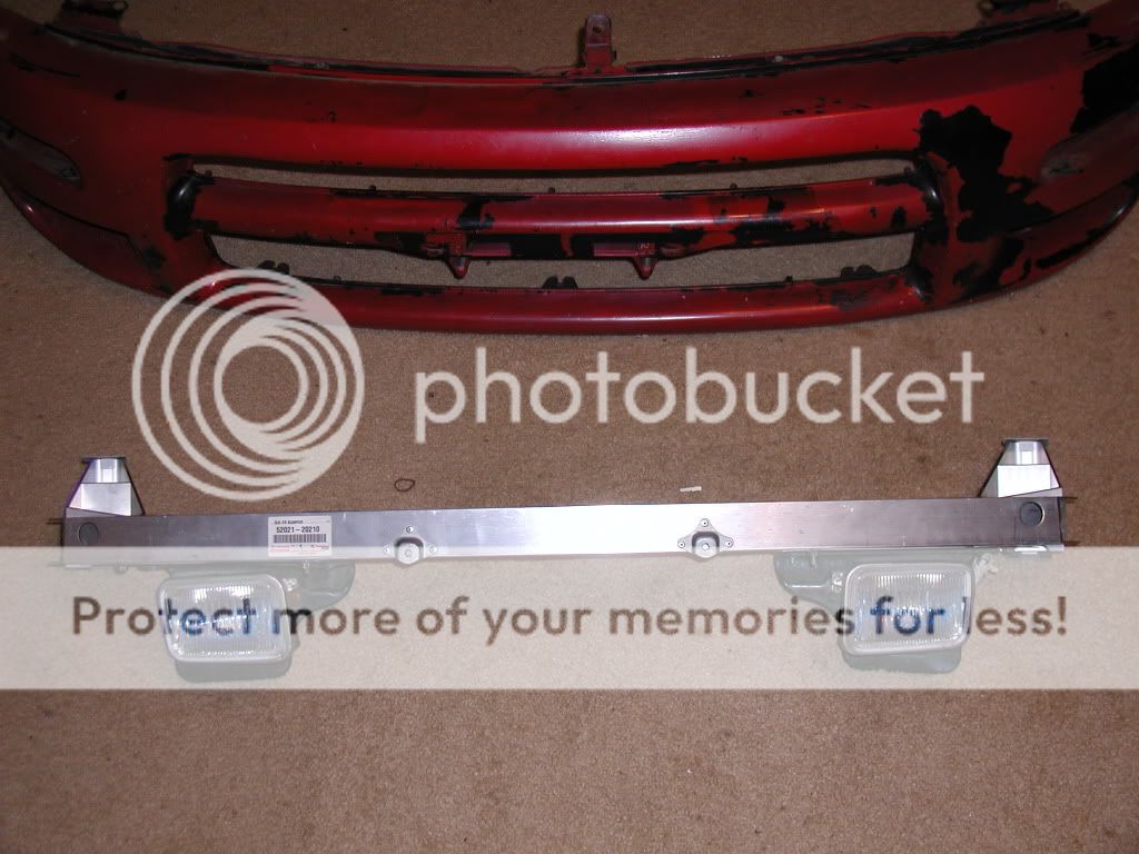

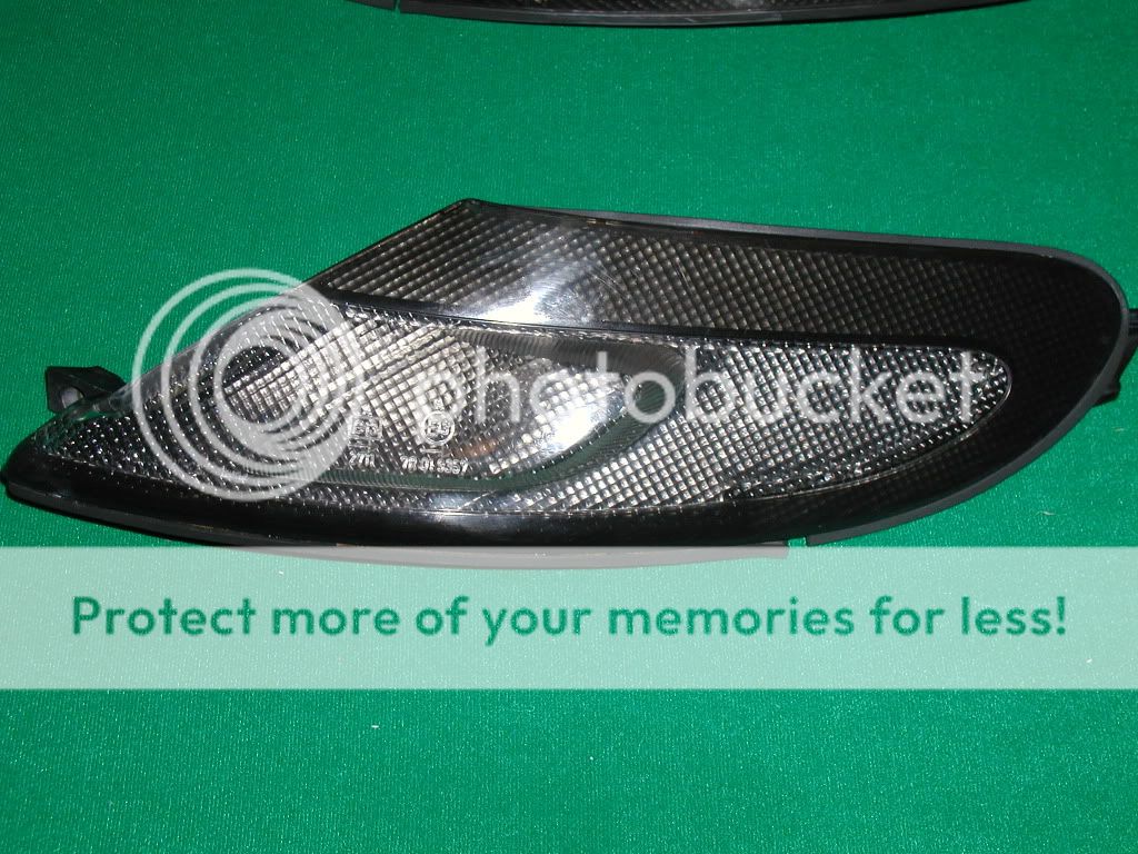

    (5-24-10) Hey guys I got home today and FedEx delivered my parts from Japan . I picked up the vented corners and also the high sprayer nozzles to clear the hood spoiler on the CS/RC hood. Probably a little over priced on the sprayer nozzles, but I think they look good . So here are a few PICS I took today. Thanks for following Project Phoenix guys.
    Before
    After
    Before
    After
    Before
    After
    Before
    After

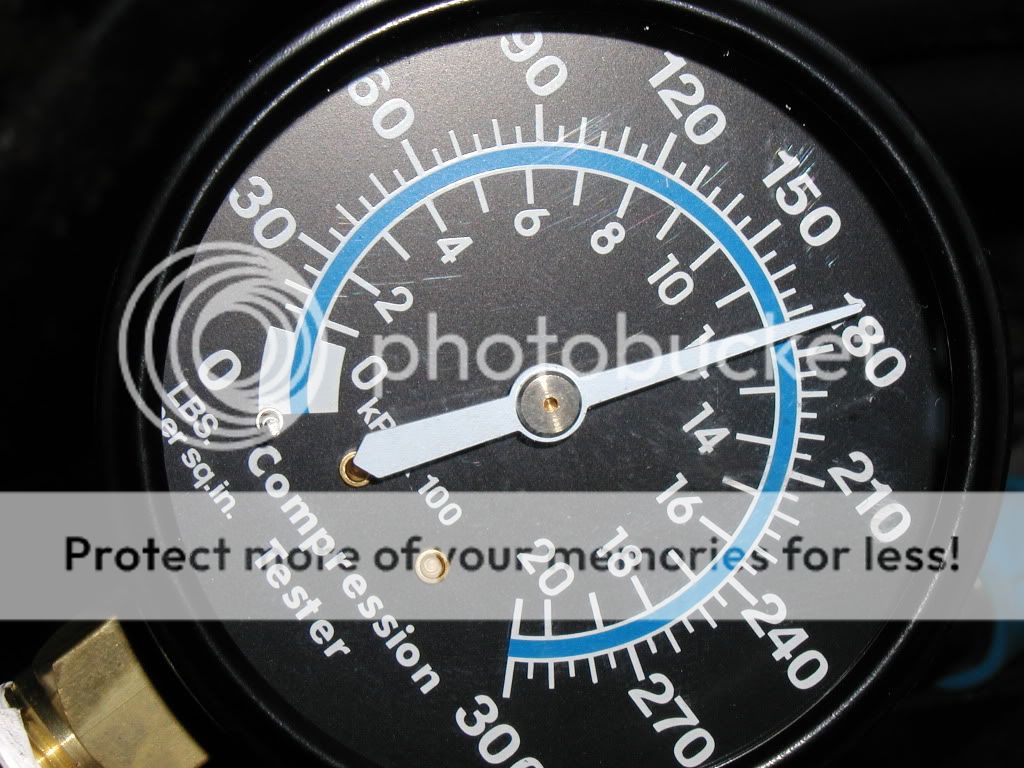

    (6-10-10) Hey guys, so I decided today after checking my ECU grounds and coming up with good resistance numbers that I would take another short drive. So it pulls good in 1st and 2nd but when I shift to 3rd it's like at first nothing happens as if I'm not pressing the accelerator at all. Then after a few seconds after the car slows down a bit the engine slowly sounds like its kicking back in and after that it will pull good in 3rd but repeats the same thing in 4th . No clue what’s happening here, but I did notice some residue on the alternator and valve cover like maybe something electrical was arching, its hard to explain but it looks like a chalky dust almost . I also watched as the gas needle went from just over a 1/4 tank to almost empty in the 1 mile round trip. So seeing as its still running super rich and the gas is definitely still filling the oil pan I thought maybe the head was warped or cracked and it didn't show on my 1st compression test because the engine was cold. So as soon as I got back home I took the intercooler off very hot after my 1 mile voyage and I did a compression test while the engine was still warm just to see the change in the results:
    Cylinder 1 Cold
    Cylinder 1 Hot -3psi
    Cylinder 2 Cold
    Cylinder 2 Hot -2psi
    Cylinder 3 Cold
    Cylinder 3 Hot -12psi
    Cylinder 4 Cold
    Cylinder 4 Hot -12psi
    Notice how cylinders 1 and 2 have a relative low compression difference while cylinders 3 and 4 have much larger drops in compression . I'm not sure if this test shows much, but I think its odd that the compression differences would be this significant. I'm not sure what’s the next step here. Do I continue to work on this engine or purchase a new one or another cylinder head to see if that fixes the problem . I am at a serious cross roads because I need this car in running condition by this time next month. What do you guys take from the compression number differences and any suggestions how I should proceed. On a positive note AlltracAllday has decided to donate his Auzzie down pipe to me . I also took a pic of the 3-in-1 OEM radio as well take a look:
    I have to figure out my next step here guys, I'm seriously running out of time here . By the way that's a functional JDM push type auto open ashtray under the radio . Thanks for following Project Phoenix guys, I will be swapping the throttle body this weekend and I'll be disconnecting the cold start injector to see if that does anything

    9. I replaced the fuel rail, injectors all new o-rings, and fuel pressure regulator, while this was being done I accidentally stripped out the threads from one of the throttle body coupler holes
    10. I did a compression test warm: 162-170 across all cylinders
    11. I replaced all the temperature sensors on the waterneck and the radiator cooling fan, and replaced the thermostat
    12. I used an air compressor to blow out the fuel return line
    13. I changed the throttle body and the entire waterneck w/ sensors and another sensor harness.
    Between all these changes I have replaced the spark plugs countless times using different types from platinum, iridium, and copper with no change at all. I also had to change the oil a few times, every time it's very thinned out by gas at least three times the amount of gas to oil. I wanted to verify that it was in fact gas and not coolant so I did a fire test. I poured a bit of what drained from my oil pan on the ground put a match to it and it ignited and burned very well . Everyone I have told about this problem including Toyota Techs are scratching their heads, because this type of problem may happen to some degree with an engine with a bad piston or bad rings but not to the point of filling your oil pan with gas and certainly not on an engine with good compression. It is a complete mystery how this is happening .
