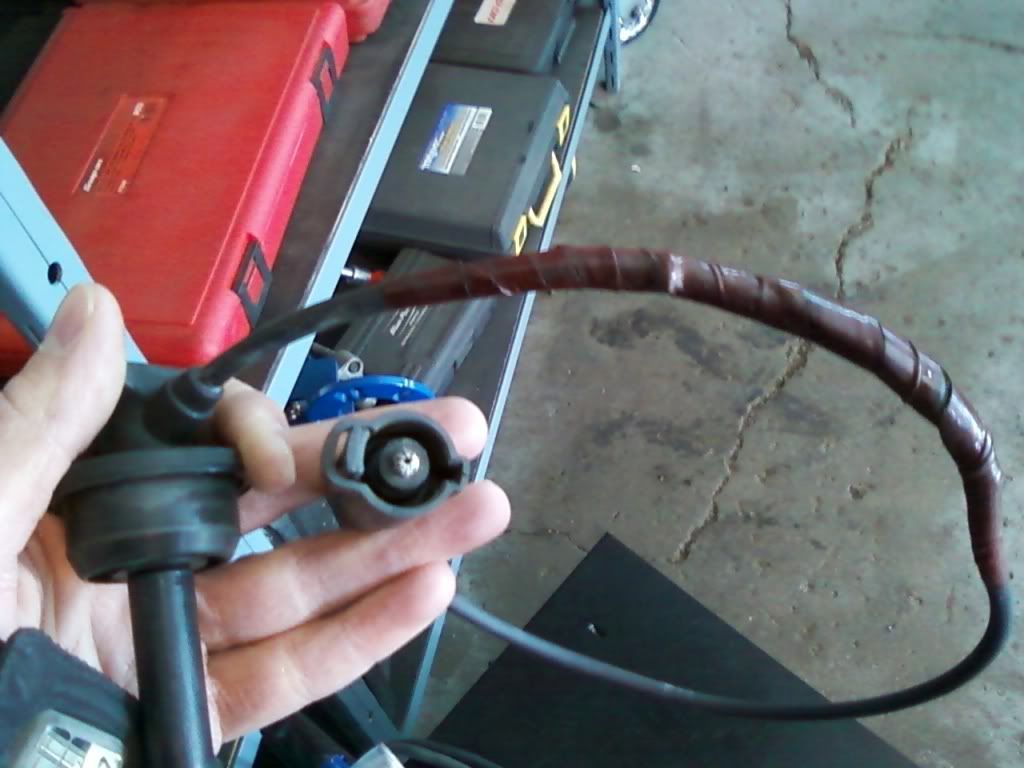

    We dropped it off at my friends shop and I told him to do a full set of checks on everything before we pull the motor, I made the mistake of yanking the motor on my 87 and I could've easily rebuilt it. The next day he sends me a text with the following info:
    Compression: 150, 149, 149, 149. Spark plugs and wires are absolute crap, and the valve cover gasket is leaking, it also needs a front axle, wheel bearing, and steering rack boot.
    When I went down the shop he showed me the plugs and wires, apparently someone went through the hassle of getting to the spark plug wires and just taped them up instead of replacing them. Unbelievable.

    Pretty much, the "major" issue was the spark plugs and wires along with an intake leak and an exhaust leak to get it driving, but the number of side issues has added up pretty quickly too. The poorly patched rad blew up, the suspension was basically shot, the brakes were toast and the exhaust was literally falling apart as I drove it so it's basically a standard abused old Toyota, the engine will last forever but all the stuff around it was falling apart. Since I wanted to upgrade all that at some point anyways, in the end I think it all worked out. I'm into it for less than the cost of a new, base model Yaris so I think I'm doing okay lol.
