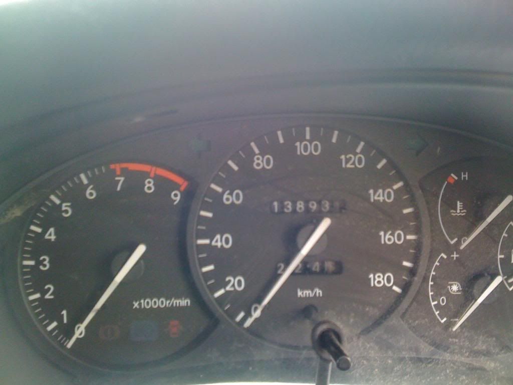

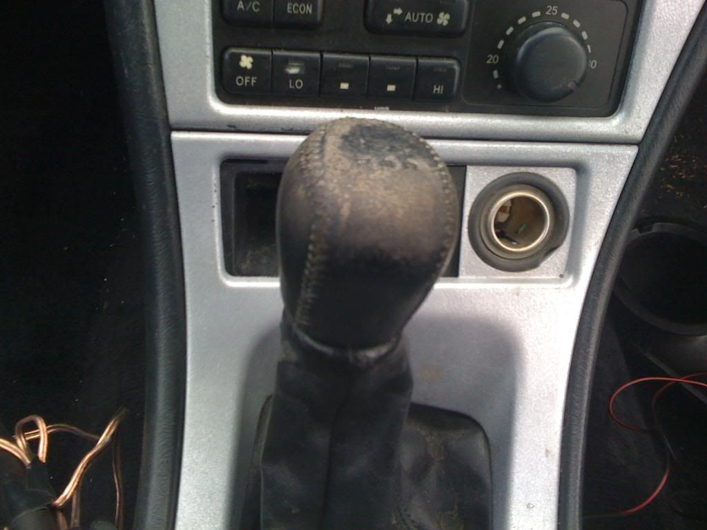

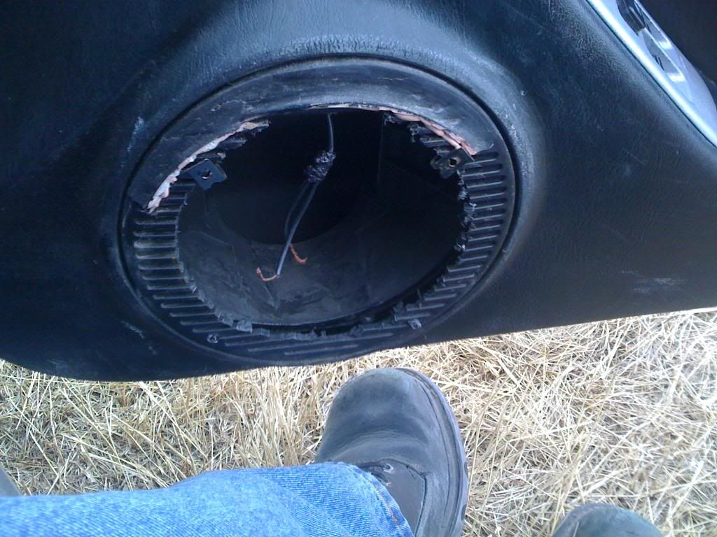

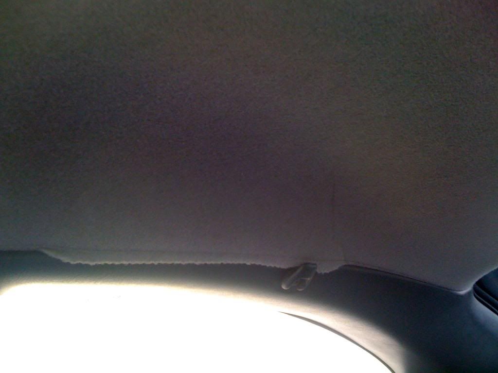

    My Project: 1994 Celica Gt four (3sgte 3rd gen) RHD
    Bought on January 12th 2011. Cost $2000. (Not running)
    Rebuilt turbo, stage 2 clutch (screwed up the install won’t engage after 1 day of driving),
    Re pulling to fix clutch now.
    List of parts needed:
    Engine/drive train: BOV, Manifold + down pipe, radiator cap, exhaust.
    Electronics/gauges ext: Trans temp, boost gauge, gauge cluster, turbo timer
    Interior: Roll cage, driver’s door panel, short shifter + knob, E break handle, assorted trim new seats, head liner.

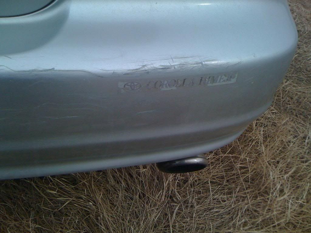

    Exterior: Rear bumper cover/ body kit (I’m unsure what I'm doing), tail lights tires and rims. Not worried about outside for now.
    No comment
    He painted some of trim with a brush.......... some people

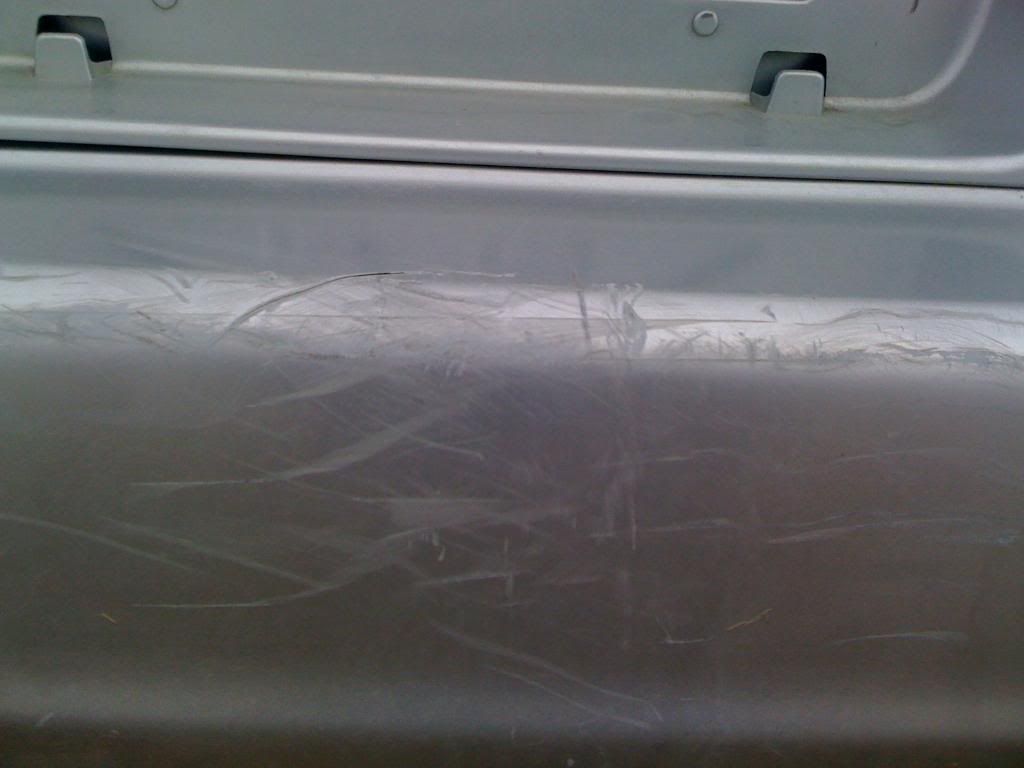

    Scratched to hell
    1 of these rims is not like the others LOL

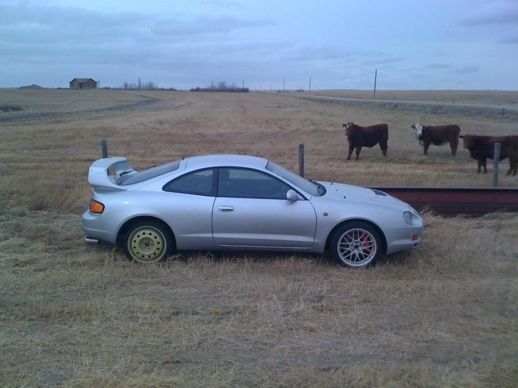

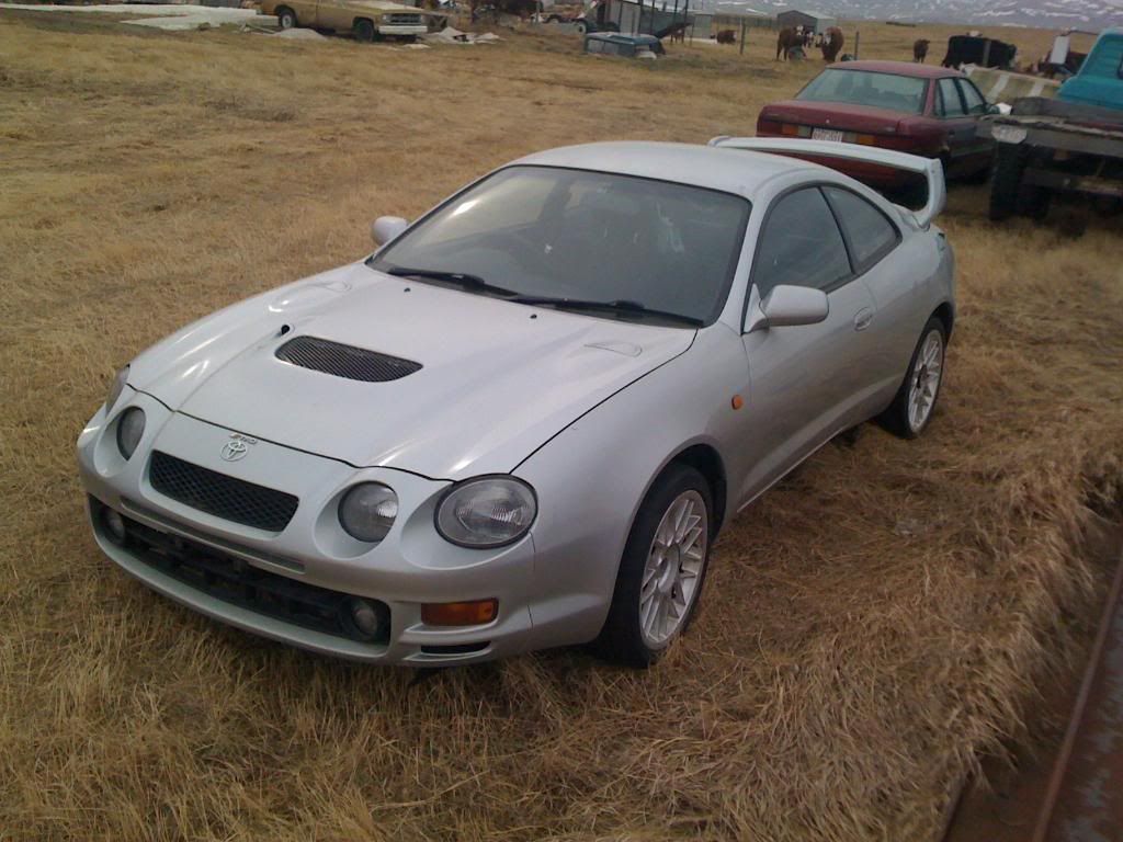

    Here is how it sits as of now. I like the silver but I'm not sure what I'm doing with it. I have always wanted to do a nice flat/satin black (I have a spray booth to use) with black rims, smoked out lights and blacked out glass.
    This is just a quick list of things known to be needed as of now. Nothing performance related as of yet.

    I'll check the ebrake handle and headliner on my parts car when I get home to see if its suitable for selling. That's about all I got.

    I could also check on a speaker grille for you too.

    Thanks let me know what you want for the E brake handle
    It was a car that a friend started to tear aapart to work on and never got past the tear down. I got it all ripped apart.
    Pretty bad when your the 3rd person asked if it got stolen LMAO.
    I do have a used door panel and maybey a headliner on the way. Also im waiting on a possable matching rim. im just waiting to see what shipping on them are. My main things that are needed right now are a bov and and tires so im able to drive it to a friend shop. im tired of working on it out side.

    Quote Originally Posted by Mr.Rift View Post
    Cows not helping much?

    They a gaurding it for me

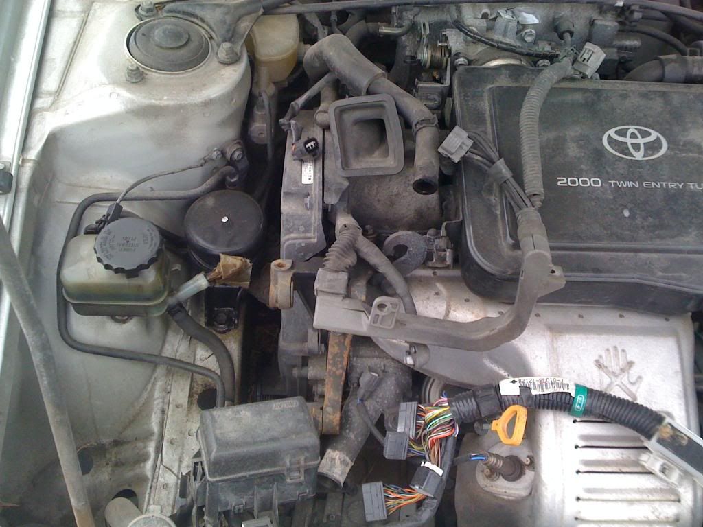

    Well the car is on the road sorta. I found out why I have been having so many probles with this car.
    I will be ordering Crush sleeves ...... i think is what they are called. and finaly have got most of the course thred standered bolts out. Lots of re-threading. I think that almost 95% of them have been done. The owner that had the car befor me had put course thread standered bolts everywhere, places like the bolts in to the subframe where the banana arm goes and torqued them in there so tight so it wouldn't move because he didn't have sleaves in it. Im hoping there is still enuff life in the bushings so I can wait for a bit to get new arms.
    I have replaced all of the farmer rigging wiring job done in it then welded up the drill holes in the fire wall.
    I also found a piece on my car not sure what it does and where it goes. It has wires going in to it so its important.
    This is the fun part its like putting together a jigsaw puzzle with no picture on the box. Ah your not a back yard mechanic if you don't a few pieces left over.

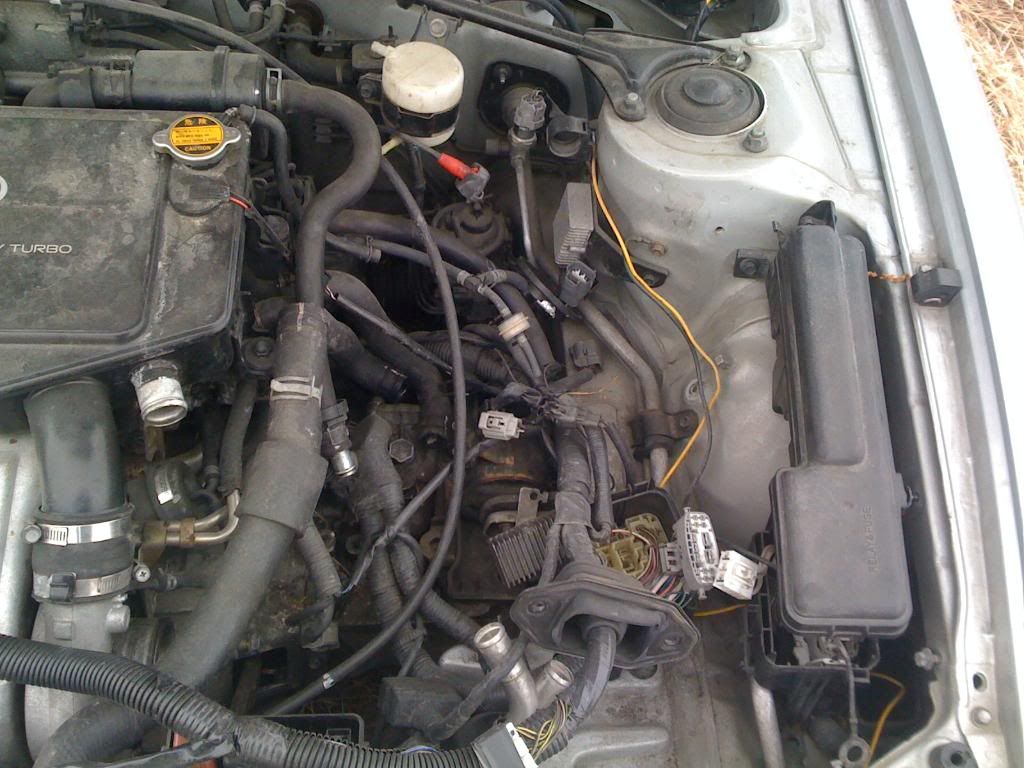

    New brake pads, crush sleves, and IC pump on order. It runs and drives but stuck in limp mode due to a code 54. I start it up get it to operating temp then rev it up. The coolant in the intercooler doesn't drop so im assuming the pump is done. I'm ordering a new one and the senser on the top of the intercooler aswell. I also have a small crack in the rad right on top by the rad cap. I'm thinking of using jb weld untill i can find a new aluminum rad.
    Solved my code 14 problem by cleaning my conections and replacing a ground wire.
    Need to find out another problem area though. I have a buzz coming from a relay in the headlight relay box. the relay is ok but I think the wires might have a short in them.
    In the pic you can see where the relay that is buzzing was. The Empty slot to the very far left of the box. Also you can see the crack in the rad.
    Here is a pic of the whole bay (Its a mess but i'm trying to fix every think befor i can clean it up)
    I'm also going to be getting a cupple rolls of vacum lines so i can replace all the existing ones with new ones.
    Thanks for reading and im always up for advise
