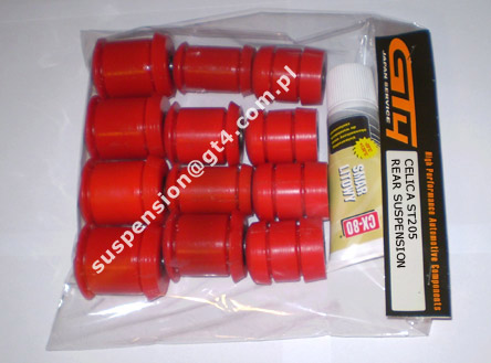

    i had a ss teflon oil return line made and i installed a cometic oil pan gasket (thanks to joel aka 1not2listen)
    I installed a set of gt4 poly rear control, toe and trailing arm bushings http://www.gt4.com.pl/polyurethane/index.php
