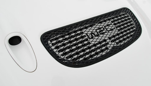

    I have added a WRC rain deflector plate to the large vent hole in the hood.

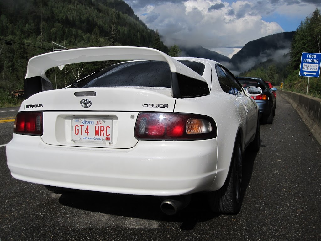

    I have added the late spec JDM tails, GT4 WRC license plate, and clear third brake light.
    I have added clear front turns and side markers.

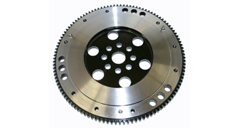

    Of course the whole reason it is in the shop is to put in my new clutch and flywheel. I'm having a clutch and lightweight flywheel from Competition Clutch installed.
    The clutch is a Stage 4 - Strip Series 1620 Clutch Kit. The 1620 Series kit includes a performance pressure plate, a six puck high torque sprung disc with Ceramic buttons. According to competition clutch, this assembly, available with a double spring, six rivet carriage is good for ease of gear transition with higher horsepower. This disc complimented by a performance pressure plate provides 250% increase in torque capacity. As for the flywheel, it is a lightweight steel flywheel that weighs approximately 12 lbs.
    At the same time I decided to install some HKS 256 duration cams with 9mm lift along with some ATS Racing adjustable cam gears.

    So car is back at home in the garage. Only drove it a few miles from the shop to my house and didn't want to drive it too hard. Stalled it out the 1st time trying to back up at the shop. Then stalled twice trying to get going forward. Definitely needed to get the feel for the Stage 4 clutch and lightweight flywheel, the latter is what I am blaming it on. After that though it felt completely fine and did not have issues with the clutch. I am actually shocked that it isn't a harsher engagement on the clutch. I truthfully can't notice a huge difference from stock.
    The HKS 256 cams definitely feel like they have added more mid to top end torque. The beast feels like it pulls very hard right to the red line. I am only running around 8-9psi boost right now, so I think I will really see the improvement when I turn up the boost closer to 15psi.
    Anyways, those are my initial impressions. I am going to take the car out more tonight to get some more miles put on it and see what I think of it. Will update more later.

    where did you get this WRC rain deflector plate :O
    Quote Originally Posted by ilmatic View Post
    I purchased the rain deflector on 6gc.net.
    Here are a couple new pictures that I took on the Ogopogo 2011 cruise.
    David Walker

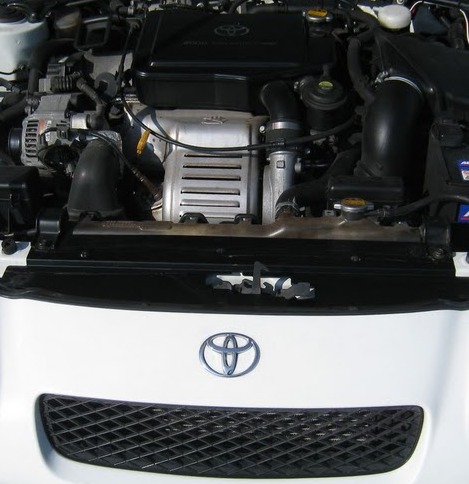

    Well it's about time I posted an update of my project. Over the past month I have been working on big changes for my car.
    I pulled my bumper off and started tearing parts off the car.
    I removed the WTA intercooler system to install a FMIC. I originally tried to install a large Treadstone TR10 intercooler, but ran into many spacing and sizing issues. So I decided to pick up a much smaller intercooler to simply get the car back together and on the road. I will install the TR10 this winter as I believe I will need that size for my ultimate power goals, but for now the small one will get me through the summer with limited boost. Removing all the WTA components was not a fun task, but it sure did remove a lot of weight.
    So once I finally got all that removed I started looking and decided that I should pull the ugly old brown radiator out of my car. So out came the radiator and a new Mishimoto was ordered. With the radiator out and lots of space in the engine bay I decided this would be the best time to pull out my turbo and my JP Autoworks downpipe.
    So with all that removed I had a bunch of space in my engine bay to work!
    Now the install began. I installed my new Precision 5857 turbo and downpipe. That went in smoothly with no fitment issues at all.
    Next was the radiator install, but that would not fit with the stock fans. So I had to order some new slim fans. I ordered two SPAL 12" puller fans and they were a perfect fit with the custom brackets I purchased from them. With them installed the radiator fit in with the new turbo.
    Next up was the intercooler. The small one (22" x 6" x 2.5" core) was simply to bolt on with some brackets mounted to the crash bar. The challenge is the intercooler piping. I ended up drilling a hole to run the intercooler piping through on the one side.
    The other side should be easy to get around as I have removed all the stock air box components. Where I am still struggling now is trying to fit the piping from the turbo past the thick radiator and downpipe as there is very little room in my engine bay. I hope to have that all figured out this week.
    The final pieces will be to get my interior all back together.
    I ordered some Prosport EVO series gauges (water temp, oil pressure, EGT, wideband) that I need to get installed. I also need to get my Gizzmo electronic boost controller installed.
    I am also going to be installing my PowerFC at this time as it should eliminate any errors I would have from removing the WTA intercooler system. It was made for the MR2, so it didn't have the WTA features. By installing this now I won't have to bridge the intercooler level sensor or solder in some resistors to the water pump harness.
    Anyways, that is where I am now. I hope to have some new pictures on the weekend of the finished product.
    David Walker

    Beautiful car! I'd love to own a white WRC one day. What made you decide to remove the WTA? And are you selling any of it?
    1992 GT-S // 1991 GTFour RC // 2007 Jeep Grand Cherokee CRD
    I love those rims.
    Quote Originally Posted by underscore View Post
    I personally feel that the intercooler gets heat soaked after a bunch of spirited runs. The 3S-GTE engine runs so hot that everything under the hood is way to hot to touch. I agree that WTA is better than an ATA from heat transfer principles, but I just have a tough time believing it is better cooling when it is so hot. At this point I am not planning on selling my WTA components, however that may change a bit later in the summer if I am happy with the FMIC.
    Another big reason I went to a FMIC is because I am installing my MR2 PowerFC and didn't want to have to do any wiring on the intercooler pump to keep it running all the time. With the system removed it will also allow me to easily change spark plugs and have access to the engine.
    I hope to some day be running high horsepower numbers, at which point I feel I will be exceeding the limitations of the stock WTA system anyways.
    David Walker
