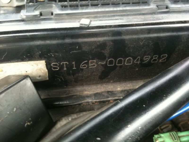

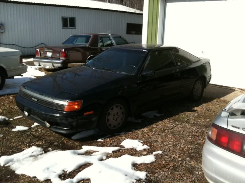

    We have been talking about taking Ellie (our ST185, my daily) off the road for a while now because she is in bad shape and needs lots of love. So, on a whim, we picked up this ST165 over the winter. It was purchased to be my new daily.
    We picked it up for a considerably lower price because the previous owner said the engine was knocking. He had done a compression test on it and the numbers were all over the place.

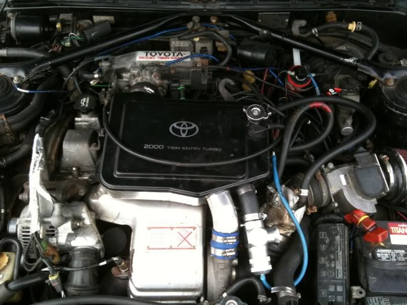

    It has a 2nd gen 3sgte swap in it, with an st205 intercooler core, an aftermarket heatexchanger, and a 50 trim CT26. It also has a Motoria full 3" exhaust with the single tip. Otherwise, it is mostly stock.

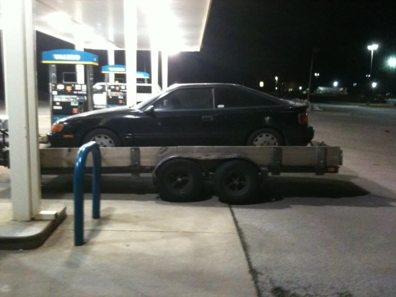

    On the way home from Indiana where she was picked up.

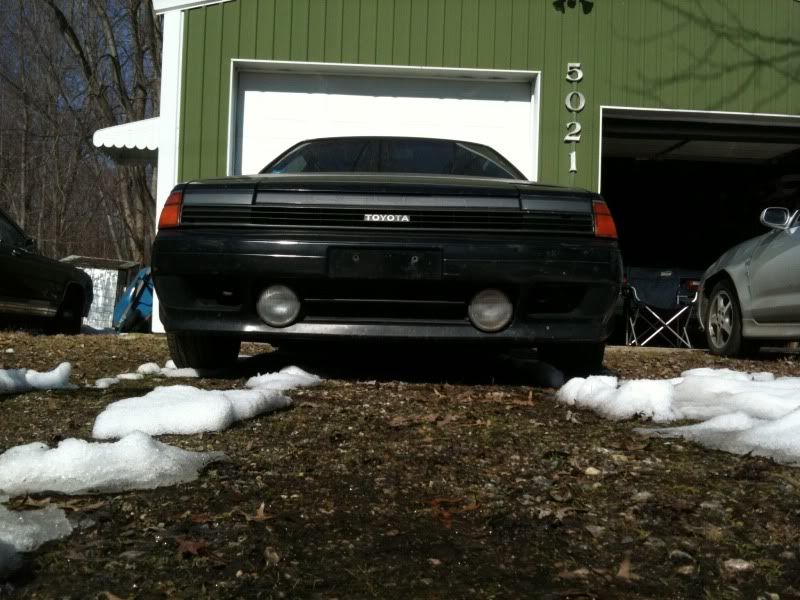

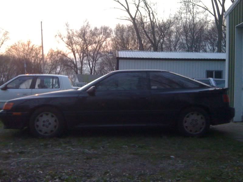

    Some pictures once we got her home..

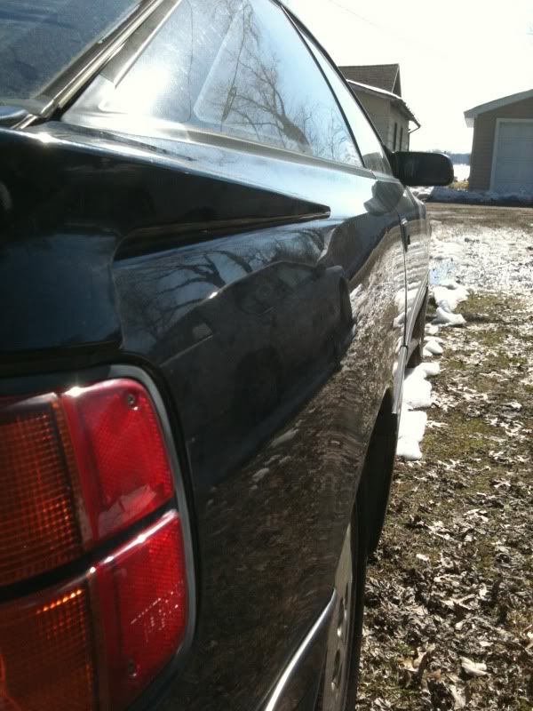

    She is pretty clean, with only two quarter sized spots of rust on the underbody..

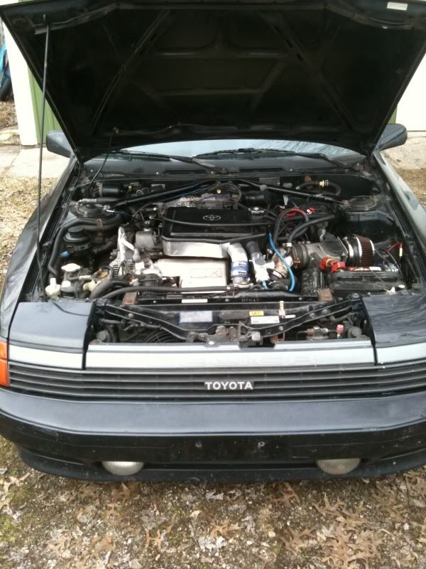

    Under the hood..

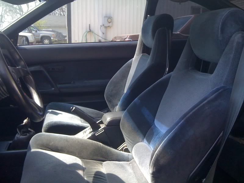

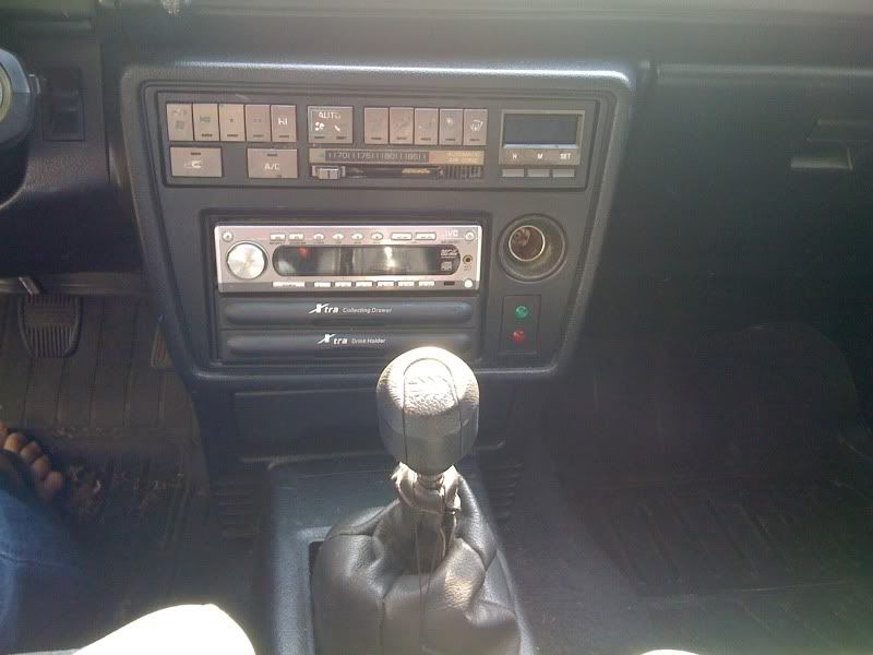

    Some interior pics...

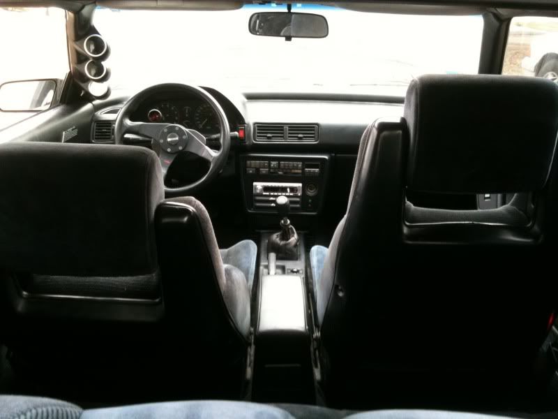

    The pillar pod Prosport gauges (I've never been a fan of this location for gauges, so I may have to get creative on this...)
    This stereo and all the audio will be replaced with a full Eclipse system (after all, I am the Audio Sorcerer's Apprentice, right )

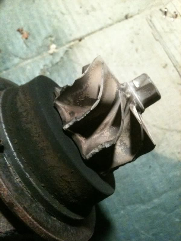

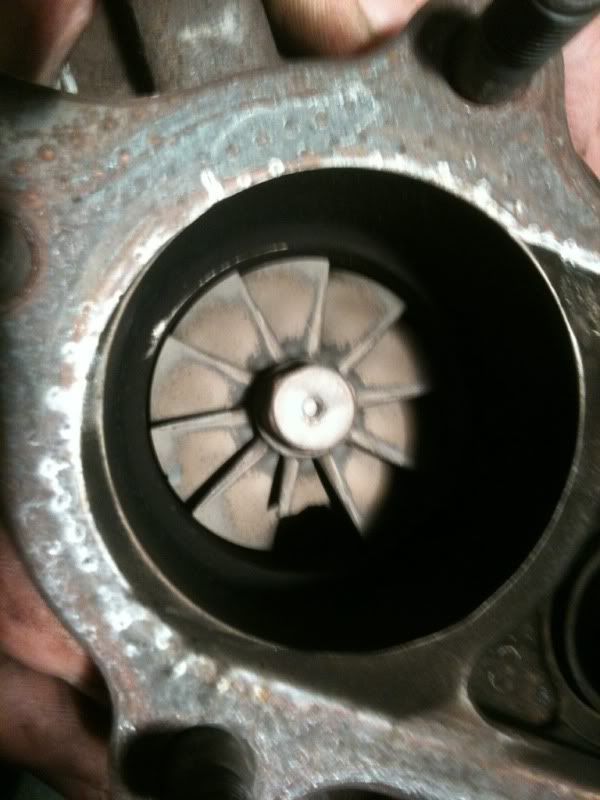

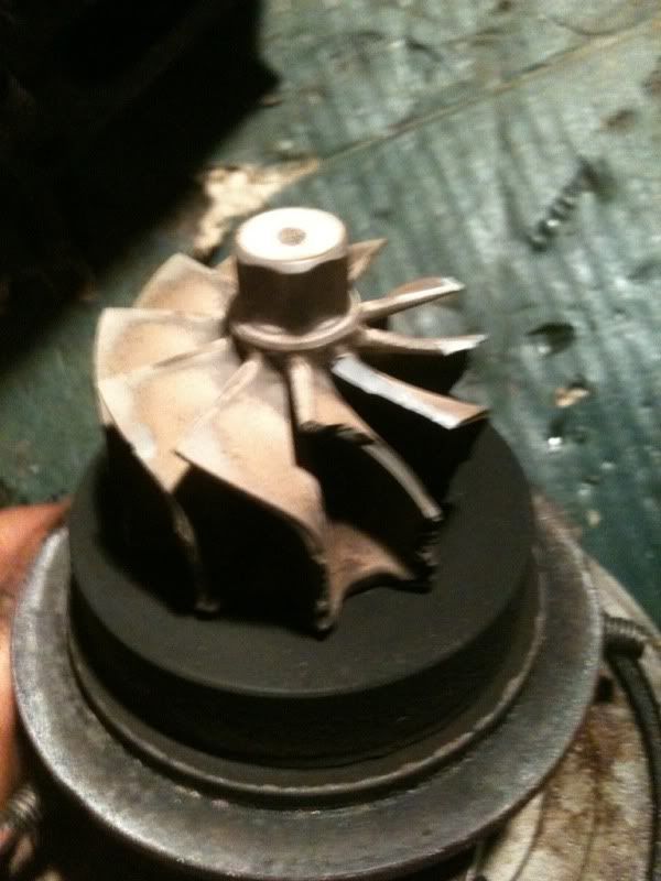

    So, the previous owner said the motor was knocking. When Chris went to pick her up, it sounded more like valve tick. By the time she was trailered home and started up, the sound wasn't very audible anymore.
    It takes multiple tries to start her up, and sometimes she will idle fine, sometimes not. After taking her for a spin, the car has zero boost. Once Chris had a chance to pull the turbo, this is what we found...
    We decided that we would replace the turbo and see how things went. After purchasing a gasket kit for the spare CT26 that we had laying around, Chris got the turbo on this past weekend, so we took her for a drive around the block, and she seemed to be running decent UNTIL she got up to op. temp.
    (Quoting from Chris' thread here)
    She was running rough at idle, stalling when the accelerator was pushed, etc. So, we pull her back into the barn and open up the hood to find oil EVERYWHERE. It was coming out of the BOV and putting liquid oil all over the engine bay.
    So, the next step for us is a compression test, hopefully later this week. At this point, we're basically expecting to have to rebuild the bottom end. And if that's the case, we may be pulling the motor from Ellie and dropping it into Patty to get the ST165 on the road and the ST185 off the road sooner rather than later.
    I guess the good news is that when things break, it's more of a reason to upgrade, right?

    I just got home from working on Patty and the compression at operating temp across 1, 2, 3 and 4 are 150, 150, 150, 120 respectively. I thought that these numbers were alright (I know that they are supposed to be 180), so I took her for another spin.......
    We've officially got rod knock. Its not very audible when you are just putting around, but when you get on it and at higher RPM's you can clearly hear the knocking. Also, we've still got oil coming out of the BOV so I think that we may have a bad ringland on cyl.4 as well....
    So much for an easy fix....

    Glad to see that car stayed in the community! At least in the end, it's all fixable. I'd say your diagnosis is probably right. New/rebuild bottom end I spose.
    Is that turbo a ct26, not a ct20b?
    Also out of curiosity, do you know if it is running the ST185 ECU, or if the P.O. used the 165 one?
    Did they know what might have caused the issue in the first place?

    We were glad to keep it in the community as well. We hadn't planned on purchasing another one so soon, but when gpmarzan's (AT.net) came up for sale, things just fell into place.
    Definitely a CT26.
    Chris (bloodMoney) will have to answer about the ECU, I'm not sure at all. I also don't think the PO knew the exact cause. He wasn't completely sure that it was knocking, but he was upfront about everything when he sold it to us.
    The lesson we learned previously (with Ellie) was to buy one with NO rust since neither of us has much experience with body work. With my knowledge of electrical, and Chris' mechanical experience, dropping in a new motor is a whole lot easier than dealing with rust issues.

    I wonder if a piece of piston found it's way through the turbo to cause it to break like that. If you do find it's the 165 ECU, might be worth switching to the 185 one as it's tuned for the higher compression engine and would be somewhat safer. Looking forward to watching this project!

    I hate to say it but I had the same thing happen a while back and well those peices of turbo like to make a mess of the engine. Ceramic CT26 does that when they get over boosted.
    Might find some damage like pics in post #19 http://www.celicatech.com/forums/sho...ight=rizin%27s
    I strapped a cheap turbokit on and ran good but the rod knock was the end.
    Can't wait to see what is to come from this build.
