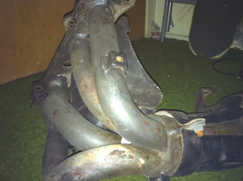

    Thanks to Hookecho I now have my 97' Camry header. (March/April 2011)
    It'll be getting put on tomorrow so that my exhaust guy can move my front cat the necessary amount. Sometime in the next few days it'll be taken back off, sand down and painted black with some 2000 degree VHT.

    The camry header from what I have heard, will give you a slight, maybe 5hp increase. It will also extend your powerband just a hair.

    From my memory, I believe it is a 95-99 camry header. Easy to spot, 4-1 style header.

    you will need a 97-99 camry header, the 95 is the same we have now on our cars.i have a thread with pics of my install/exhaust fab that needs done in the n/a forum. some where.......

    That bolt hole in the middle is where a engine hook bracket is suppose to go, and its also suppose to hold onto those 4 spark plug wires I believe.
