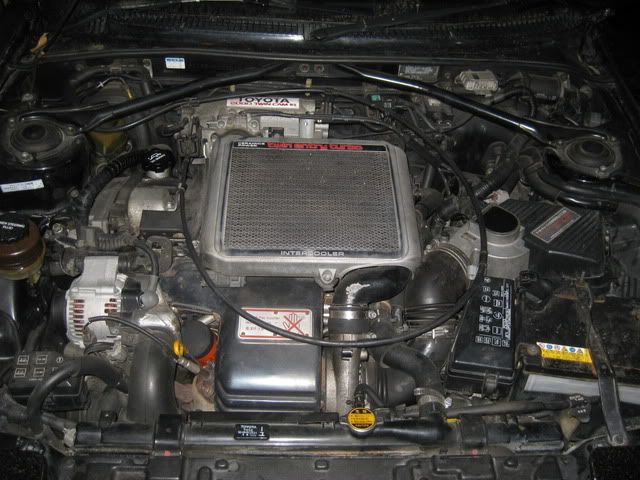

    Anyway, here's my 162 and the eventual home of the 3SGTE:
    The transmission from the donor is royally screwed and we'll be using mine from the 162 (which is actually a JDM 5th gen anyway).

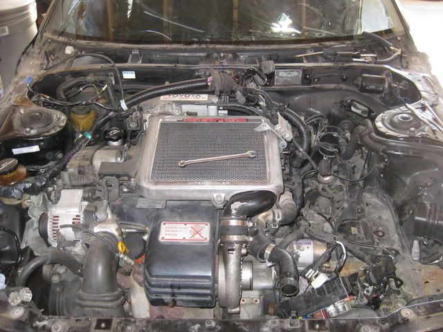

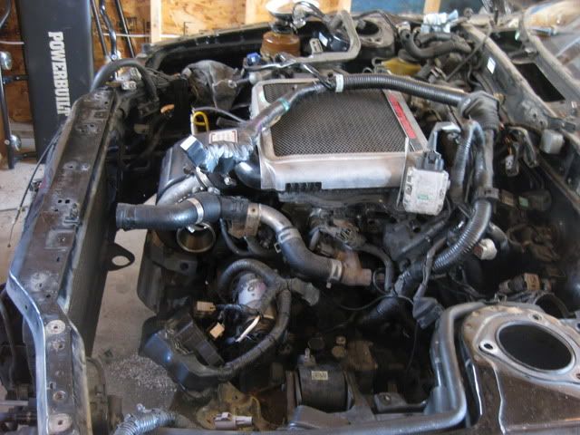

    This past weekend we were able to start working away at the engine. Over the course of the past few days we were able to remove the engine completely. Removing the exhaust and the damaged axle proved to be a bit of a challenge, but we were able to accomplish our goal for the weekend:
    Ready to begin:

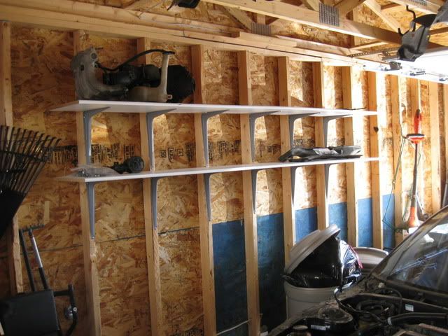

    The project actually began late on Friday night when we installed some shelving in Chris' garage. Running a pseudo chop shop takes up a lot of space!
    Removing everything:

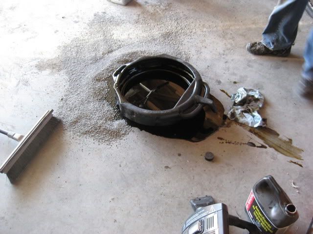

    Chris had an overflow problem with a used oil container, so I decided to take a picture rather than to actually help:

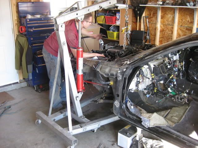

    Ready to remove the engine. After trying to lift it up unsuccessfully, we dropped it instead:
    Woo! She's out. Big step completed:

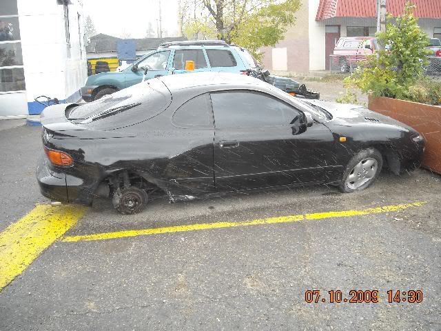

    We got together on Thursday night and intended to remove the glass and cut off the roof of the donor car, but we didn't have the right tools to remove the windshield and side windows. As you know from the previous update, we dropped the engine so what we did finish on Thursday night was cutting off some of the bracing of the front clip to slide the engine out so that we could access and work on it easier.
    Today we made a quick stop at Princess Auto and got the right tools to remove the glass.
    We did our absolute best to keep the windshield in its perfect condition, but we quickly learned that working with auto glass isn't the simplest of jobs. We got the windshield out, but it suffered cracks all over the place when we were finished. Oh well, life goes on. But we were able to successfully remove the two side windows and keep them intact, despite the ridiculous amounts of epoxy that were holding them in and the failure of our removal tool near the end (the blade that goes underneath the glass to cut the glue snapped off while in use).
    Once that was complete, we busted out the sawzall and made short work of the roof. The 185 was converted into a sporty convertible!
    Of course, we did more than just the cutting of sheet metal. In addition to that, we were able to remove various interior accessories (e-brake, seat belts, etc), the remaining door and window, brake lines, as well as the gas tank. That was a plus in itself, as it gave me with a full tank of fuel for my truck!

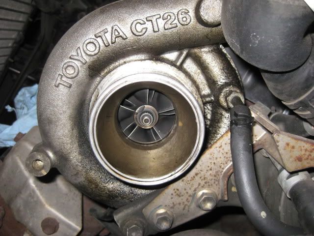

    Chris also tackled some work on the engine. He removed the intercooler, downpipe, and noticed that the spark plug wires were originals ('92 stamped).
    All told, it was an extremely productive day. Only a few things left to remove from the rear of the car (rear differential, exhaust) and then we can cut this thing all apart and make several trips to the dump/metal scrapper. Here are a couple pictures to show just how bare this thing is looking. Soon my 162 will makes its way into the garage and the swap will truly get to an exciting level.

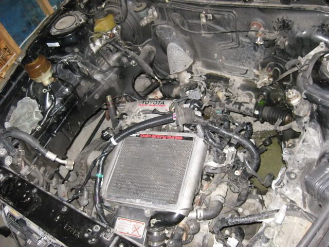

    Another productive evening in the chop-shop and we're starting to see the end of the part-out.
    Here's what we accomplished in a couple hours tonight:
    - Removed miscellaneous parts from the engine bay (power steering reservoir, AC hose, etc) to just have metal left.

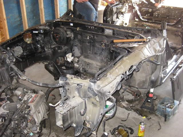

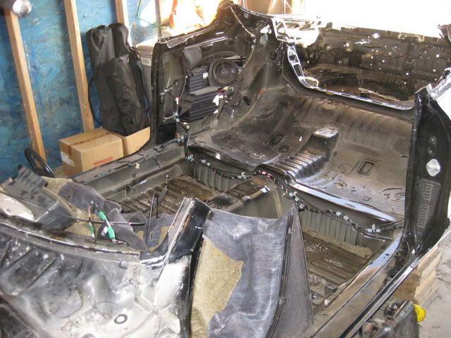

    Tonight we got some more done. We cut the firewall in half to make the pieces more manageable for the dump trips. It went fairly smooth, but it got a little difficult with that 90 degree turn, as that also happened to be where the greatest layering of metal was. Only two more cuts to make and I predict they'll go pretty smooth.
    Here are a few pictures. It's looking less like a car skeleton and more like a heap of metal now - and that's what we want!
    When liquid wrench doesn't do the trick, you need to bust out the heavy artillery on these exhaust bolts:
    Tomorrow we need to remove the sub-frame and then make the final cuts. After that, we'll disassemble a few things (transmission for the dump and the rear diff for selling) and we can make our series of dump trips on Saturday. Our goal remains the same...have Chris' garage full with two running vehicles by Saturday night. We should be able to get it done.

    It was a very rewarding past couple of days. Chris and I stayed up relatively late last night finishing up the removal and cutting of a few pieces. We were probably the first people in the world to do this series of events:
    - Remove the sub-frame so we could remove the exhaust
    - Then lift the entire rear shell away to reveal the sub-frame (and so we could cut it up easier...you'll see in the pictures, lol)
    The pictures aren't great because of the sunlight that was lighting up half the garage, but you get the idea of how it looked this morning before we carted things away.
    Three truckloads took care of everything - two to the metal scrapper which gave us a cool profit of $30, and one to the dump which set us back $26. We netted $4 bucks out of it! As long as we didn't have to pay anything, we were happy.
