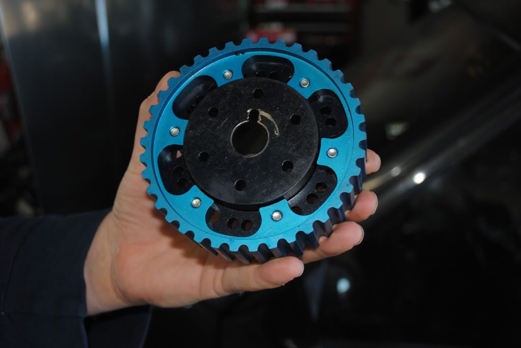

    1993 volvo 940 turbo wagon, 2.5L stroker crank, forged lightened pistons and rods, dohc head, big ol' turbo, 1000cc injectors and megasquirt stand alone ems...among other things.
    About a year ago it ran, and then the exhaust valves bent
    We pulled the head, cleaned things up, put a new one on and then...nothing. the car just would NOT run. well we figured out what happened today (took about that long for fresh people with slightly more patience than I to get around to looking at it)
    It turns out the same thing that bent the valves was keeping the motor from running and it just never got discovered until now.
    cam locator pins are important mmmk?
    Turns out while running the first time the pin sheered, the exhaust cam gear turned 90degrees and bent the valves in the process but then stopped in a position where once we put the head on the cams could be timed up to what appeared to be proper timing
    Anyway, it runs now and there truely are not smileys to describe how happy I am.
