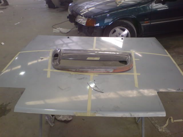

    STEP 1. MEASURE!
    Decide where your vent will sit. Start by measuring out the middle and marking both the horizontal and verticle halfs with either tape or a marker and ruler. Then once you know where it will sit, draw an outline onto the bonnet.
    You then need to decide how big the hole you will cut is relative to the scoop itself. This will vary and youl need to make your own judgement on this the factors you must allow for are that you have enough area for the scoop and hood faces to meet and create a good seal, How much you will be cutting into bonnet supports and obviously over all appearance.
    i cannot stress how important the measuring is, measure 10 times if need be because once you cut, you cant go back.

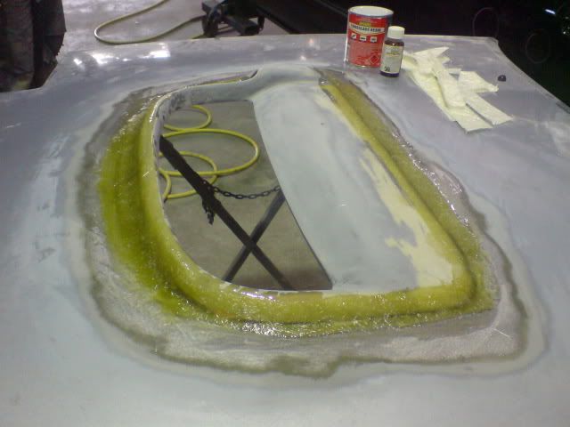

    At this point i advise rubber gloves, its about to get messy. Begin cutting up your glass matting in thin strips. The key to getting this right is a gradual build up of glass. it needs to be solid. The matting needs to be able to fit in all the nooks and crannys not just the resin.
    After cuting to shape the matting its time to start with the resin.
    Add the catalyst to the resin as per instructions and mix it up. Apply the resin to the bonnet liberally then lay down your sections of matting. Apply another healthy dose of resin on top. Push the matting down flat. The secret to a good fibreglass job is to ensure there isnt any air in there. Air bubble will cause cracks further down the road and can cause the layers to seperate.
    Build up the shape slowly, layer by layer. As soon as your resin begins to set STOP. the moment it start going tacky all you will do is ruin what you have done so far.

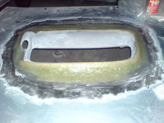

    at this stage mine looked like this
    Let it set over night, if it needs more it can wait till tomorow.
    If more is required ( mine needed more) sand the new glass back to 80g, wipe away dust and repeat the process.

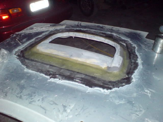

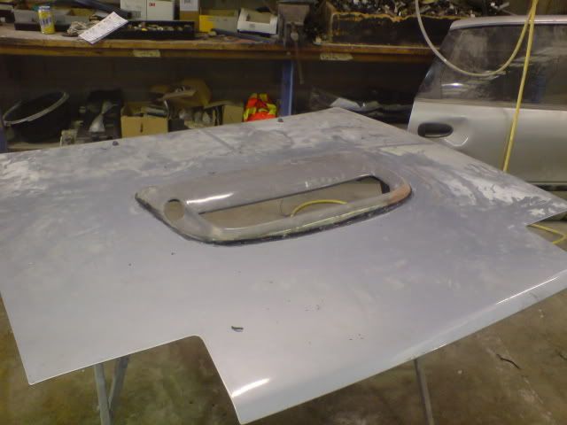

    my bonnet then looked like this

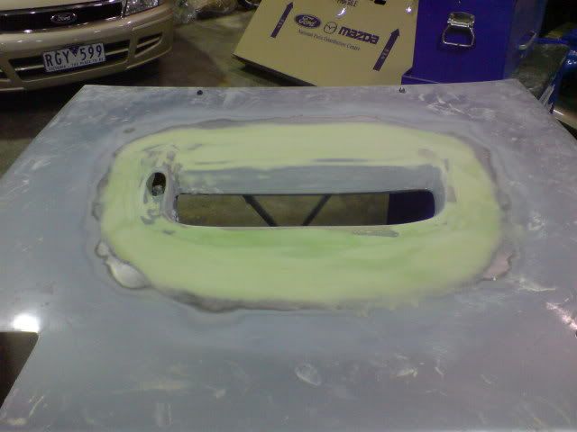

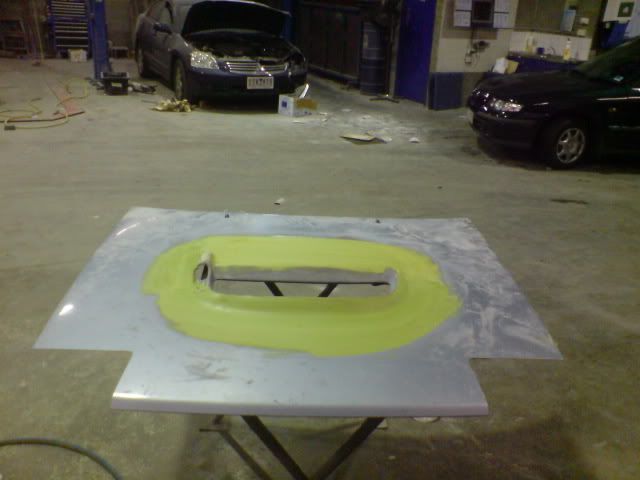

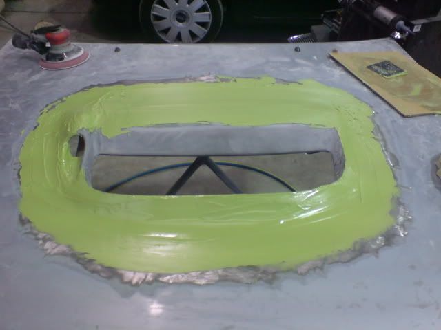

    this is a picture taken inbetween coats of filler after i felt a few lows
    another coat
    stupidly didnt get any more shots of the filler work then that.

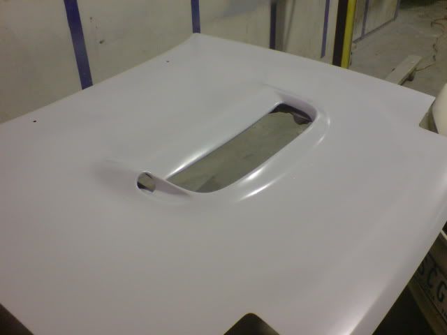

    once done give everything a light rub with 240g ready for High Fill.
    STEP 8. FITMENT
    after a coat of paint its time to fit to the car but before you do so. now is your chace to fit your mesh (if you so desire).

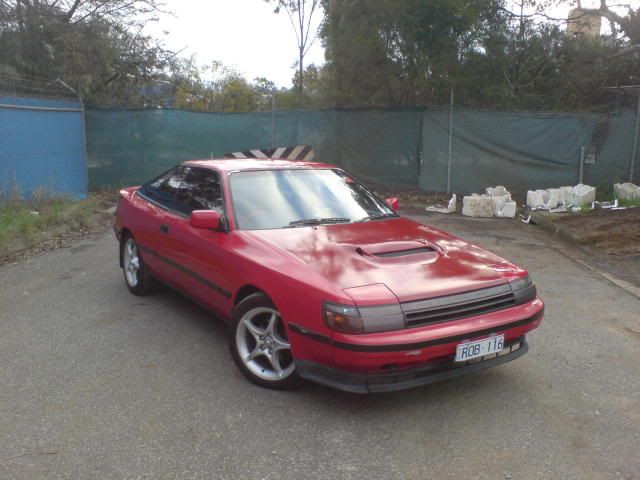

    Now bolt that sucker up, allign it and be proud of the hard work you put in.
    PLEASE NOTE. you may notice i didnt cover anything about the underside. i didnt get a chance to finish the underside as i would have liked. My boss cracked the shits and said he wanted the bonnet out of his shop and as a consequence i never finished the underside, when i do i will update.
    also yes the colors wrong, was just left over paint at work and i was broke lol

    wow, final pics are awesome
