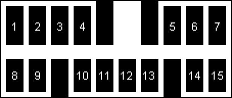

    Default Toyota radio harness assistance
    Ok I got asked about the toyota harness adapters and the person that asked for it said we should have a write up. And since picutes are worth a thousand words.....Here is two thousand words!
    Remember to use the best connections and insulation that you are capable of (Sodier and heatshrink is the best)
    David

    Do you have a factory harness in the car, or was it all chopped apart?
    If you have the factory harness, use:
    70-1761 - TOYOTA 1987-UP - INTO CAR
    If not then cross match the wires to this:
    1994 Toyota Celica Stereo Information
    Constant 12V+ Blue/Yellow
    Switched 12V+ Gray
    Ground Brown
    Illumination Green
    Dimmer n/a
    Antenna Trigger Black/Red
    Antenna Left Rear
    Front Speakers 6 1/2" Doors
    Left Front (+) Pink
    Left Front (-) Purple
    Right Front (+) Light Green
    Right Front (-) Blue
    Rear Speakers 6 1/2" Side Panels
    Left Rear (+) Black
    Left Rear (-) Yellow
    Right Rear (+) Red
    Right Rear (-) White

    I bought a new head unit recently (pre: not amplified) and want to use the factory amp in my 1995 Celica. The connector coming going into amp looks like this:
    Colors are as follows:
    1: Green/Silver dots
    2: Yellow/Silver dots
    3: White/Silver dots
    4: Black/Silver dots
    5: White/Silver dots
    6: Red/Silver dots
    7: Green/Silver dots
    8: Red/Silver dots
    9: Blue/Silver dots
    10: NA
    11: White/Black stripe/Brown dot
    12: Brown/Silver dots
    13: Black/Silver dots
    14: Yellow/Silver dots
    15: Blue/Silver dots
    They have taken 2 cables (6 leads in one, 7 in another, plus a ground = 14) to connect the two ends. Pin 11 is ground, at least in this cable. I bought this car used and am replacing an aftermarket P.O.S. head unit (which was alreayd amplified, so they bypassed the factory amp altogether), so this cable may not be the one that came with the factory stereo, but I'm thinking it is.
    What I would like to do is chop one connector off and connect the leads straight to the leads on my new unit. Anyone know which leads are which? Help!!
     ...to the topTop
