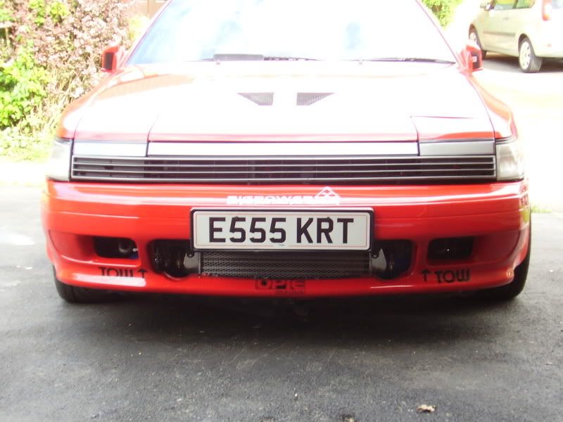

    nice power out of a basically stock motor

    Cheers guys, the aim for the engine, is to keep it reliable, and responsive on track. Bigger power, would mean greater risk. ( bottom end has done over 100k miles), plus my sprint championship is not just about big power cars, its how you use that power, and drivability. On track mine responds like a big n/a car, with very little lag, and a progressice power delivery, great for carrying speed through corners.
    I gained over 20bhp, from the ECU, I think one I have uprated the fuel pump and gone to 1.2 bar, ultimate power will be closer to 300bhp, which will suit me fine.
    As it stands, I can launch the car at 5.5k and often beat much higher powered ST205s, as they can take a bit of time to get on boost.
    My flat shift system will help me make the most of the power too.. keeping the turbo just in the sweet spot.

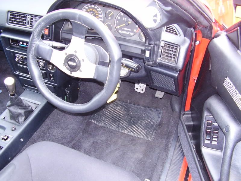

    The magic switch, crap pic I know!! but its so much fun when activated...
    I dont run the flat shift system on the road as its pretty damn hard on the turbo and manifold, but on track it should make a huge difference.
    It also sounds proper sexy, like a mini rally car....

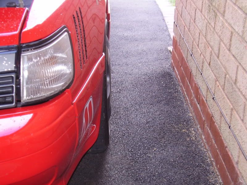

    Was a lot of work to avoid rubbing on the front wheel arches with my R888s on, still not convinced it wont rub out on track but, we will see.

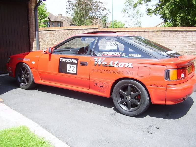

    280bhp Gen 1 3SGTE. Haltech E6X ECU, Hybrid, FMIC, cold air box, Evo injectors, mocal coolers, Adj Suspension, ST205 g/box,
    ST185 group A rear LSD, St185 brakes, FIA bucket seats, Compomotive Rims, Toyo R888 Semi slick tyres
    Sprint and track day car. No 22 in the Toyota sprint series. Making sure that the 4th gen is respected.
    Sponsored by Red Rocket Performance and design.

    Ha ha, until the last pic I was wondering why you had the switch to the right of the coin holder. Then I remembered that was the correct side for across the pond. *smacks self*

    Ha ha, its funnywhen you look, there are so many coin slots you can pop out and use for other switches, 4 in the centre console, and then 1 further one in the lower dash. I think toyota UK were obsesed with drivers having enough change!!

    Oh, we have them all too. I just put a switch in the left one because that's the correct side for us.

    hey i never noticed before but your centre console is a different design/shape to mine.
    this is mine
    is that a pre/post facelift, 165/162 diffenernce or Countrys? as i said iv never noticed it before
    P.S. please excuse a filth, its been to cold for me to go outside and clean it lol
    it may be a pre post thing, as I am sure 162s of the same age as mine have similar consoles.

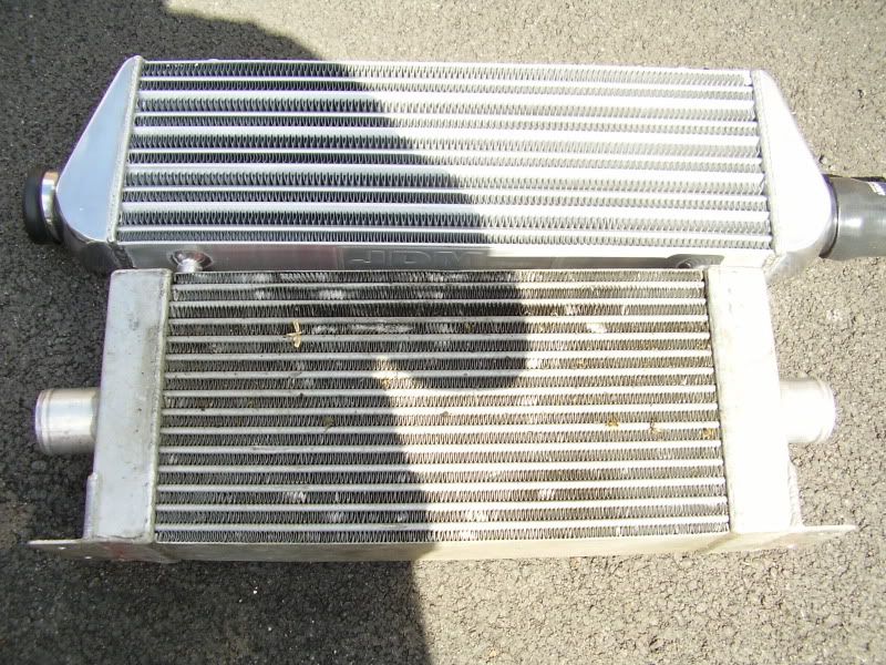

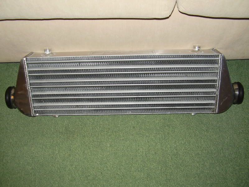

    tried to get a decent custom sized intercooler from a regonised supplier. not a hope, all on back order. Grew desperate and finally sourced this one for pretty little cash.
    not fantastic, but as was on a tight budget it was the way to go.

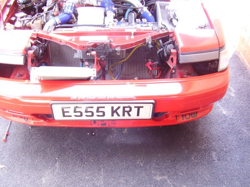

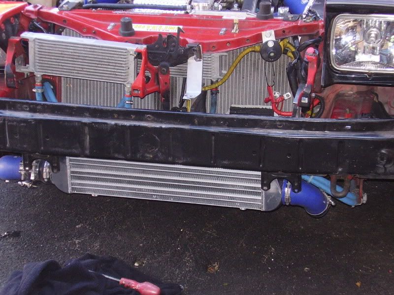

    Fitted it this weekend just gone.
    old vs new
    The other coolers you can see are for the gearbox and the PAS.
    I was quite pleased with the overall fit.
    When I get time, I will make up some blank plates for either side of it.
    I have added some mesh to protect it from debris
