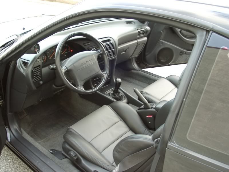

    I only have this one pic of reinstalling the interior, mostly the stereo install. . .

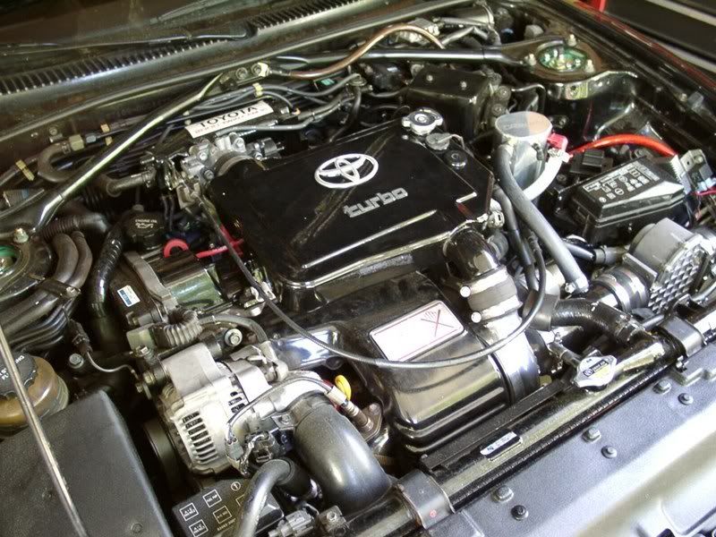

    Couldn't put the oily old lump back in, so off to NAD Auto to buy a front clip. Found a clip with 36k miles on it! Here's the clip after I removed the engine/trans. Took only a few minutes with a Sawzall!
    The "new" engine!

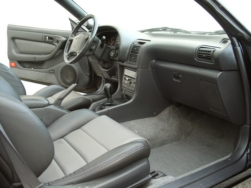

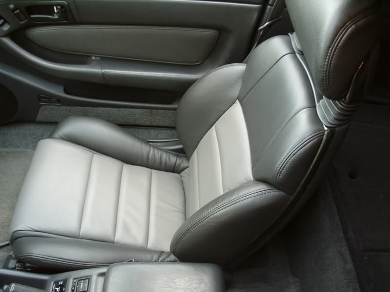

    Time the interior to get it's makeover. . .
    The driver seat bolster was just starting to get a hole in it. Time to cough up the cash for an upholstery job.
    Keeping with the subtle, classy theme I decide to go an understated two tone. Katskinz leather had the colors I wanted. A local upholsterer did the work.
    Although I had the front and rear seats redone, I decided the rear seats to be useless. I fabricated a false floor in the back under which the battery and amplifiers reside. Removable panels allow easy access to both while adding to the utility of the rear area.

    Engine config as of March 22, 2015

    Engine:
    JDM 3SGTE from clip. 36K miles, new seals, belts, pump, timing belt etc.
    CT20b turbo: black powder coated compressor
    TVIS butterflies removed, holes heli-arced, port matched.
    Valve cover black powder coat
    Intake manifold black powder coat
    RC/CS water to air intercooler, black powder coat
    RC/CS proper motor mount and hard pipe water lines
    RC/CS proper starter(smaller than US for hard pipes clnc)
    ST205 pump/with relay
    ST205 front heat exchanger/shock mounted
    TRD plug wires
    Exhaust manifold black ceramic coated
    Turbo heat shield black ceramic coated
    Custom cold air intake with K&N filter behind fender liner
    3 inch SS turbo back, mandrel bent exhaust with oversized flex section
    Random Technologies catalytic converter
    Magnaflo SS muffler
    Blitz Access ECU
    Blitz type R dual solenoid boost controller
    Greddy turbo timer (not connected)

    Interior
    Leather seats recovered using Katskinz leather
    triple gauge pod with boost, EGT, Innovate Motorsports AFR
    TWM short thro shifter
    TRD shift knob
