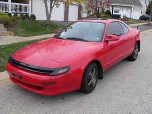

    only picture I have right now...
    paint is bad/faded on a lot of the car...IDK what I'm going to do with that. I'll probably just keep it...who knows..

    Your paint is single stage. Just polish and wax it and it will look much better.
