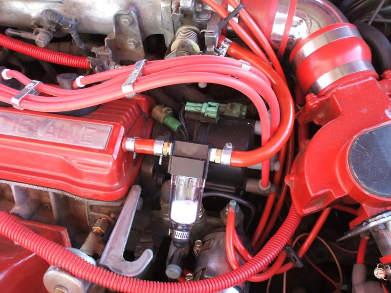

    Finally got 'er, had to go to a Home Depot like 8 miles away...
    Installed 8/19/08.

  10. #35
    BEAUTIFULLY DONE ! That is a super clean install and a great example.
    Thank You
    -Mario

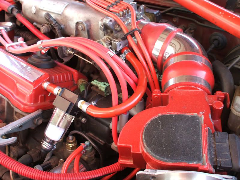

    Update Pic:
    As you can see, not much collected. Only about a 1/4" at the bottom with a small amount in the filter material itself. I'm happy.

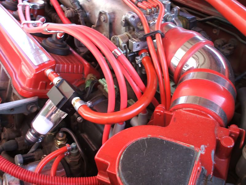

    Oops, I'm a day late... Oh well.
    Huh, not as bad as I thought.
    Well, it is at an angle, I should turn it. Uh-oh...
    Oh dear god!
