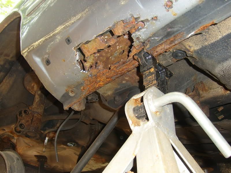

    March 15th 2007 - Rust removal begins.

    April 15th 2007 - Started rust removal process on the rear of the car. Removed rear tail lights, rear bumper, dropped the fuel tank. Really bad rust on the fuel tank. Looks like I'll be making some custom fuel lines in the future.
