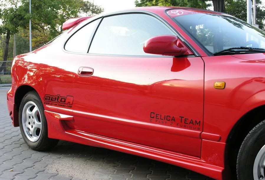

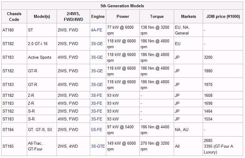

    I. “What Makes My Celica Different?”
    I’ll start with chassis and trims. If you’re going for a stock look this is where you should start. Chassis and Trim decided what engine and drive your Celica came with. Also dictating aesthetic options like painted mirrors and molding (Some ST’s were given the dealer upgrade of matching the mirrors and door moldings.) or Mud flaps and stock spoilers.
    *image taken from Wikipedia.

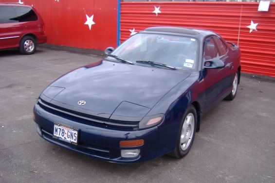

    II. “How Did My Celica Look On The Showroom Floor?”
    A great question to ask yourself. The biggest mistake I see with body mods is people putting expensive FRP, Urethane, or Fiberglass body kits. Over faded, scratched, dented overall weathered bodies. They usually defend it with “I’m painting the whole car anyway” Whereas a decent OEM replica paint job will run you $5000 or more when 80% of us can restore your OEM job and paint match your new body panels for around 3-500$ or less depending on your knowledge or shop access.
    Clean your car! I can’t say this enough. These projects can be done over a Saturday afternoon or a weekend by Taking out all of your interior panels and carpet, giving the entire interior a deep clean. Wet sanding, clay baring and buffing your paint .I’ll explain all of this in detail later. Each of these projects will yield you great results over minimal amounts of time. They will make you more comfortable in your car and give you a great sense of accomplishment when your friends don’t believe you that your car is 16 years old!

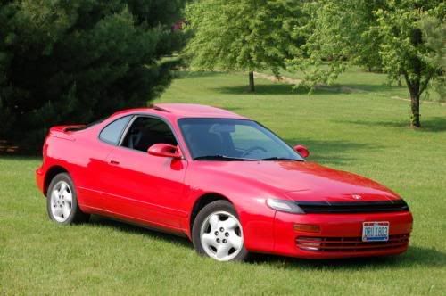

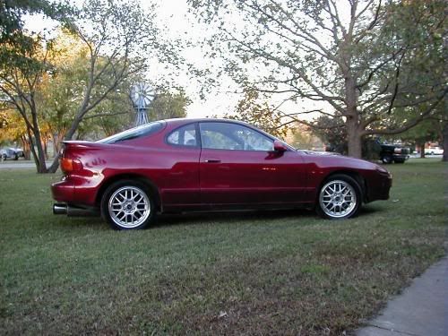

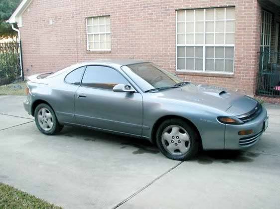

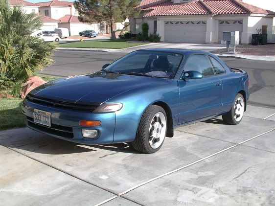

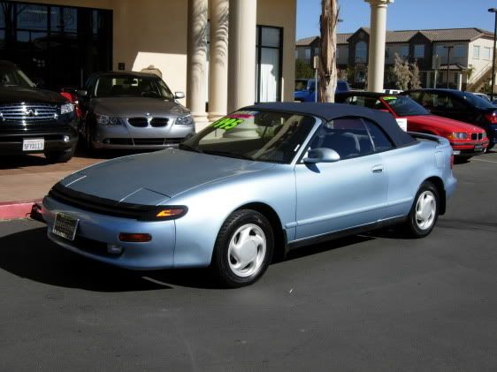

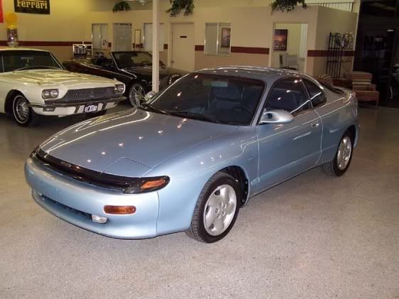

    Here is a list of OEM paint codes I’ll try to follow them up with a picture of them actually on a celica. I prefer to use forum Members cars so If I’m missing a pic of your car. Please private message me with a photobucket or album of your celica pics and I will add them.
    *Find paint codes for all gen celicas at http://www.toyotareference.com/#CE
    Almond Beige Pearl. 91’-93’
    [IMG]http://www.toyotacelicaonline.com/amanda/4.jpg[IMG\]

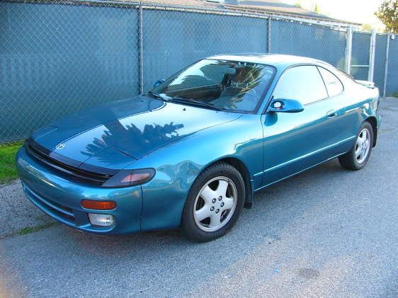

    Aquamarine Pearl. 92’-93’

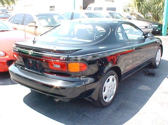

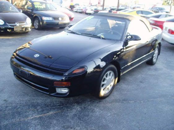

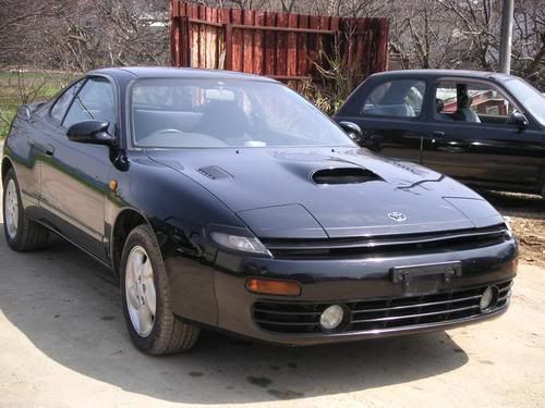

    Black. 90’-93’

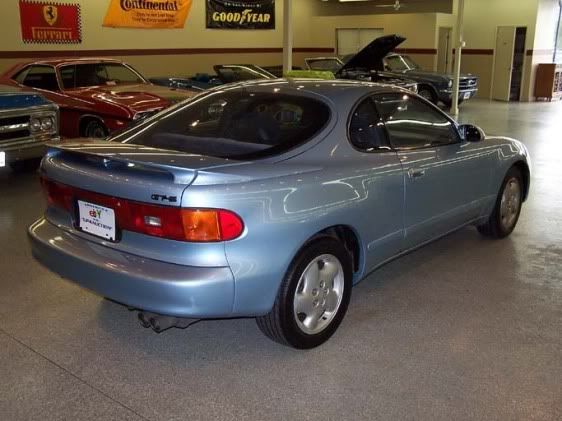

    Bluish Grey Metallic 90’-93’
    Dark Blue Metallic 91’-93’
    Light Blue Pearl 91’-93’
    Medium Blue Pearl 90’-91’
    Medium Red Pearl 91’-93’
    Prussian Red Pearl 92’-93’
    (Need one!)

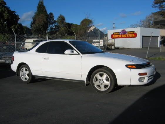

    Super Red 90’-93’
    Super White 90’-93’

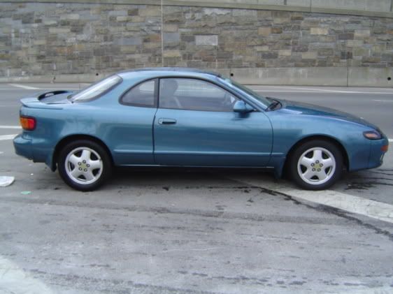

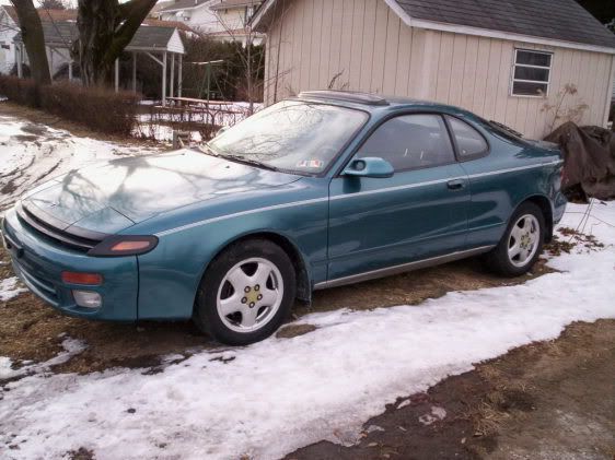

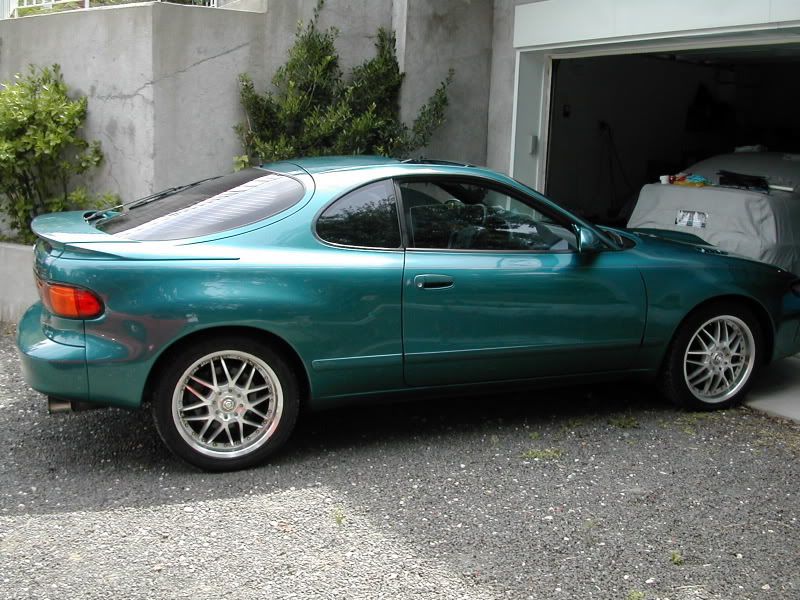

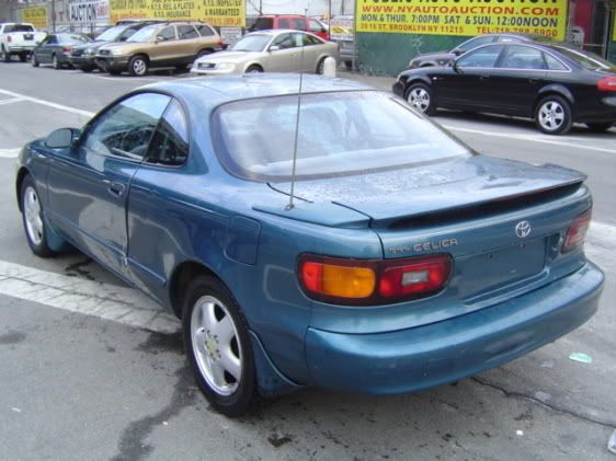

    Teal Metallic 92’-93’
    Turquoise Metallic 92’-93’
    (I’ll eventually try to get pictures of all colors in Coupe, Hatchback, and Vert trims. I would love to get them in Alltrac and CS also if possible. I may add euro and Japanese colors to the list later)

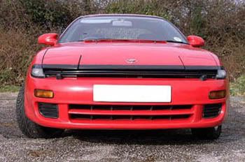

    *Front Fascias (They are more commonly referred to as bumper cover or Fascia because unlike classic cars they are simply a cosmetic front for the crash bar behind it that is the real safety point of your front bumper assembly)
    90’-91’ AT180, ST184
    Part #: 52119-20914
    92’-93’ AT180, ST184
    Part#: 52119-20931
    90’-93’ ST185 (Also came equiped on the ST184 GT-S 92'-93') - addition by Grayscale
    Part #: ?

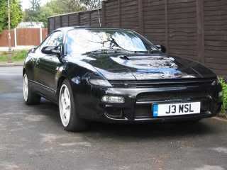

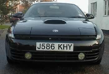

    90’-93’ Carlos Sainz GT-4 (CS or RC)
    Part #-
    Fascia: 52119-20929
    Reinforcement 1: 52021-20210
    Reinforcement 2: 52029-20020
    Inserts-
    Left Vent: 53104-20030
    Right Vent: 53103-20030
    Grille-
    Top: 53101-2004
    Bottom: 53102-20030
    w/ Fogs
    90’-93’ JDM St185
    Part #: ?

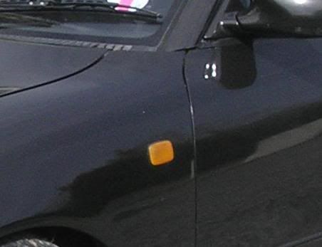

    **Lighting
    90’-93’ OEM side markers (Never available to the US)
    Part #: ?

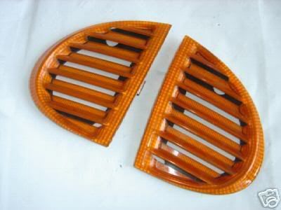

    90’-91’ JDM Tail Light Vents.
    Part#: ?
    92’-93” JDM Tail Light Vents.
    Part #: ?
    ****http://www.celicatech.com/forums/sho...ht=vented+tail
    A thread concerning part numbers for the tail light inserts.

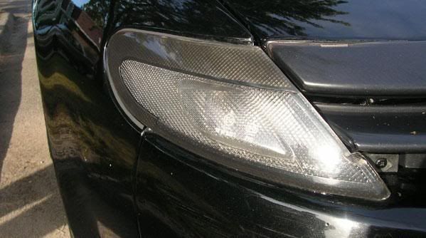

    90’-93’ JDM Corner Lights.
    Part #:
    Right: 81610-20391
    Left: 81620-20391

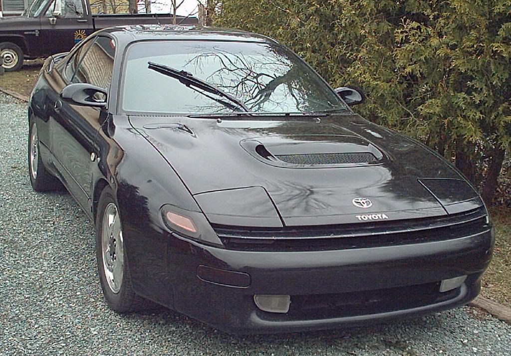

    90’-93’ All-Trac
    Part #: ill post it in a day or Alltrac.net’s part number page is down.
    http://i148.photobucket.com/albums/s...g?t=1176165333
    90’-93 GT-4 RC
    Part #: Same as above.

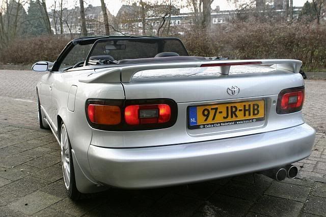

    OEM 3 Piece Liftback Spoiler
    OEM 1 Piece Liftback Spoiler
    OEM 3 Piece Coupe spoiler
    OEM 1 Piece Coupe Spoiler (Grayscale just informed me of it's existence so I will add a pic as soon as I can find one)

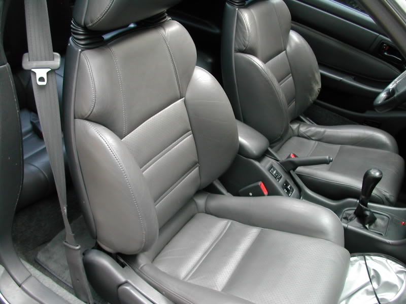

    ****Interior! (Almost at the end!)
    Your OEM 5th gen interior came in 3 flavors.
    (These aren’t the best interior shots, So get yours spotless and post up some pics!)
    Charcoal Grey
    Wine Red
    Ocean Blue
    Very few interior changes took place between the years, The steering wheel in All-tracs say “All-trac” on them. The GT-S and AT models came with thicker bolstered seats and vinyl backs. They were both also offered in a leather package. GT-S and AT also came with automatic climate controls. Gauge cluster for the GT-S came with an additional voltmeter and AT’s came with boost in it’s place. IIRC.

    There was a darker blue interior on the fifth gens wasn't there?
    Ultimo Miembro Fantástico Gigantesco PhillyDRFT will become famous soon enough PhillyDRFT will become famous soon enough PhillyDRFT's Avatar
    May 2005
    Philadelphia / Bristol PA
    1,402
    Quote Originally Posted by 1990CelicaGT-S
    To my knowledge they all started the darker blue but the test of time turned them into the light blue were all acustomed to.

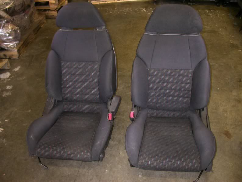

    Um, I've got some JDM Celica Seats that were a different color scheme than the ones shown above:
    Here is an interior shot

    That would be the charcoal grey wouldn't it? I'm acctually sure there was two shades of blue interior that went into the Celica. I'll see if I can't get some pictures.

    I was actually thinking the seats and the door inserts.

    I thought it was all the plastic as well. I'll have to look again.

    I'll redo the interior section, I might break it up to be a bit more user frendly. They look really close to the GT-S seats. Just looks like different material.
    Do you know what they came out of joey? Looks like an alltrac since it has what looks to be a boost gauge in the cluster.
    Also is the door light in the kick panel on JDM celicas?

    JDM ST185. This was a picture of the car that was used as 1slocelis half-cut.
    ST185 seats and GT-S seats are the same. It's just these guys are a different color pattern. But if you look the door inserts are the same color as the seats so I'd say that's part of the interior and not just seats.

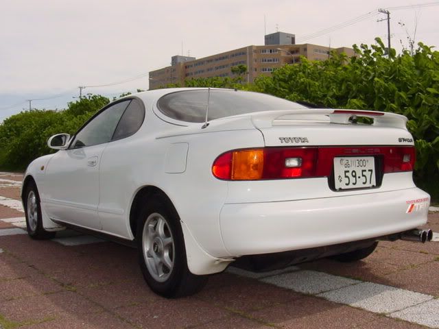

    Quote Originally Posted by PhillyDRFT

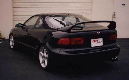

    It does exist, I will get a picture of it for you. It looks similar to a whale tail. I am not sure what trim levels it was available on, but I have seen it on a `92-`93 AT180.
    Great job! I am glad this is stickied. It should be.
    That would be cool to see.

    hmm I have a pic of what looks like a wangan wing on a GT-4 but i figured it's aftermarket. I'm going to revise the thread again sometime this week, I'll take everyones input into account.

    Took me a bit, but here is your one piece coupe spoiler.

    ^Mine isn't the same as that. Mine folds down at the end instead of looping toward the front. This is on a '90 ST
    I don't like people.
    I don't like going out.
    That is why my friends are all on the interwebz. That way when I don't feel like being sociable, I just close the window.
    I will try and dig out the part# for these tail lights, if they can be found anywhere without ripping too much apart...
    since this is my car anyway...
    I might have another seat color for you. Noticed a wrecked 5th gen with what looked like a JDM GT4 seat in the driver's side at Brickyard. Was a navy cloth.
    I'll try to get a pic of it.
    for the guy near the top, there was a dark blue. about a navy blue. i have it in my 91 GTS but its kinda falling apart since i live in arizona and its leather......

    this is a factory green color but im unsure of the name, it was rare though
    notice how the back spoiler curves down, the one u posted is a common aftermarket one
    edit....i have no idea why it wont show up as a pic instead of a link
