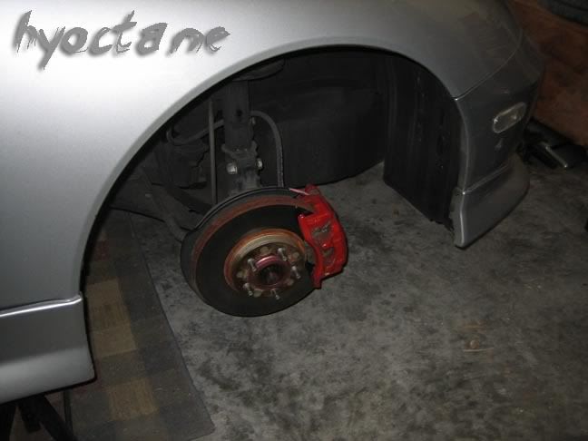

    Step 1. Pull your emergency brake, jack up your car, place it on jack stands, place wheel chocks at the rear wheels and remove your two front wheels.
    Note: This is the simple step. If you don’t know how to perform this step, please stop working on your car and take it to a knowledgeable / qualified mechanic or your local Toyota Dealership. Also, make sure your brakes and engine are cool to the touch to keep from burning yourself.

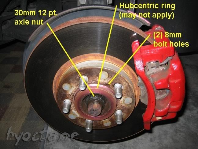

    Step 2. Locate the notch on the end of the axle and notice that the locking nut has been indented in this notch to lock it on the axle. Grab your punch or strong screwdriver and begin to hammer the indentation out of the nut so you can remove it.
    Note: This is the most frustrating part of the project. Plan on spending 15 minutes or more doing this. I used a combination of butane torch to soften the indentation in the nut and a punch to hammer it out. Be sure not to damage your axle or threads on your axle.
    Step 3a. Get your friend in your car, start it and hold the break pedal down. Turn the steering wheel so you can access the locking nut without damaging your wheel well. Use your 30mm or 1 3/16” 12 point deep well socket and a breaker bar and begin to loosen the nut.
    Note: I used some PT Blaster to help break it loose as it was extremely stubborn. With a little persuasion, this task won’t take too long. Just be sure that the indentation on the nut is completely hammered out of the notch in the axle.
    Step 3b. If installed, remove your hub centric rings. I have lightweight aluminum rings from my Rays wheels, some cars may have these installed some may not. I used a thin flat head screwdriver and a hammer to remove them.

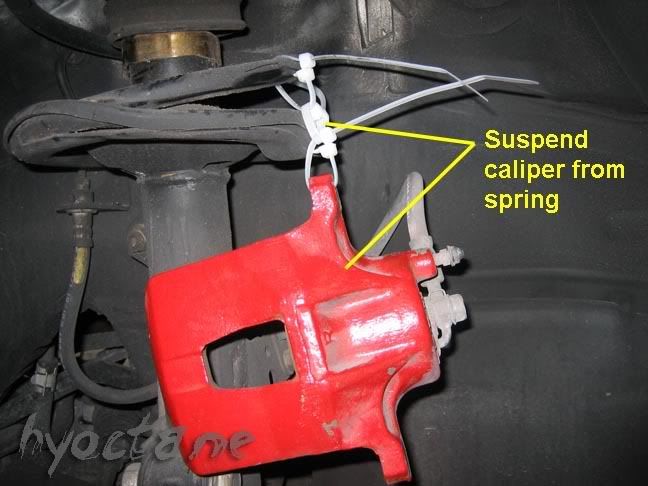

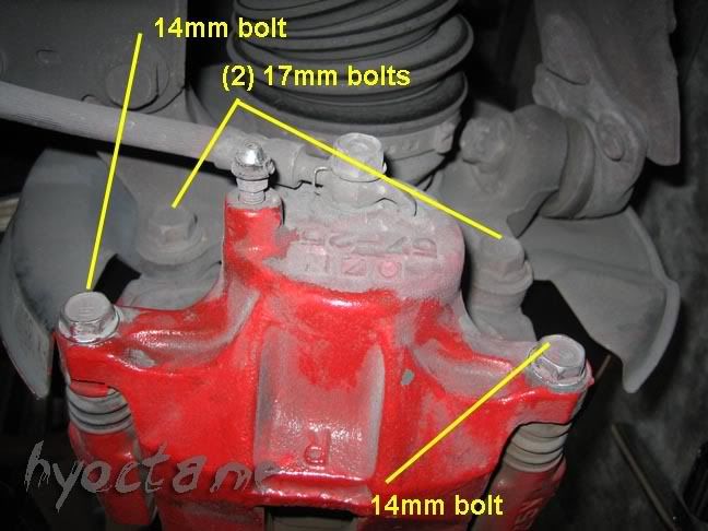

    Step 4. Remove the two 14mm bolts that hold the caliper on. This is just like changing your brake pads. Remove your caliper and suspend it from your spring with strong zip ties. This will ensure that you don’t damage your brake lines. Next, remove your brake pads, and the caliper bracket which is held on by two 17mm bolts.
    Step 5. Use your two 8mm bolts and locate the two bolt holes in your rotors near the wheel studs. Spray some PT blaster in the holes and begin to thread in the bolts. Keep turning them and eventually the rotor will pop off of the spindle. Be sure you have the right pitch on the 8mm bolt. I don’t remember the exact pitch, so verify w/ the bolts that you bought. Return the unused bolts.

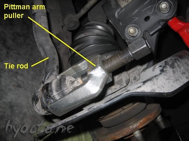

    Step 7. Locate your tie rod, which is located toward the firewall of your wheel well. Remove the cotter pin and take your 17mm socket and remove the nut from the stud. With the nut removed, use your Pittman arm puller and place over the stud. Make sure it securely grabs the steering knuckle and not the ball joint end of the tie rod. Give it a few twists with your ratchet and the tie rod will literally “pop” loose. Remove the Pittman arm puller and place the tie rod aside.
    Note: This is a simple step with the right tools. I was loaned this “Puller” set from a local Autozone for free, all that was required was a 100% refundable $89.00 deposit on the tools.

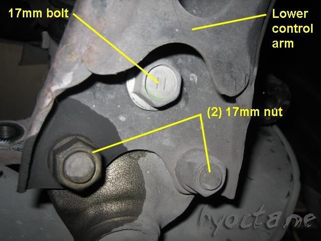

    Step 8a.Next, locate the two nuts and one bolt that hold the lower ball joint of the steering knuckle to the lower control arm and remove them with a 17mm socket and breaker bar. Remove the two nuts before you remove the final bolt.
    Note: I used some PB Blaster on the nuts and bolt here. This was another extremely difficult task, as they are torqued with over 100 ft/lbs. Be sure to use your breaker bar and to hold the socket over the bolt with your hand, or you may end up stripping the head of the bolt due to the angle of the control arm. Also, break all of the nuts and bolts lose before completely removing them. Remove the two nuts first, and then the bolt.

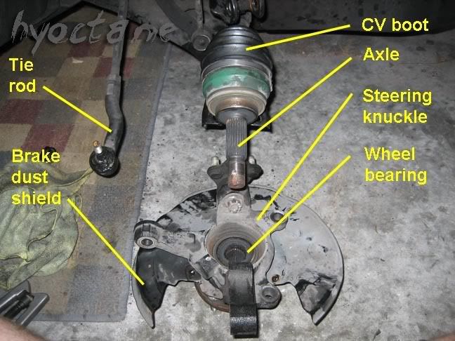

    Step 9a. With all bolts holding the steering knuckle on removed, grab the top of the knuckle with your hand (where it was attached to the shock) and hold it firmly. Grab a hammer and begin to tap the axle out from the spindle.
    Note: Do not pull the knuckle / spindle away from the axle, as you may damage your axle or drive train. Also be sure you don’t damage the threads on the axle when striking it with a hammer. This will take many repetitious light blows, and may take a while. Be patient as you don’t want to hit a wheel stud or bend the threads.
    Step 9b. With the steering knuckle / spindle assembly removed, inspect the CV boot for any wear or damage. Now is the time for this as you can readily examine the boot without hindrance. Replace as necessary (this walkthrough does not cover CV joint or CV boot replacement. Please consult a qualified mechanic for this job.)
    Step 10. Remove the dust shield. There are three 10mm nuts that need to be removed. Take note that the dust shield will freely spin around the spindle with the bolts removed and will only completely be out of the picture when the spindle is removed.

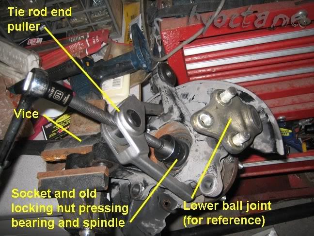

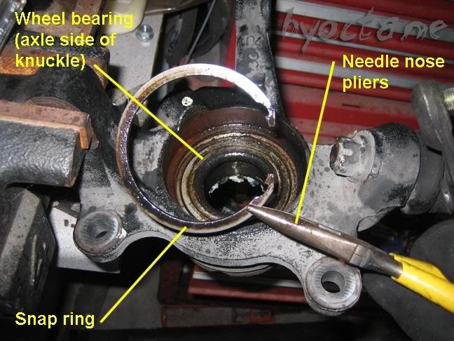

    Step 11. With the steering knuckle / assembly removed, securely place in a vice. Grab your old locking nut and socket, and place over the INSIDE of the wheel bearing. Make sure you place it exactly center in the bearing as you are going to press the outer race and spindle out. Attach your tie rod end puller to the knuckle and begin to tighten the socket / nut into the bearing. After a few turns the spindle with separate from the bearing with the outer race attached. The dust shield will now be able to be removed from the assembly. Using needle nose pliers, remove the snap ring holding the bearing in place.
    This is the final step of the walkthrough. You must now take your spindle with the outer race of the bearing and your steering knuckle w/ the remainder of the bearing to a qualified machine shop to have the race removed from the spindle and the old bearing pressed from the knuckle. They also need to press in the new bearing and spindle with the dust shield in place. This was only $45 at a local machine shop and $100 at Toyota, however, your price may vary.
